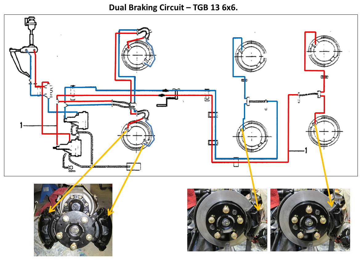

Even with the weight of the 6x6 I am surprised it needs to use twin calipers on the front - given the 6x6 performance a good single caliper should have been good enough. Nevertheless seems like a quality conversion.

Re: Disc brake conversion!
The Volvo 6x6 has a twin servo brake system which supports twin front calipers without having to "re-plumb" the brakes. The brake balance calculations also suggest twin calipers are appropriate for front to rear braking bias. The system balance then also allows for common calipers throughout.
The Pinzgauer manages this the same way.
Below hopefully helps - top is the Volvo 6x6 brake system, bottom is the Pinzgauer caliper set-up.
Hi guys, this is Martin..
to end speculations: roobar* is exactly right. The overall layout is a complete Pinzgauer 716/718 copy, while retaining the (much better) circuit layout of the Volvo.
We use, just lik the Pinzgauer, identical (ok almost, there is a slight left/right difference due to differential piston setup) calipers all around to have the best spareparts availibility in case of failure: Just steal one from the rear and put it in front. With that approcach you can go anywhere. Same with the discs. Front almost worn? Put it in the rear and it will last a lifetime. Something like that.
As for overall dimensioning: Yes a single caliper could have done the job aswell. But which caliper with a single piston equivalent of almost 80mm do you know? Right... none. So we would have to use some special 6 or 8 piston caliper or some dual whatever floating type and have several problems: Wat to do with the dual front cirtcuit? What about or nice idea of identical parts? And so on. We use differential piston setup for even brake pad wear. So a caliper contains 2x38.6mm and 2x41.2mm pistons, resulting in an equivalent of a single ~80mm piston. For comparision: Pinzgauer would be at around 76mm. Not that far away. We use biggeer, vented discs and need to compensate for much larger wheels, that's the reason for a little more volume in the calipers.
