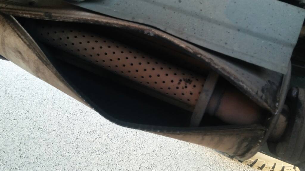

I let it sit overnight and changed the fuel filter, has fuel pressure on pump to carb side, checked all connections for the SSi , test voltage from ignition switch and everything looks good so I fire it up. Sync the carbs( were not far off) and take off. It warms up, runs super smooth as always when warm, then after 5-8 miles, looses power, backfires then dies. Repeat the same process except this time the muffler rips open on one backfire and attempt to start.
It runs great until Sunday and when cold, runs great, smooth, idles well, pulls throttle well in all gears but then after warm and several miles, acts like its running out of fuel. It has a Andre Stainless tank, clean lines and filter, good pressure, all lines tight and no leaks, sync'd carbs. It back fires when the problem happens, so im assuming fuel is getting into the carbs and ultimately the muffler because it now sounds like a dragster and the muffler looks like an open face taco.

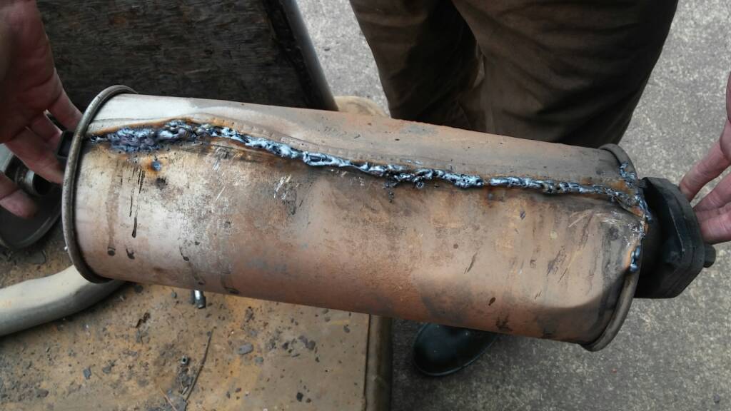

I beat the muffler closed and goober welded the seam, have to say I almost left it as it sounds fine just looks like crap. I didn't want to test drive with an open muffler, tune etc. Test drove over to the muffler shop to dumpster dive some "new old stock" mufflers and it ran well, no backfire and dying. 10 minutes in to the metal scrap pile, I found a 6" x17" round 2 inch in and 1 out with a hanger tab for what looks like an older Mercedes sedan? Looks like it will work. I'll get it welded up and a further test drive.

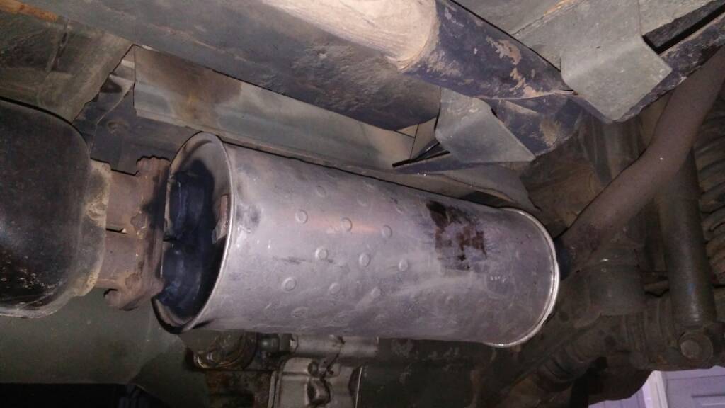

You have do what you have to sometimes! Thin metal, wind blowing and not having the tire off I am surprised it looked this good!
