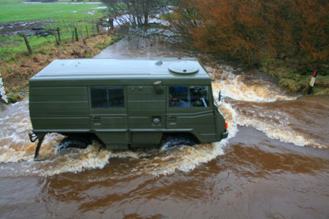

Most of the time on gravel roads with mud and puddles I would have just kept the Pinz in high-range as that 1st gear is really low. When really off-roading in demanding conditions low-range is superb as it still allows reasonable speed in 4th and 5th yet gives you the power torque and low speed control needed for difficult obstacles. In water you rarely want to stop so pre-selecting the right gear becomes more important. Make sure you are in 4x4 and perhaps engage the rear diff-lock especially if the route is straight through. I used to leave the front diff-lock for getting me out of trouble (not into it)

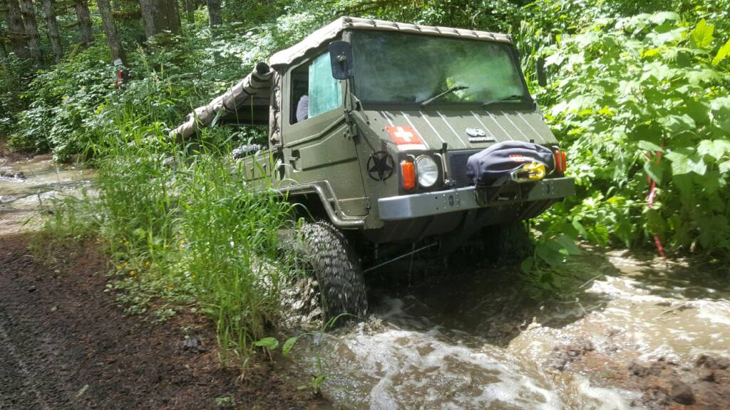

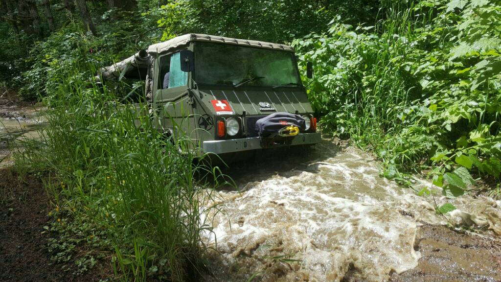

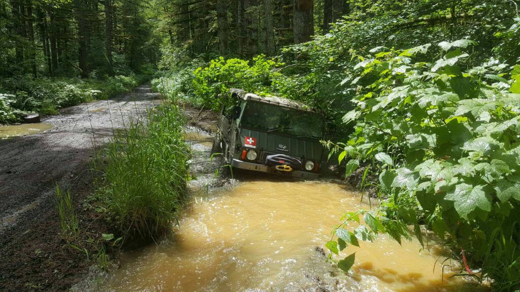

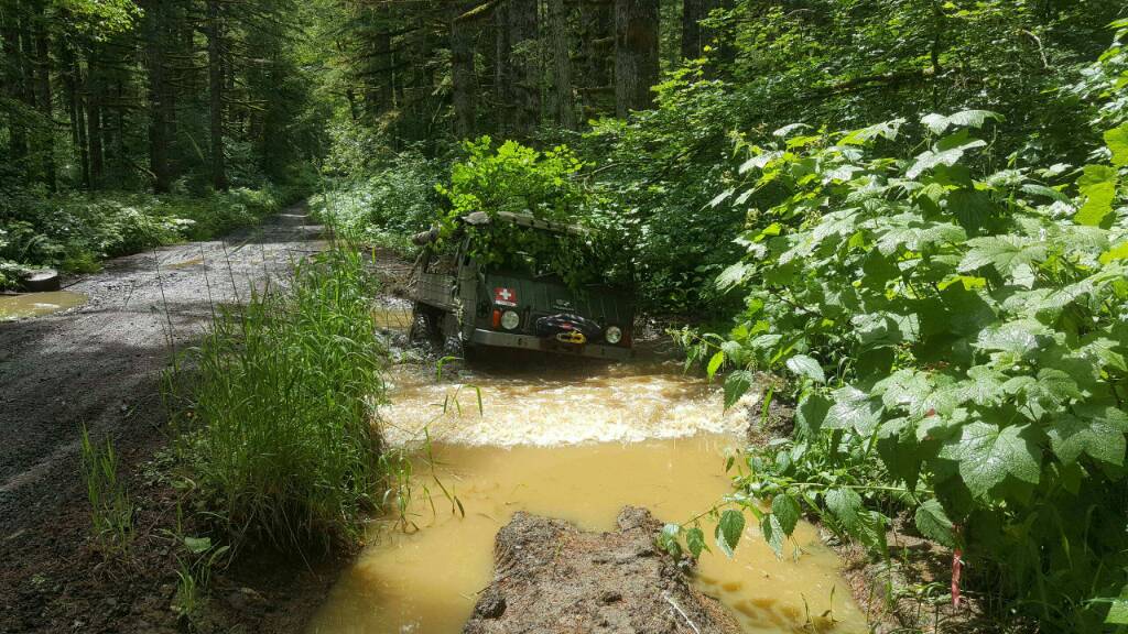

Re: a technique question.......
Wow that looks like a lot of fast moving water - very dangerous even in a Pinz!
ScottishPinz
Posts: 407
Location: Edinburgh, Scotland
Post by ScottishPinz »

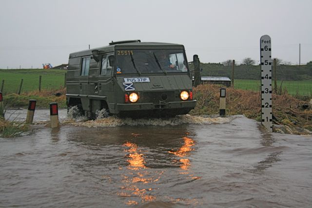

That was a ford on a tarmac road
Post by Pinzcat »
Great ford and great photo! By luck is the pinz high on his wheels!

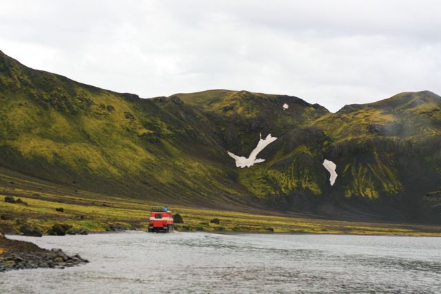

One problem we found in Iceland was that prolonged water crossings soaked the hub brakes making them ineffective, constant left foor braking eventually dried them out but often not before either a steep descent or the next water crossing!
This track was basically the shallow edge of the lake (Iceland 2008)

ScottishPinz wrote:One problem we found in Iceland was that prolonged water crossings soaked the hub brakes making them ineffective, constant left foor braking eventually dried them out but often not before either a steep descent or the next water crossing!
Sure does, and you want to hope the water doesn't have a steep exit slope that you fail to get up. If they are ineffective going forwards, they are non existent at stopping you rolling backwards :shock:
Luckily, the handbrake is spot on.
