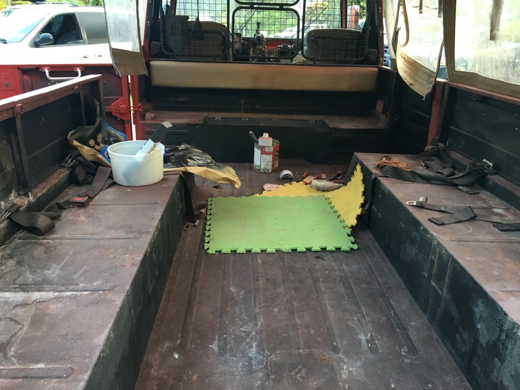

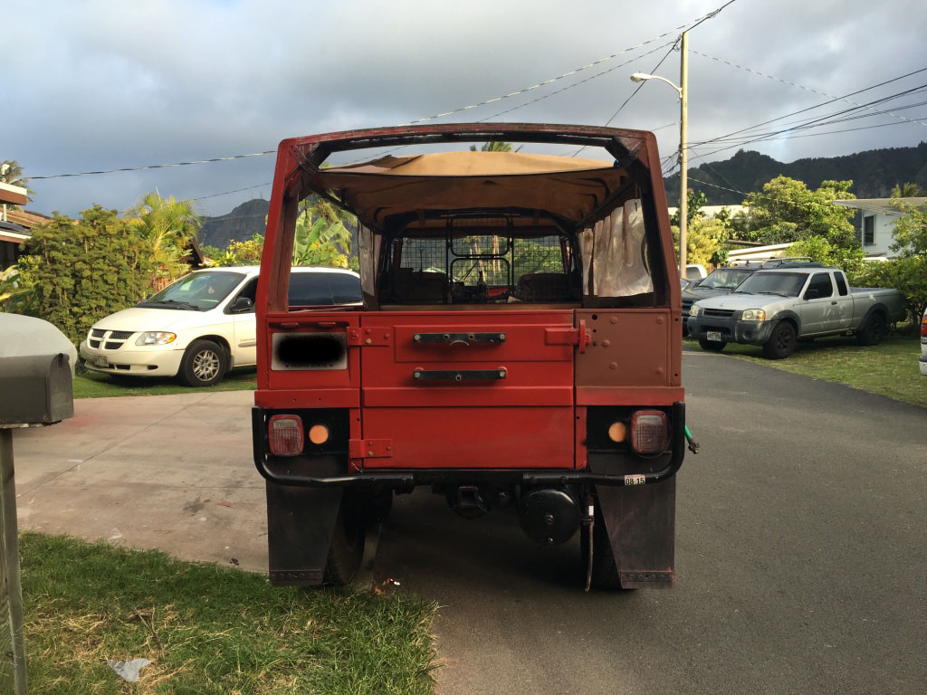

My opinion is to be extra skeptical about anything having to do with this Pinz. The state of the truck and the tastes of the previous owners are really questionable and I've found this is a good indicator (in general) of hidden problems. From the hanging wires, the awful top, the rust and the worst choice of tires I've ever seen on a Pinz, I bet this will need extra work. And what is that air-tank looking thing hanging down like some old hemorrhoid under the rear end?
The $19.95 tail lights and the jerrycan hanging down low enough to get smashed off-road doesn't help the impression either.

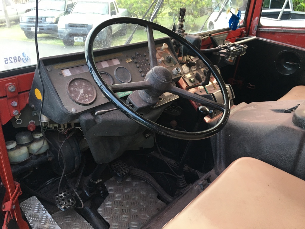

I noticed the interior has that "exposed" look to it as well. You see that on 4x4's that were left outside with the top off. It looks like it's been rained on and sun-baked. Could just be body shop dust and dirt but I bet not.
The area around those mid-doors needs to be inspected very carefully, and with a screwdriver or ice-pick. If rust was eating the "joint", you may have a real mess on your hands. If someone didn't cut every piece of rust out and properly weld in all new steel, you'd be screwed. If the seats were rusted that badly, it makes me wonder how much that spread. Rust isn't likely to just sit in one spot; it spreads like a virus.
Oh and Bondo is not a repair product. It's only useful for smoothing small imperfections in metal bodywork to make paint look good.
My feeling is that you should stay away from this thing. It may actually be best for parts. I could be completely wrong but that's my gut feeling.

I'd be VERY leery of that project. The true "K" platform has added reinforcement to structurally retain the integrity of the platform. If they were shoddy on adding the footwells and door frames, I doubt they added the reinforcement.
Read this thread on Prof Pinz's conversion of a 718M to a 718K. Especially notice the attention to details.
viewtopic.php?f=8&t=8355
Without more details on this truck, my first impression is that the mid section will buckle and twist the 1st time offroad. Pinz's central tubes twist normally , and I can envision this one taking the body with it.
If you want a 712M, buy one. This has to be real cheap before I'd even think about it.

the Pinz discussed above is one of the few civilian vehicles delivered for fire brigade services. Usually they were built upon a 712K chassis, and got equipped with roll up sections in the rear.
The vehicle in Hawaii , I guess has been stripped down alongside the seams between the panels, but I doubt tha the chassis is a "Frankenstein" of 712M and K parts.
let me add my 5 cents of semi-wisdom:

It's ex-swiss and I doubt it could be a fire truck in any case. Also notice the tranny cover area has been modified a lot. Dash, etc. is all mil. Swiss.

I would agree with this. The "bleifrei/unleaded" green sticker next to the steering wheel was added by the Swiss military. Also, firefighters (usually) don't need rifle holders... unless it was an air base fire-fighting vehicle, but I doubt it.VinceAtReal4x4s wrote:It's ex-swiss and I doubt it could be a fire truck in any case. Also notice the tranny cover area has been modified a lot. Dash, etc. is all mil. Swiss.

This vehicle's body work, rust removal and paint job is being done outside, about a block from the beach. The rust was removed and the metal was repaired with bondo. I don't know if the body man used welded sheet-metal to bridge the gaps in the through-and-through rusted areas. I know it has been painted with primer. I know that the interior of the vehicle's back cabin will be coated with Rhino liner.
My concern is that if the rust is not completely removed then potentially tiny, even unseen amounts of rust could be trapped under the paint and rhino liner. I would think that even a tiny amount of rust in the exposed outside environment (a block from the beach) could easily have water and salt from the air entrapped alongside it as it is being coated with paint or rhino liner. Wouldn't this pose a problem in the future with rust coming back?
I have no experience with doing body work. This is just my lay person's observation. It would seem that body work of this nature should be done inside, within a air conditioned (low humidity/low salt) environment.
Is this a real problem that I have just proposed? I really like the potential of this Pinz but I hate the idea of having a chore to do regarding maintenance every few months.
Re: need help pricing a 712M
Fortunately , or unfortunately, you have answered your own question.
Body work being done outside by the beach, rust repaired with bondo, covered by bedliner. These are all red flags that translate to " run, pass, move away from"
Buy a known good one, import it to the Island and be money ahead in the long run
