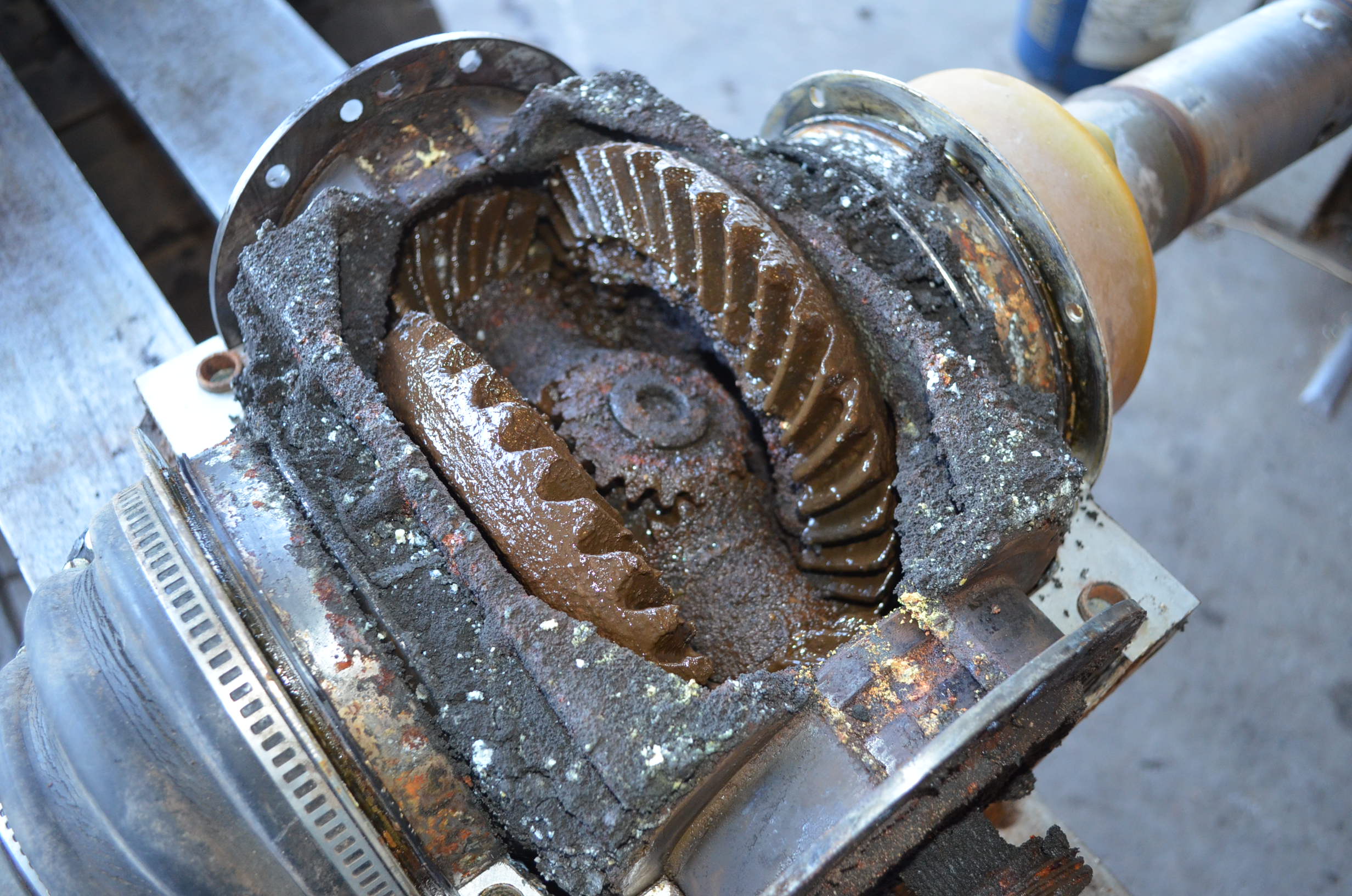

Take 10-15 minutes and peak under your truck. Check your shock bolts, limit straps, shifter linkages, axle boots, etc, etc. People have fallen prey to the cheap or old boots. They help keep the dirt off the diff wipe seals and out of the differential. Better to fix a small problem before it becomes a big leaky problem. This particular truck is an extreme example of submarine commander and lack of maintenance. Pinzgauers are not too difficult to keep running so if you drive them maintain them. We don't like scrapping Pinzgauers.
