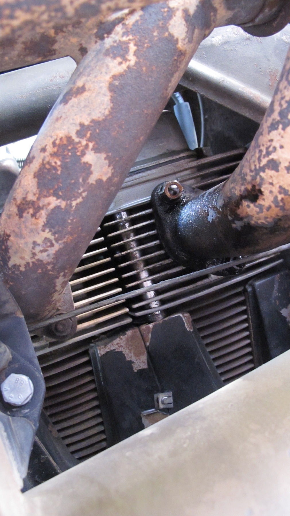

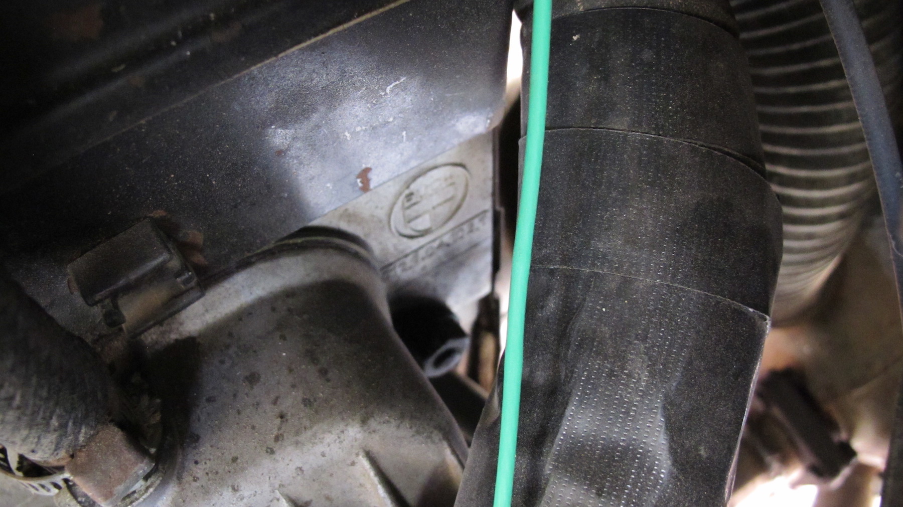

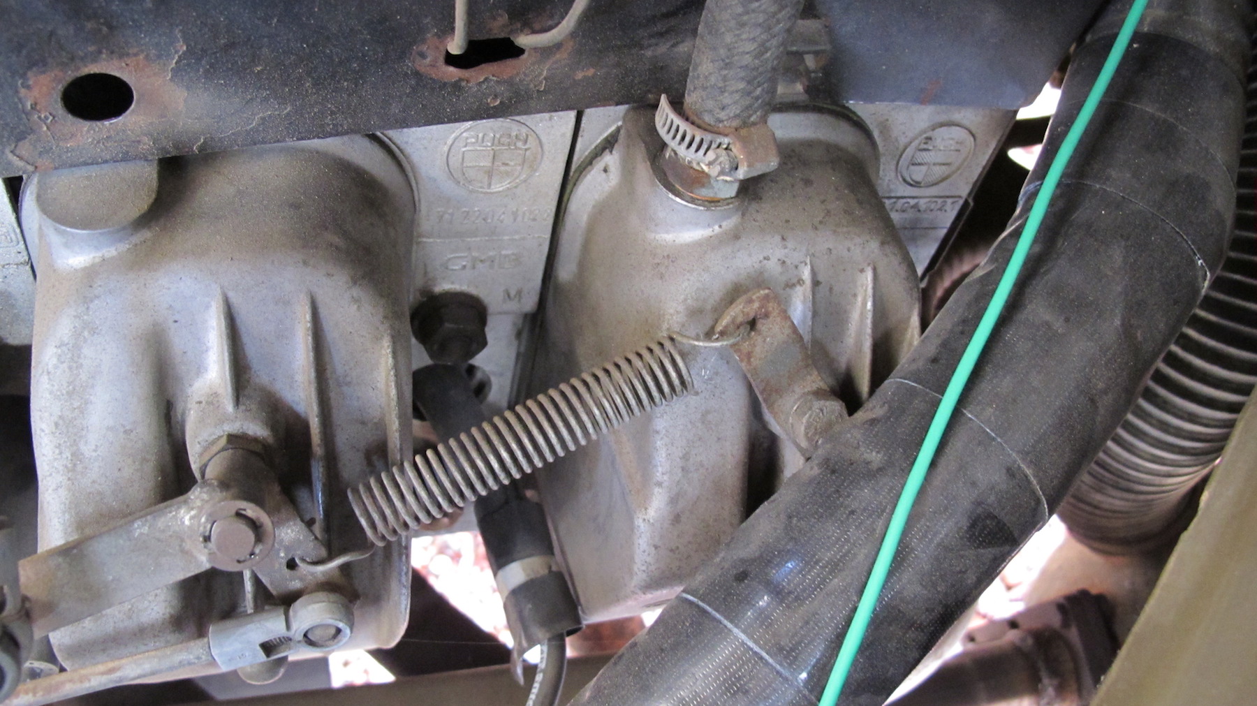

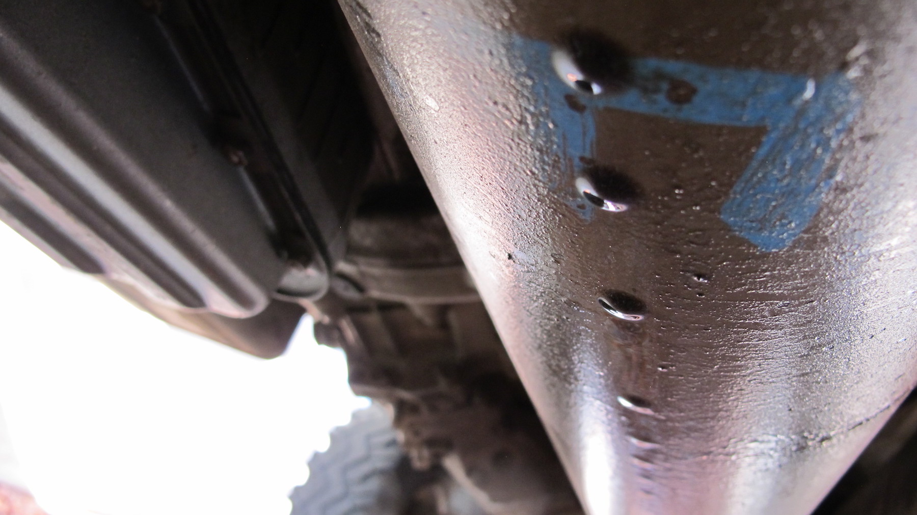

Our new to us 1971 710M has an engine oil leak on the bottom of the rear cylinder. It's clean up top on the valve cover. Any idea what's going on here?
Above on the valve cover is clean

Clean up top.
Clean up top.

Oil on the drive train tube below

Oil around the exhaust, on the head fins

Did you take the valve cover off? You may need a new gasket. Pretty simple fix, just make sure you don't put it on upside down.
Just for piece of mind as I think you're a new owner - this is minor.

audiocontr wrote:Did you take the valve cover off? You may need a new gasket. Pretty simple fix, just make sure you don't put it on upside down.
Thank you very much! I feel better knowing that as you can imagine.
We haven't touched anything. You're saying a new valve cover gasket? I can see fresh oil at the bottom of the gasket.

I'll order a new gasket, I imagine SAV has them.
From past experience with other old vehicles, trying to stop a leak by tightening the cover usually just makes the leak worse. Since I haven't touched it, do you think I should see if it will snug up a little?

+1 on the gasket. If you rub your finger under the valve cover you should be able to come up with some oil.

stiffler4444 wrote:+1 on the gasket. If you rub your finger under the valve cover you should be able to come up with some oil.
Yes, I can see it.

Never hurts to give it a tightening. Odds are you should replace it (all 4 actually). No need to drain oil, but know that some will leak out once the cover is removed. I use 10w30 but I'm in Canada.

Tighten the nut a little. Wont hurt

Don`t tighten the nut ... the cilinderheadcover will break ... it is specified to 15 Nm which is 10.8 lbf ft (which is what you use?)
The seals are sucked in quite often, when the cork gets older ... it can be prevented by glueing the seal to the cap by a temperature resistant liquid sealant (we here in Europe use Curil T, I am sure there is something similar in the US!)http://www.elring.de/fileadmin/Dateiabl ... _EN_01.pdf

I did tighten the nut just a hair, it was tight. New gaskets ordered from SAV. Thanks for the tip on the sealant. In my old days we used a Permatex High Tack, maybe good to use?
