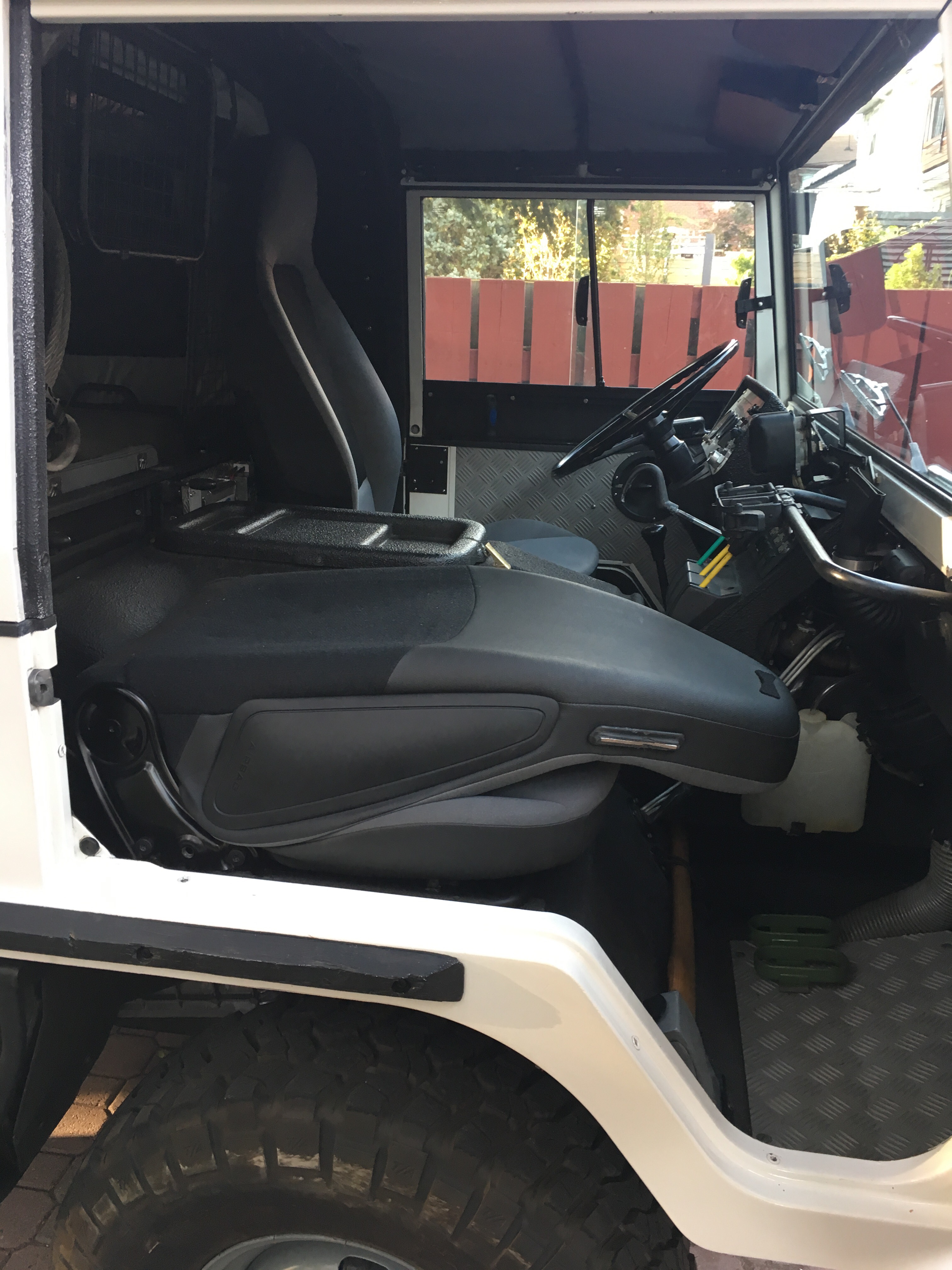

We picked up some Smart Car seats for the triple seating up front. These seem to be one of the best replacement seats out there, especially since they will fold completely flat, so the center seat can double as an arm rest when not in use. For anyone interested in Smart seats, be sure to check out http://www.autobahnsmart.com/ as we partner up with them on EV dismantling projects. Tell them the guys at EV West sent you and they'll take good care of you.

Smart seats are a smart idea ;)
You will need to remove or cut off the passenger side upper seatbelt guide.
The fold flat feature is great on the passenger side (just clears the upper gun rack)
Not sure your centre will fold flat, it may interfere with the locker levers

by audiocontr
I do like those seats. Wonder how much to ship to Detroit...
Re: Electric 1972 Pinzgauer 710M Build Thread
Posted: Sun Dec 11, 2016 7:39 pm
audiocontr wrote:I do like those seats. Wonder how much to ship to Detroit...
They are very comfortable and fit well
I bought 2 sets from a smart forum one set $60 and the other was $50
I think shipping from northeast US down to Tx was well under $100 for each set
Second set was sold to a Mog guy
Be sure to remove the side air bags!!

TechMOGogy, we somehow ended up with 3 passenger seats. We'll pick up the driver's side, and will likely use the belt hoops attached to the seats.
