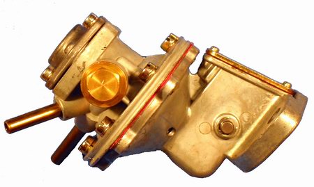

First, here is the SAV OEM replacement:
SAV OEM fuel pump
SAV OEM fuel pump
sav oem fuel pump.jpg (23.97 KiB) Viewed 12340 times

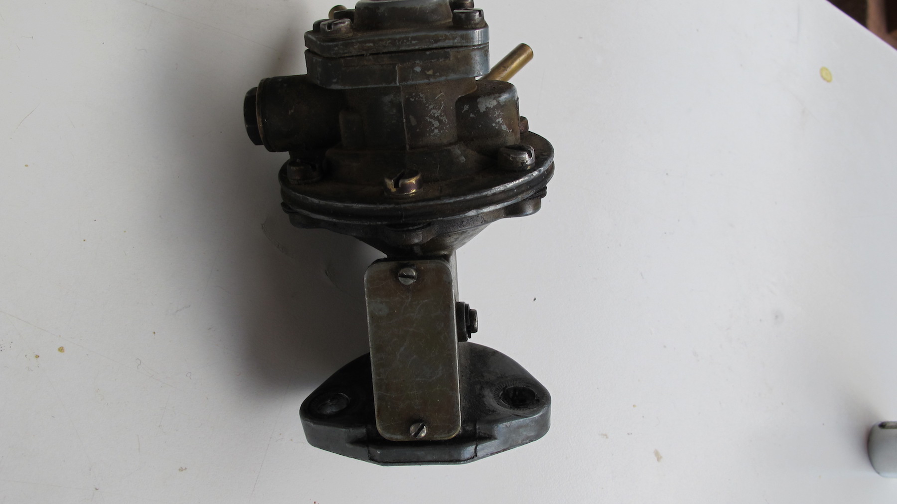

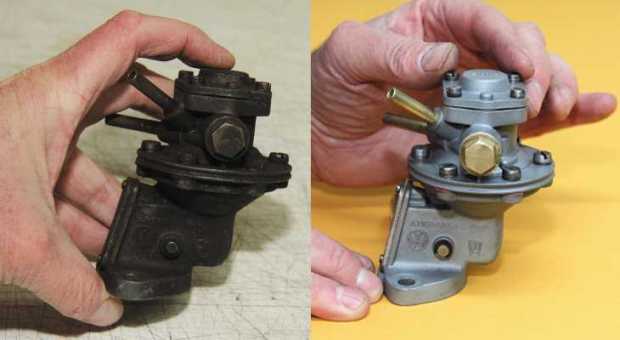

And here is the late 60's - 70's VW pump that looks the same as Pinz OEM except the top section is rotated 180 degrees.
VW OEM fuel pump
VW OEM fuel pump
vw oem fuel pump.jpg (18.68 KiB) Viewed 12340 times

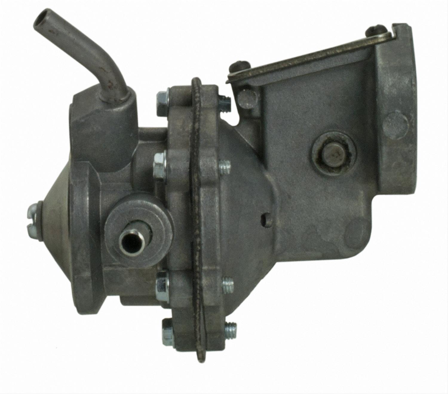

Here is the Carter M60175 that is probably the same pump that NAPA branded as s their's but no longer do. Available from Summit Racing:
Carter M60175 fuel pump
summit racing carter CRT-M60175_UH_xl.jpg (129.19 KiB) Viewed 12340 times

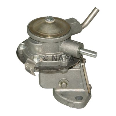

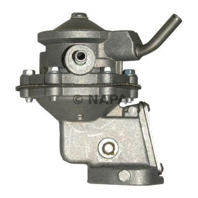

NAPA lists 2 pumps when I searched M60175 that appear to be Airtex 1071 and 1072. They appear to be the same except the top fuel line orientation.
NAPA Airtex 1071 fuel pump
napa afp 1071.jpg (14.9 KiB) Viewed 12340 times
NAPA Airtex 1072 fuel pump
napa afp 1072.jpg (18.84 KiB) Viewed 12340 times

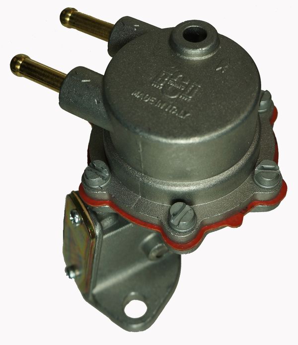

There also is the SAV euro replacement pump, with the parallel nozzles. Can't add another picture to this post, I'll do it on another post.

Here's the SAV Euro replacement pump, parallel nozzles:
sav pinz euro fuel pump.jpg (55.41 KiB) Viewed 12338 times

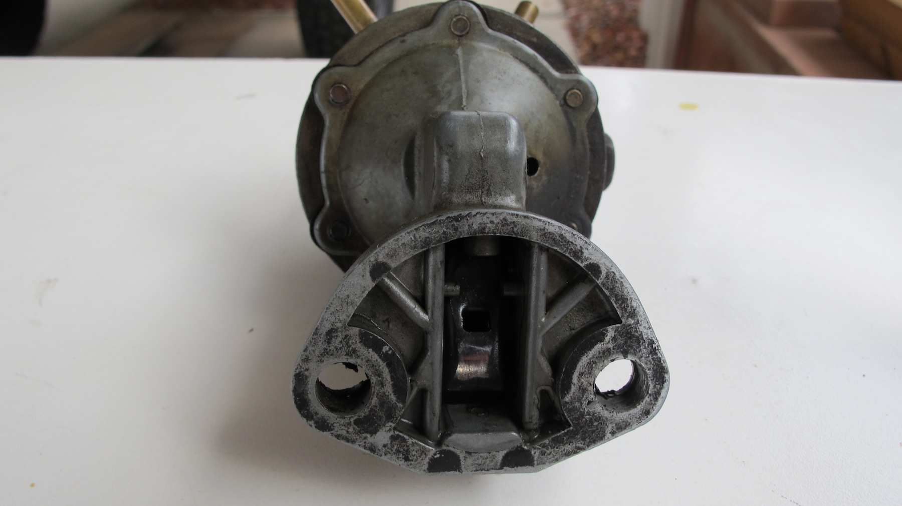

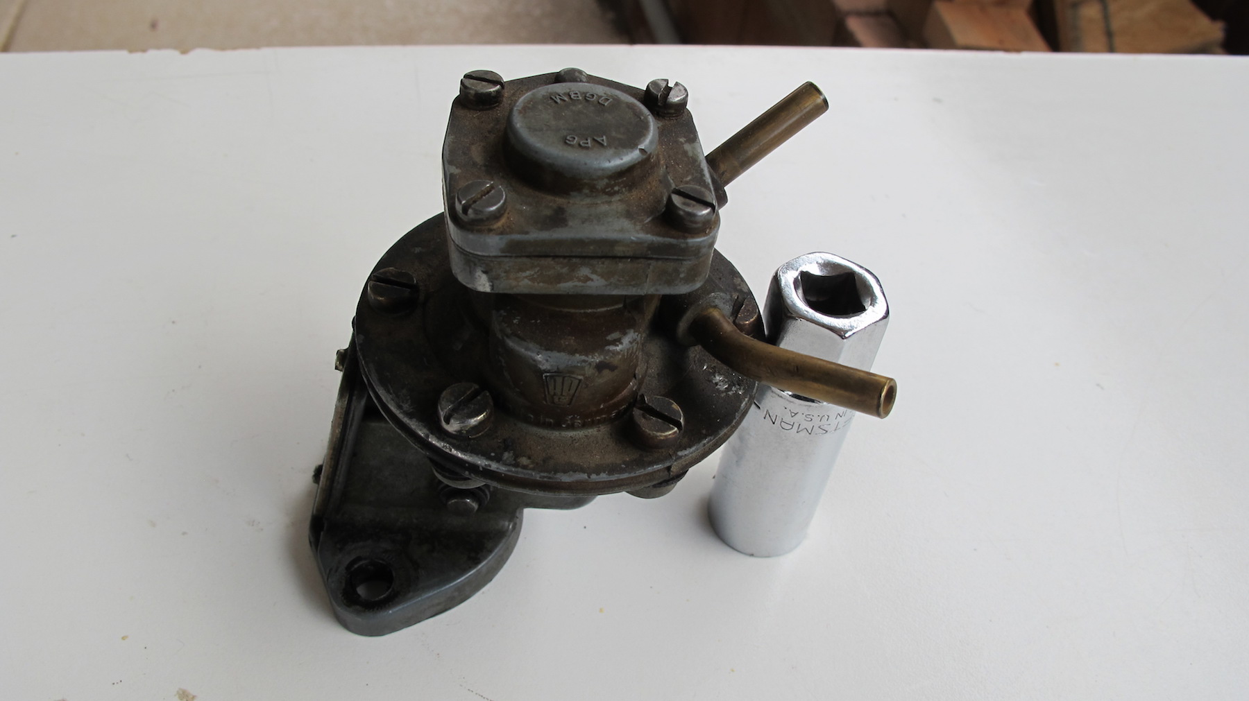

I didn't realize I had this option, but in the NAPA M60175 box the previous owner gave me is the OEM fuel pump. The bottom tappet surface is shiny but doesn't look worn bad. So an option is to get a rebuild kit and gaskets to rebuild this one.
This is likely a very old pump and the prior owner replaced it with the NAPA pump 7 years ago.
Is there anything i need to be concerned about other than just a rebuild kit? Worn parts - how do I check? Any other parts I should get along with the kit to be sure it will be good?

Re: Fuel Pump Options
Posted: Thu Jan 05, 2017 1:51 pm
by pcolette
While the rebuild kit is still available it has become so expensive in the last few years that rebuilding is really not worth it. The kit is $132.00 and a new pump is $147.00. Also there are a couple of parts in the pump that can wear or fail and are not included in the kit.
I didn't mean to suggest rebuilding in my previous post, just that I felt the original pump was a great piece of engineering compared to some of the aftermarket products.
Posted: Thu Jan 05, 2017 7:32 pm
by audiocontr
Flip the diaphragm over and reassemble. Might save the need for a new one.
