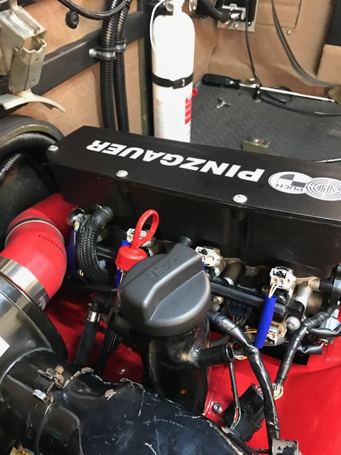

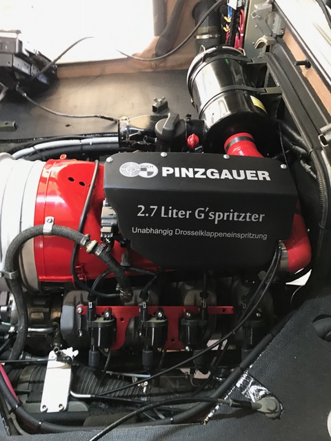

I've finished designing and building an independent throttle body injection and sequential ignition system. So far it's working great. I just have to finish tuning and get dyno results. More details to follow.

Very nice! Curious how you adapted to the head intake ports, are you using the intake riser "pants"?
Hard to see in the PIX :? What injectors did you decide on? Are they EV6 or even later, what Lbs
and spray pattern, would be interesting too know.

That's under-doghouse porn at its best, thanks for sharing! The red covers are a nice touch.
Would be interested to know if you ever consider to come up with a kit, too.

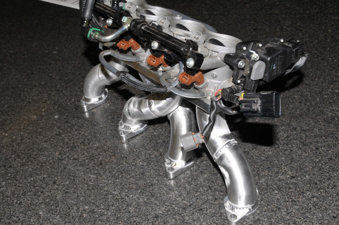

rmel,
I designed and fabricated a custom intake manifold with cylinders 2 and 3 crossed over to match the runners lengths of 1 and 4.

Eyeball engineering is qualitative, that said this manifold looks technically very good!
Balanced flow etc, separate throttle body/port . Looks like at least EV6 injectors -- good.
What flow rate did you settle on e.g. Lbs @ 3 Bar? Curious about the spray patter you
picked, e.g. "shot gun" 20 to 30 degrees or "laser beam" 10 degrees.
Damn cool! I bet your not going to be pumping these out in volume :wink:
Hey! When do we see the turbo-charger prototype, at least 2 bars -- no :P
