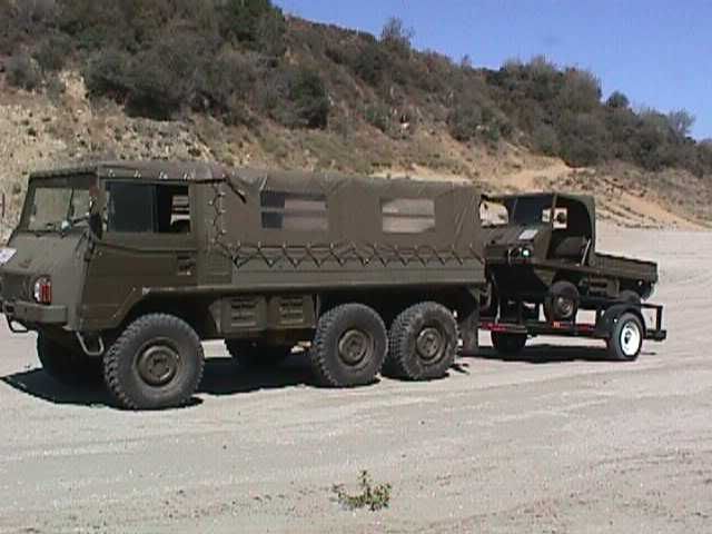

Long, long ago in my far away my Gas Pinz days (
) , I used to towed my Haffy 18 miles into the mountain with my 712M.
A 710 shouldn't be bothered at all, I'd be concerned more if it was heavier without trailer brakes and have to rely on the drum brakes to stop quickly or on a downhill.
I'm looking for a trailer with surge brakes so that I can trailer the Supacat to British car shows with GG. THAT will be pushing the tow limits!
