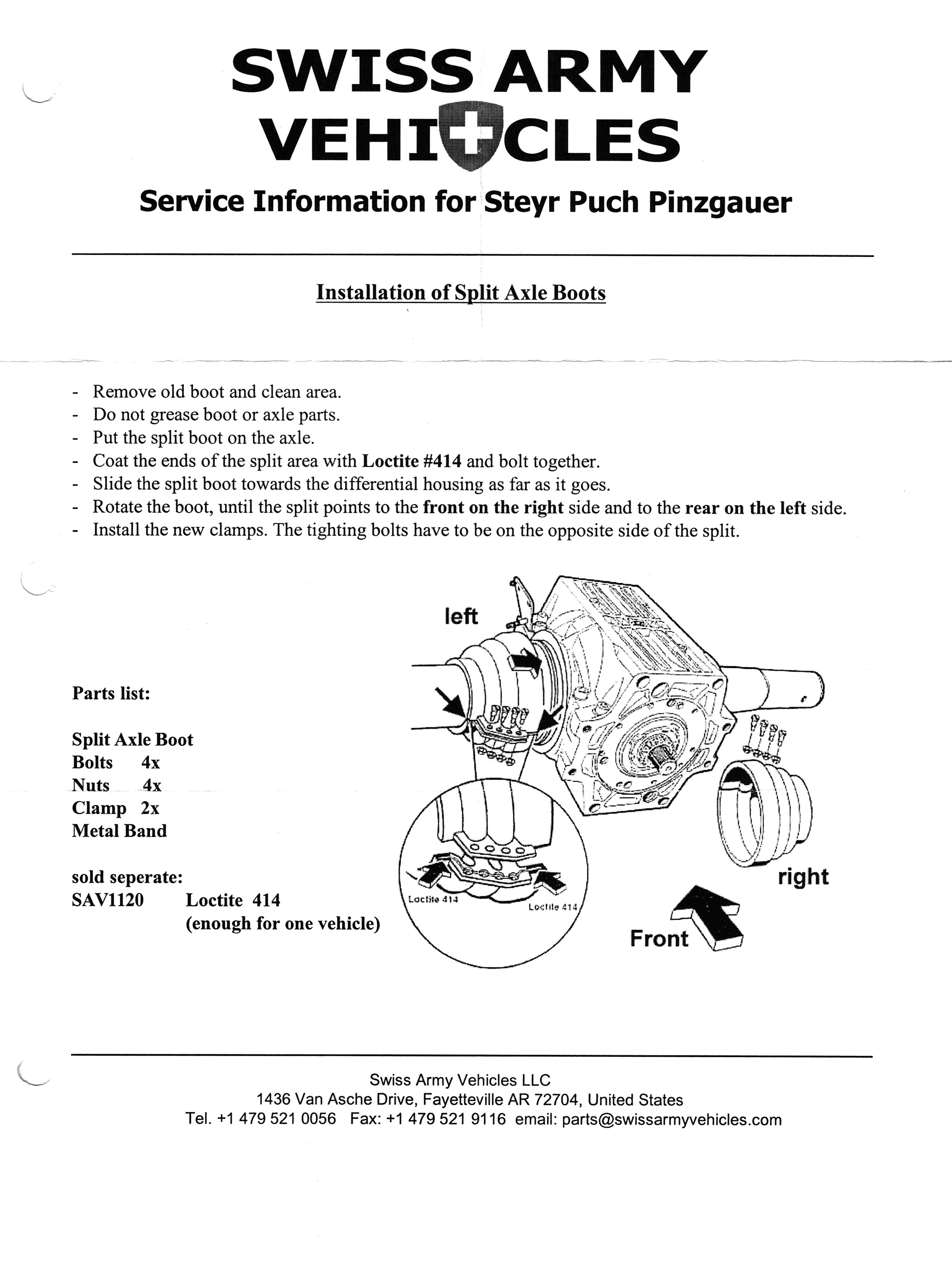

So guys thanks for the responses I really appreciate that .also do the boots go a specific way I did not know that.the part where the bolts go does that go horizontal or vertical
Posts: 1643
Re: How to install split boots
Here are the instructions as provided by Swiss Army Vehicles:
SAV Split Boot Installation.jpeg (780.77 KiB) Viewed 6010 times
In the final line of the directions they are referring to the tightening bolt on the clamp. It needs to be 180 degrees from the seam on the boot.
