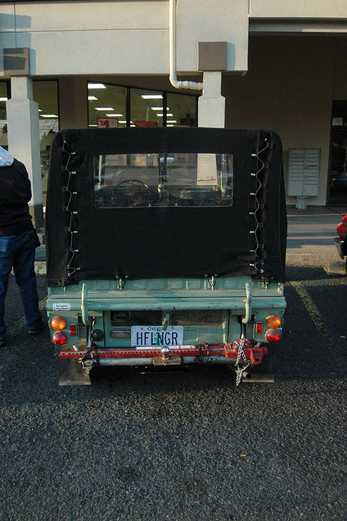

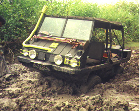

Some examples of mounts in case your thinking about that too?
many other spots to mount too like inside the bed, etc
Interweb photos
Interweb photos
- 3-19-2012 3-01-53 PM.jpg (73.72 KiB) Viewed 15266 times
- 3-19-2012 2-27-39 PM.jpg (107.91 KiB) Viewed 15266 times
