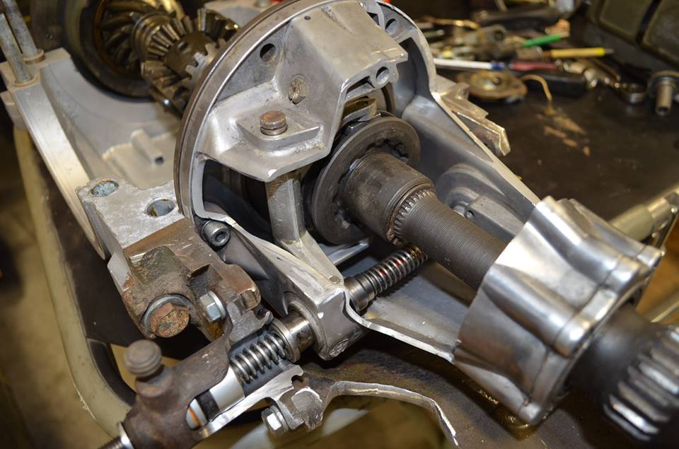

Here is a differential semi-cut-away. There are seals all over the place. Witches hat to the differential housing, locker/4x4 switch, locker/4x4 switch housing, shaft seal, two O-rings on the locker spring piston/assembly and an O-ring at the top of the shaft for the locker/4x4 fork. On top of that there is a vent hole on the top of the witches hat. I think that is most of it.
