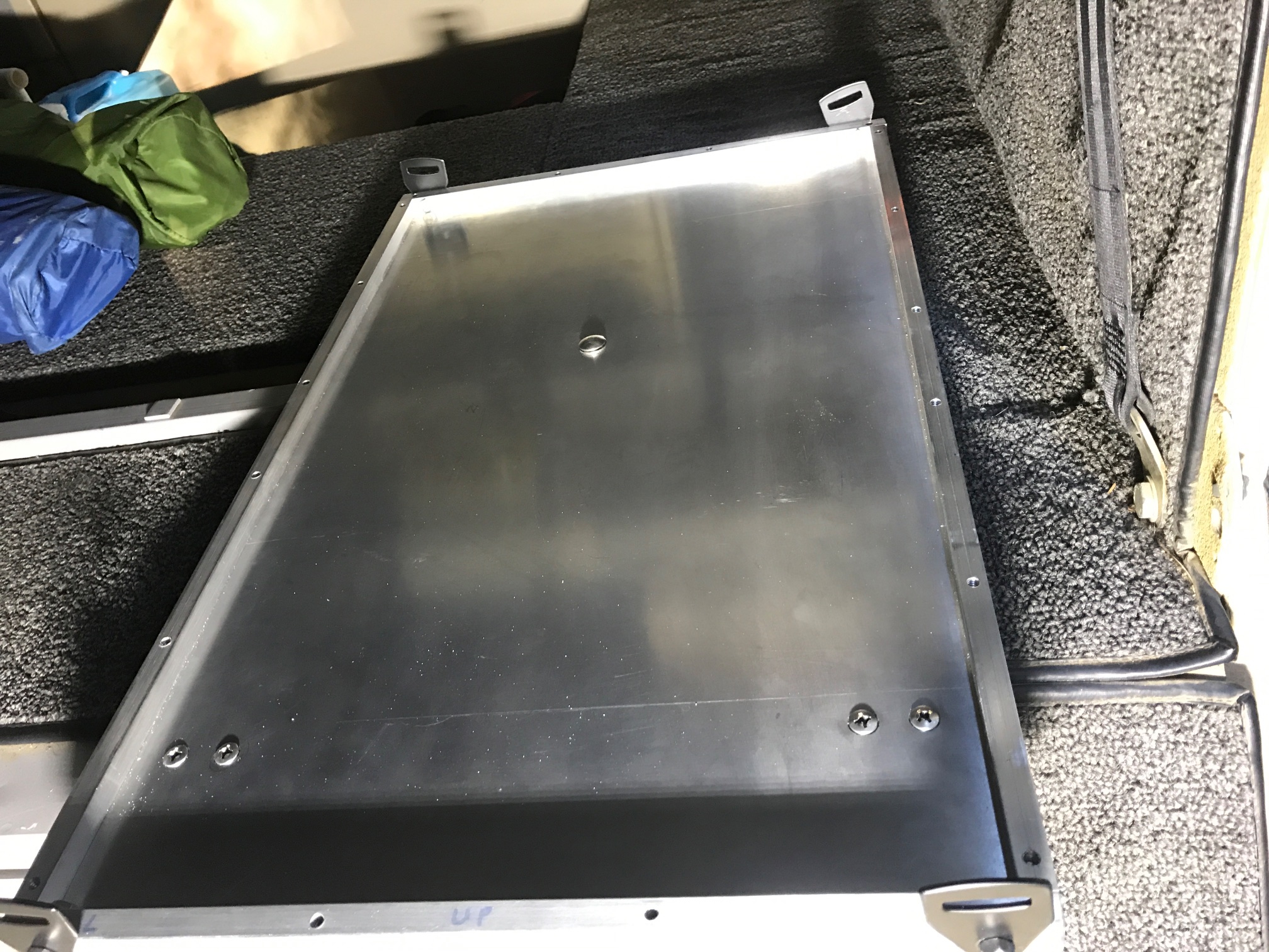

I am not set up with proper TIG welding so everything was drilled, tapped, and bolted. Nonetheless,
it's very sturdy with the ARB tie down straps.

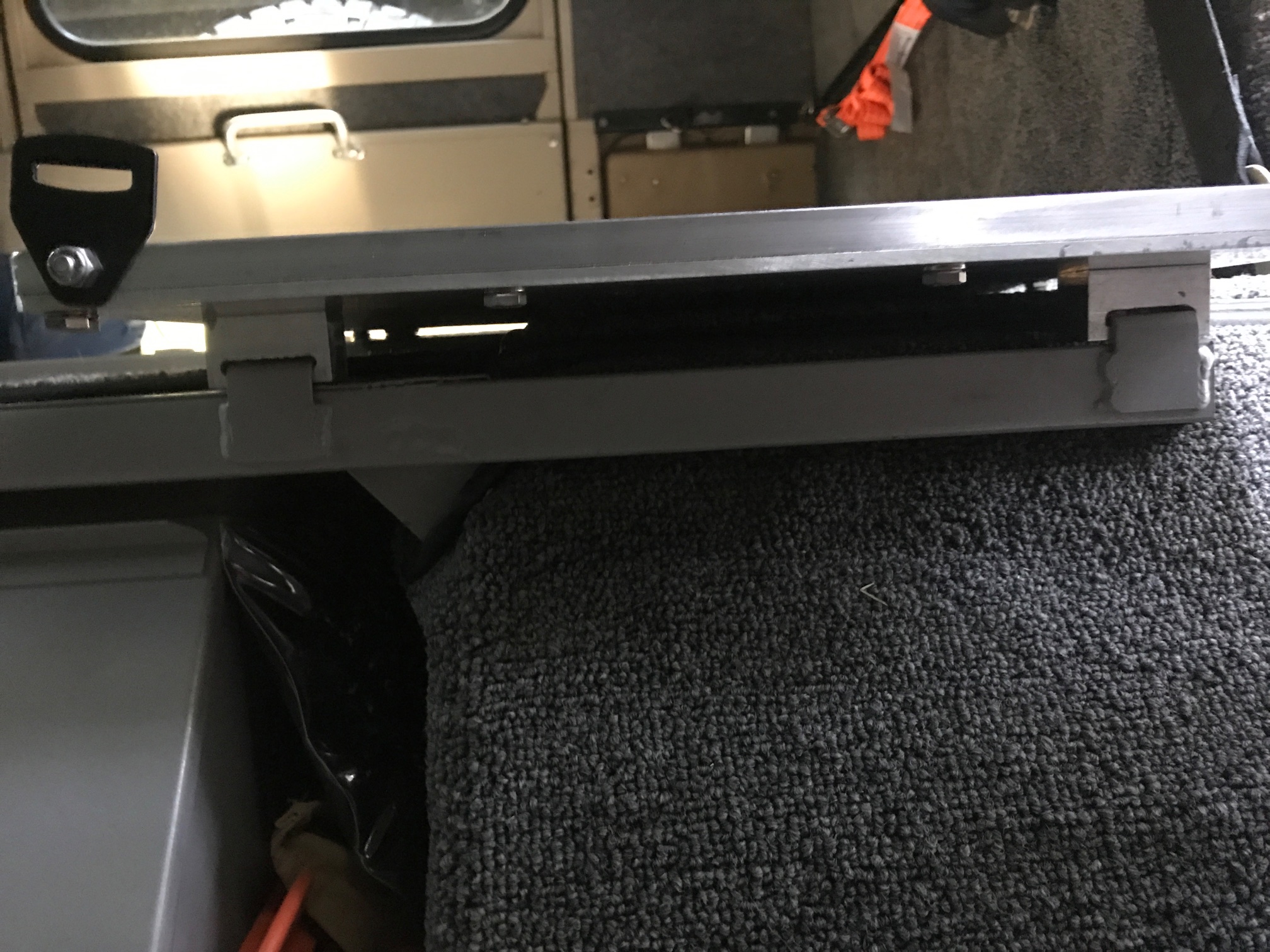

Mounting tray is 3/16" 6061 plate, locked in place on Seat mounts and bolted in position.
A 1/2"x1/2" rail around the whole tray to accommodate tie downs and provide rigidity.
A piece of square Aluminum 1"x1"x1.5" slotted to catch the Seat clips and level the tray out.

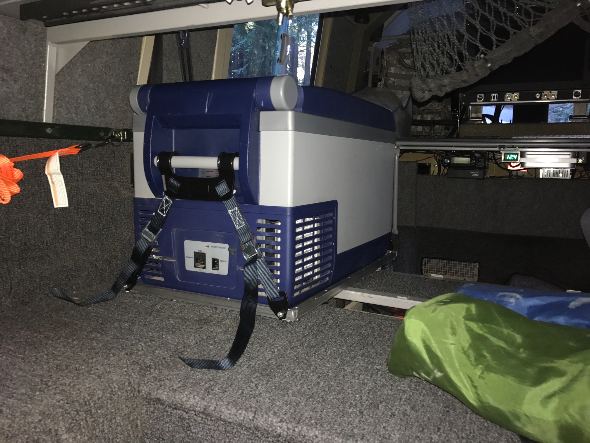

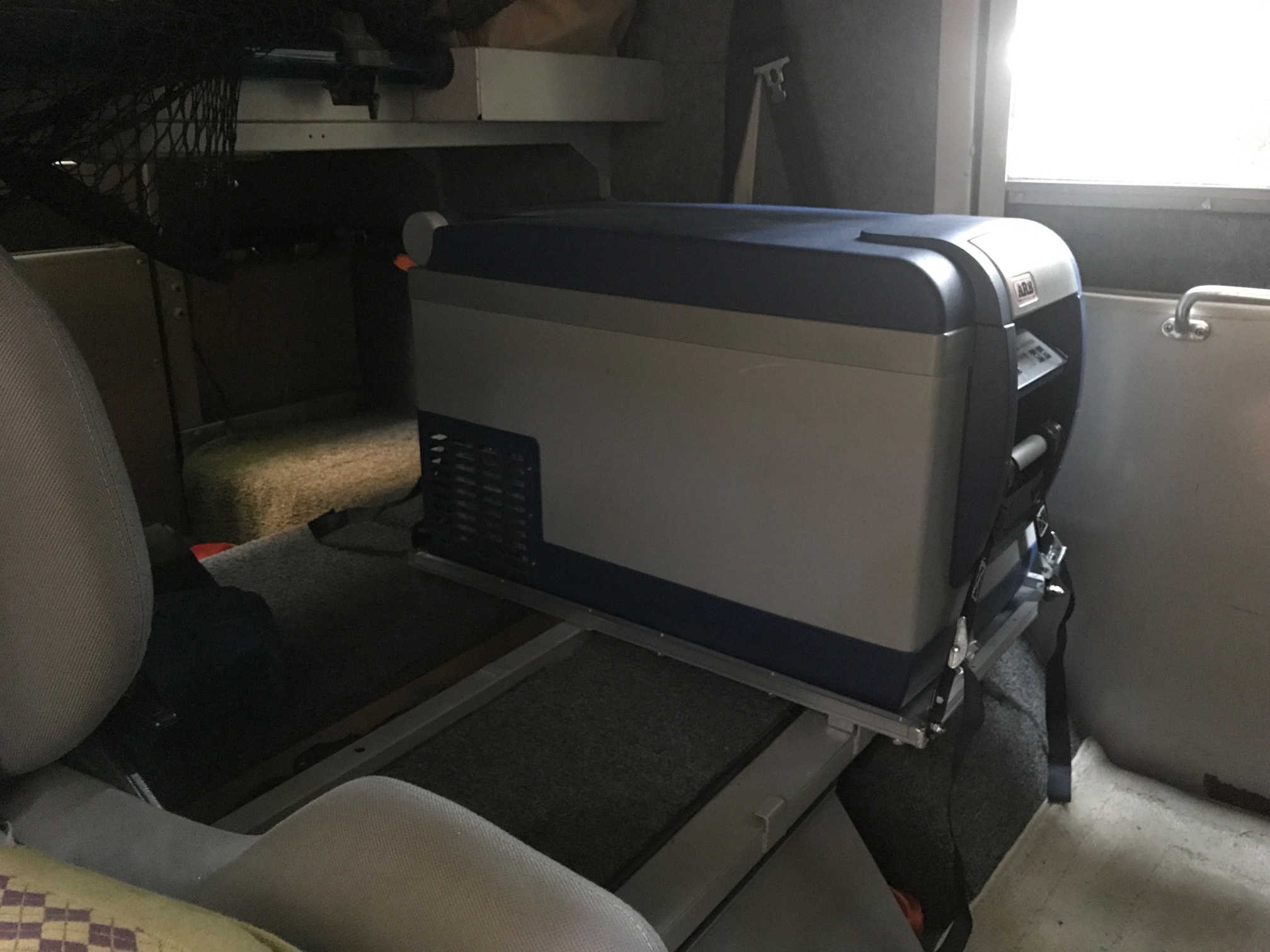

Front and rear view of mounted ARB Fridge.
ARB SideView.jpg (666.74 KiB) Viewed 5725 times
ARB RearView.jpg (951.38 KiB) Viewed 5725 times

Although I did cut this so it is symmetrical and would fit in any of the three seat
positions, my darn Monaco seats are so wide you can't fit the Fridge in between.
Might work with the (uncomfortable) stock Seats though. In the as seen position
the venting of the compressor is toward the back center of the truck, mounted
on the other side of the truck it would be toward the side panel, but I made sure
there was about 3" of clearance for airflow. Tray is 16" x 26" for this particular
ARB fridge.

And it turned out to prove to be pretty rugged. Went on a trail
that was a whale of a lot more challenging than I signed up for.
The fridge didn't budge 1.0MM. But I took a knocking about in the
cab. The cold Beers after that run were well appreciated :wink:
