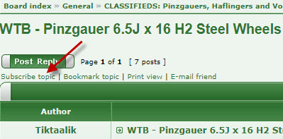

Can someone tell me how to subscribe to my own threads? I can't find it and I am not receiving notifications when you respond.
Thanks!
Re: WTB - Pinzgauer 6.5J x 16 H2 Steel Wheels
11-2-2017 1-04-51 PM.jpg (39.17 KiB) Viewed 4696 times

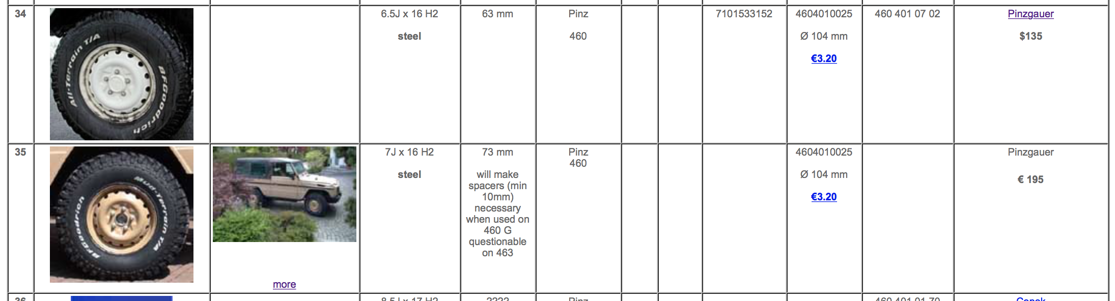

The air cooled pinzgauer wheels (and the ford transit wheels) will not fit on a g-wagen as it uses 5x130mm pattern not the 5x160mm pattern of the early Pinzgauers.
The later Diesel Pinzgauer's wheels will fit on g-wages but the deep backspacing might be an issue. You should also consider the 2002-2006 Sprinter steel wheels which are very similar to the original diesel Pinzgauer wheels but are only 6 inches wide.
There is a good reference sit on the Web of all the g-wagen wheel options - I'll see if I can find it.

Supposedly either of these two Pinz wheels (see attached image) should fit a W460.
TechMOGogy wrote:Probably this one but I am sure you have seen it from CGW
http://www.rubicon-trail.com/G-Class/wheels/start.html
Screen Shot 2017-10-29 at 9.08.15 AM.png (511.26 KiB) Viewed 4643 times
