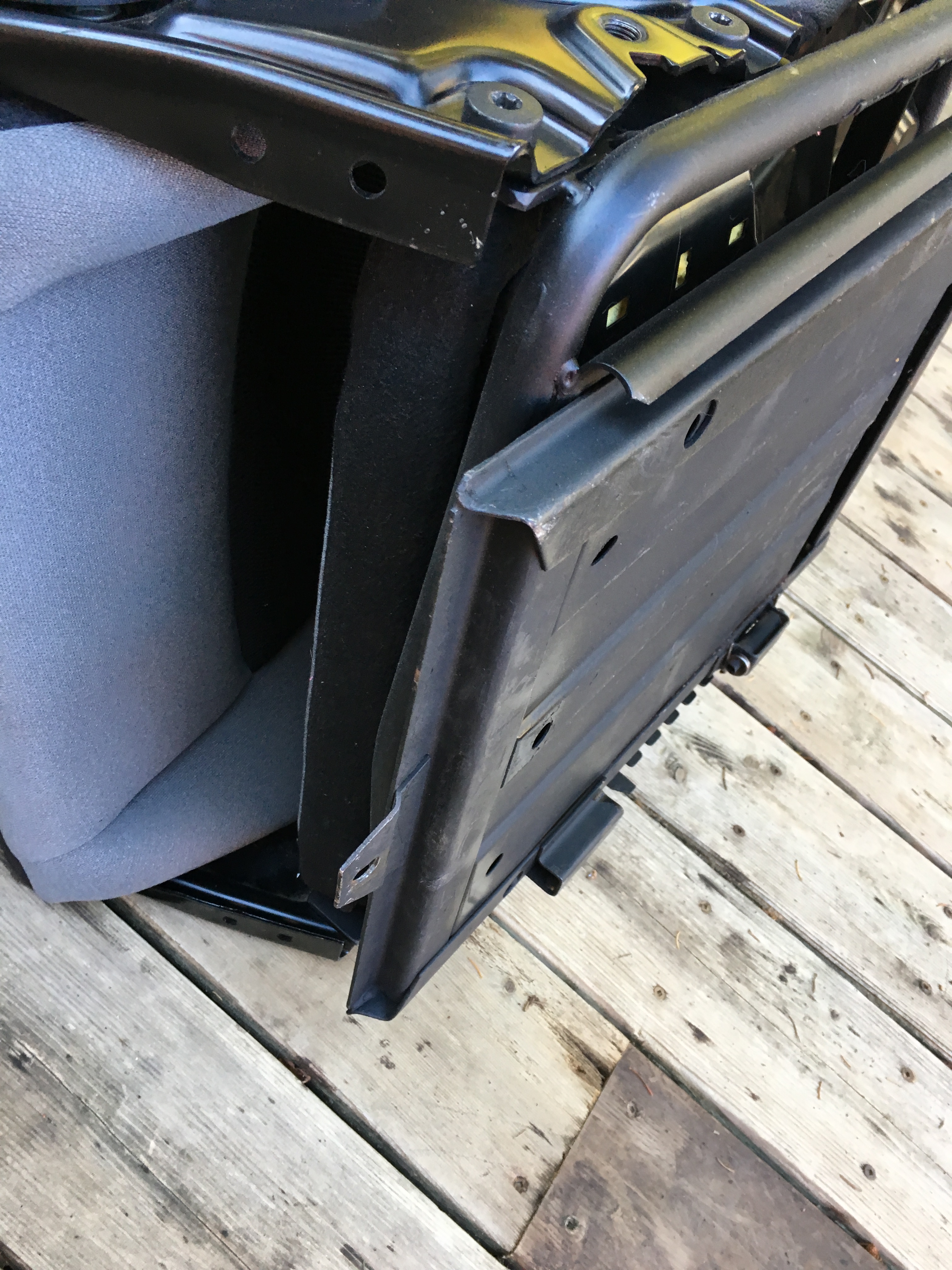

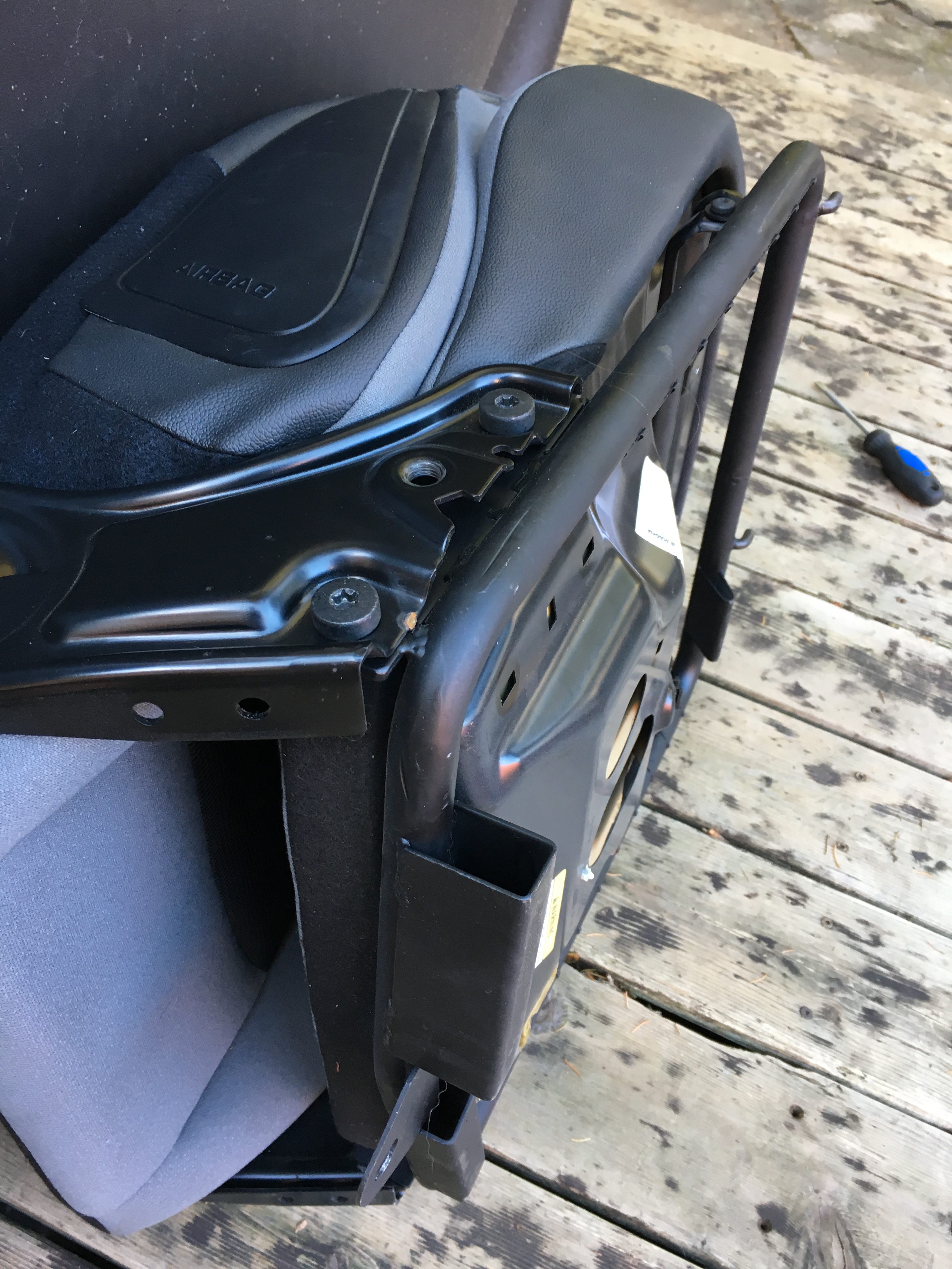

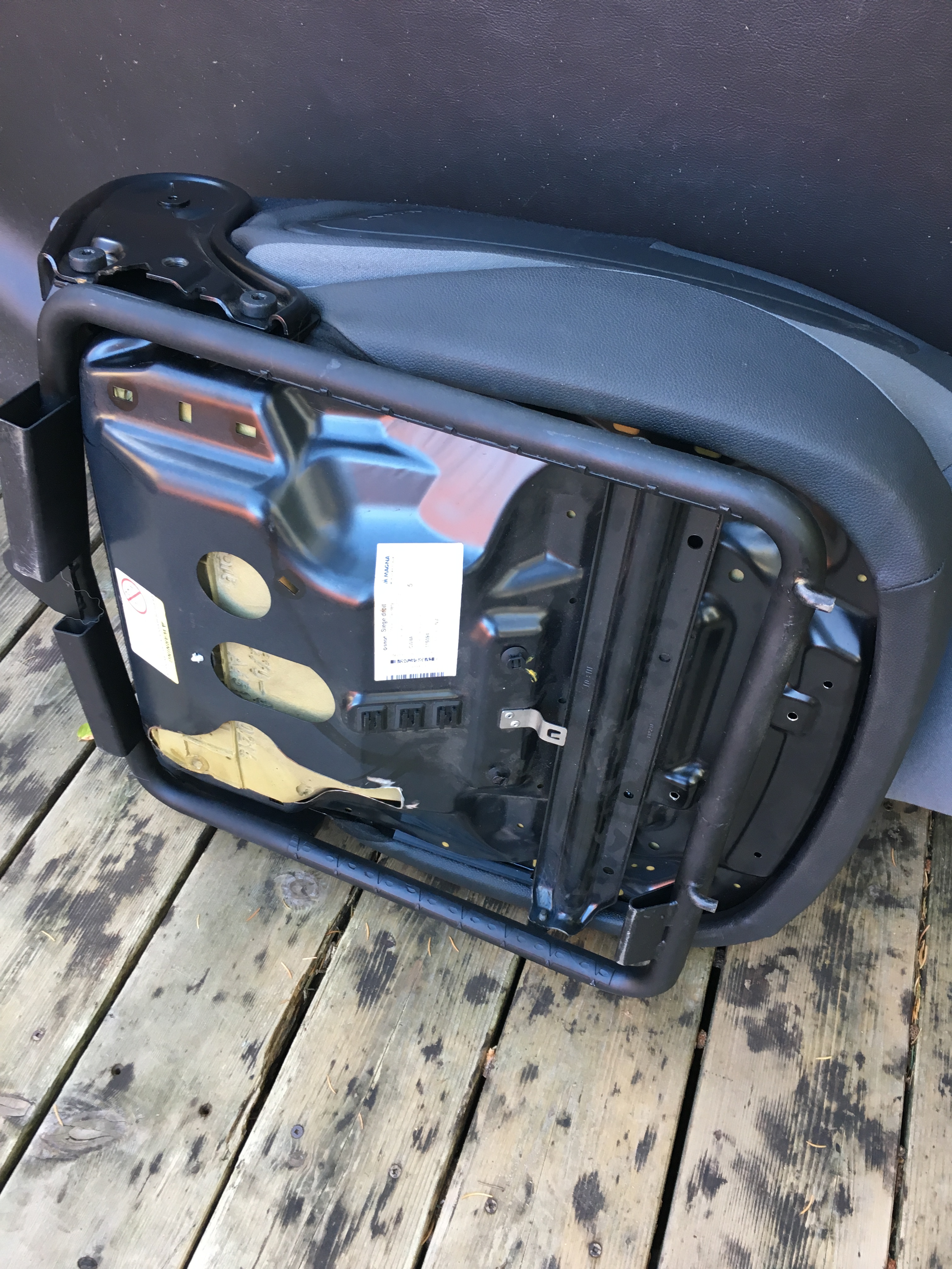

Re: Smart Car Seats
Took some pics last weekend
I sourced both my sets here: http://www.smartcarofamerica.com/forums/f11/
Re: Smart Car Seats
I have up making frames for after market seats and just use the pinz frames as is pictured above. Only requires cutting a few small welds and if for some reason they needed to be returned to stock just cut the new welds and reweld then on. I have used many different import seats just as long as they are under 19" wide and less then 3" tell at seat bottom they will fit the same as stock.
