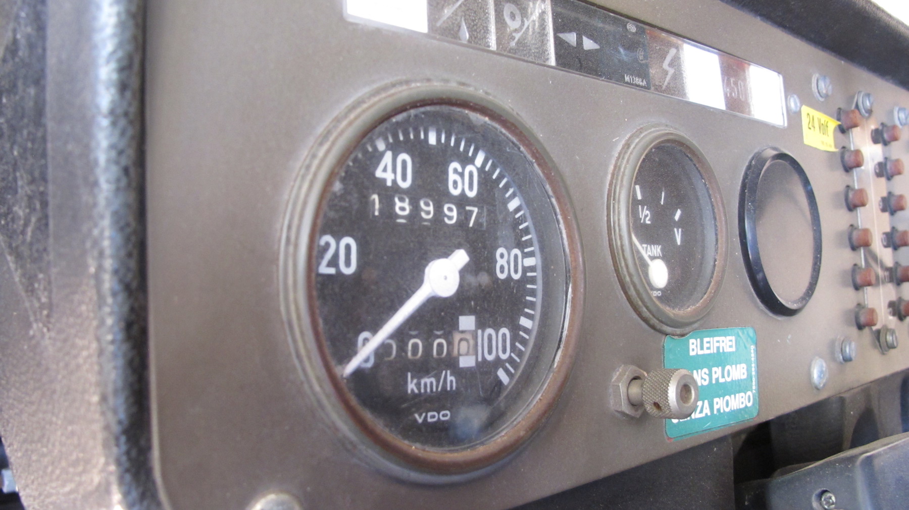

Remove the burled trip odometer knob on the front side of the dash via the set screw, and the nut on the dash front side to release the trip odometer cable.

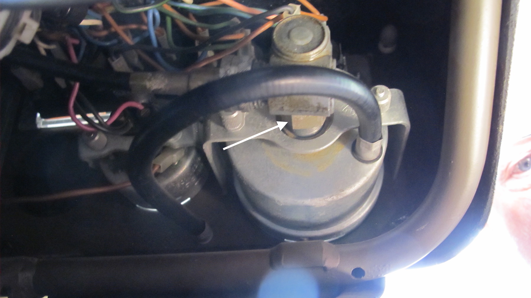

Disconnect the speedometer light wire on the back of the speedometer.
Undo the large brass nut (white arrow) between the speedometer and the 90 degree angle fitting that the speedometer cable attaches to, freeing the speedometer from the fitting
Remove the burled nuts on the "U" shaped retention bracket to allow the speedometer to be pulled out from the front side.
Pull the speedometer out from the front side of the dash.

I think you have it covered. The 90 degree angle fitting is optional; I think if you check it carefully you will find that the output (the side that goes into the speedo) is several percent faster than the input. If your mechanical speedo reads faster than it should, remove the 90 degree unit and connect the cable directly into the back of the speedo - the indicated speed will drop a bit.
