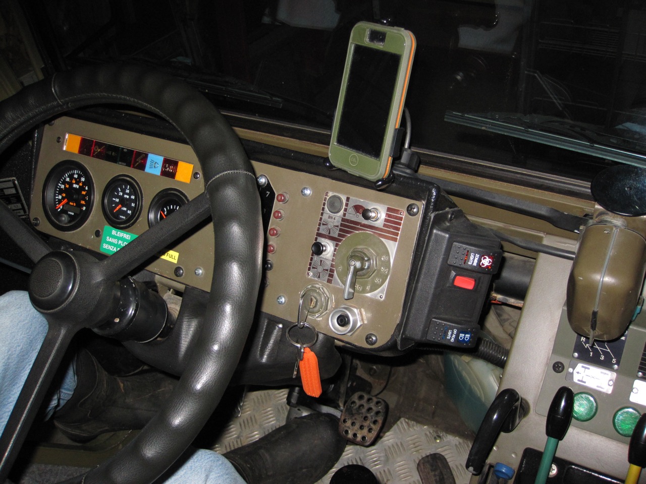

Just a simple molded switch panel (for a Jeep :oops: ) and some Carling switches.
Great source for the switches: http://www.otrattw.net/home.php

Thanks Paul, the link is helpful. I like your pod.

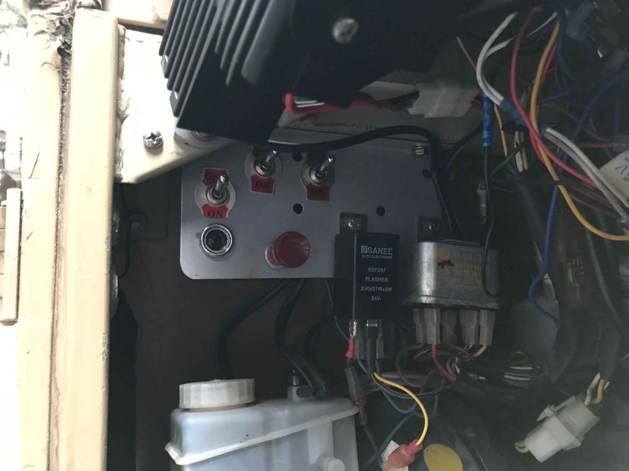

I have added switches for Aux lighting to the Hazard/Aux 24v panel as below. In retrospect you could refab that
panel somewhat longer to add more switches. It's a bit out of the way but after a bit my fingers seem to find the switches.

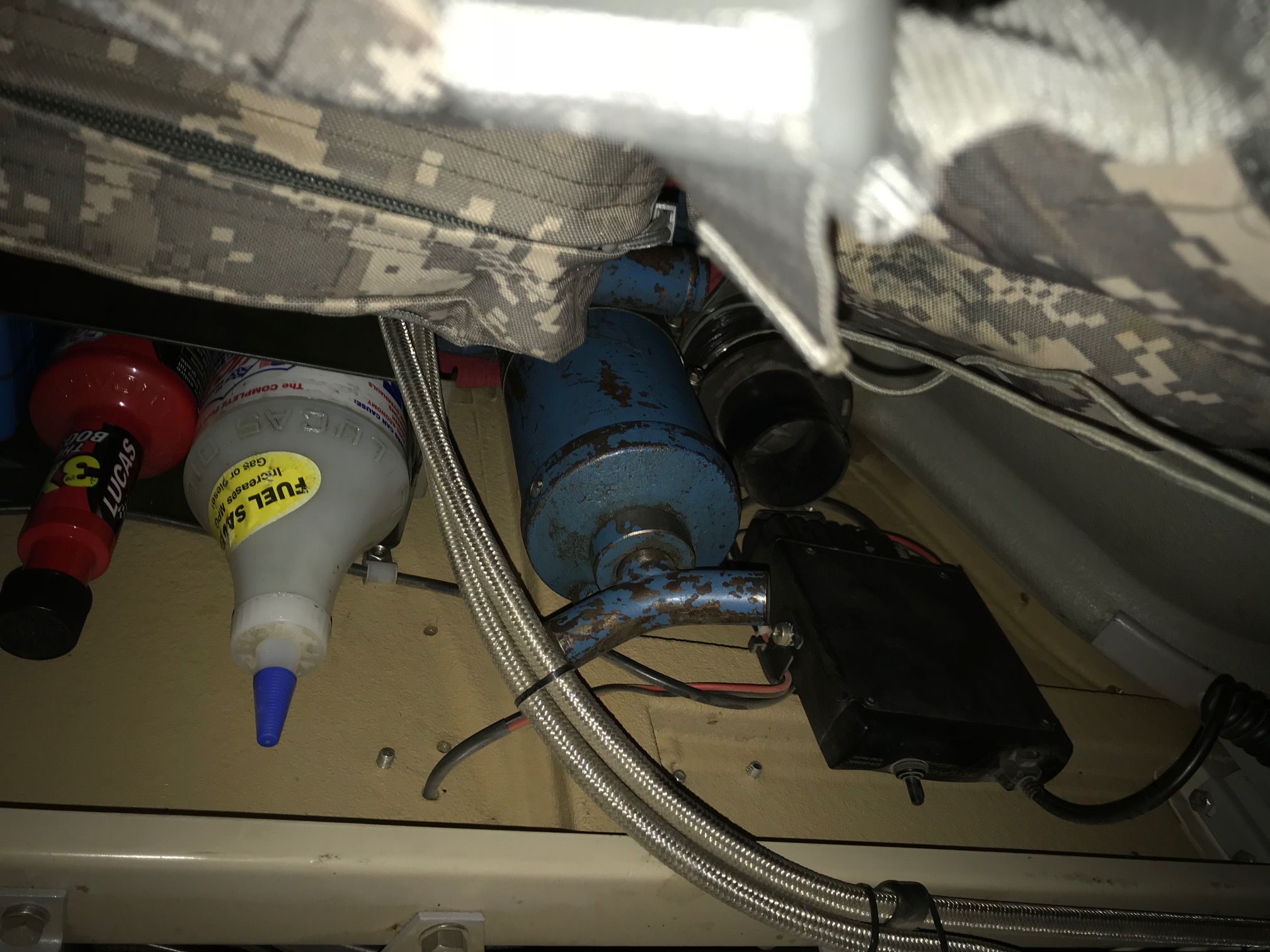

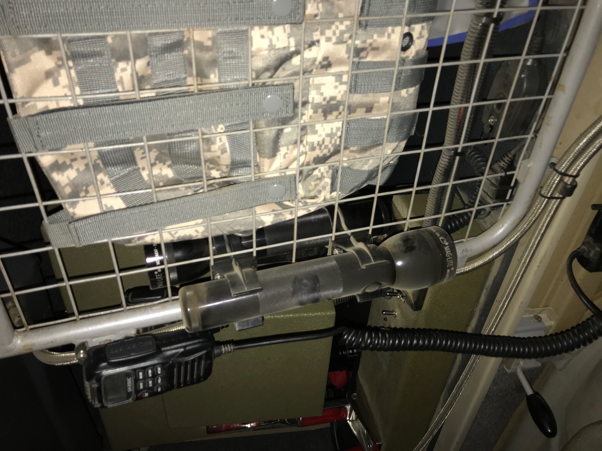

My CB is mounted behind the drivers seat, I chose a unit that has all the controls built into the MIC -- very convenient.
The unit behind the seat is the Transceiver.

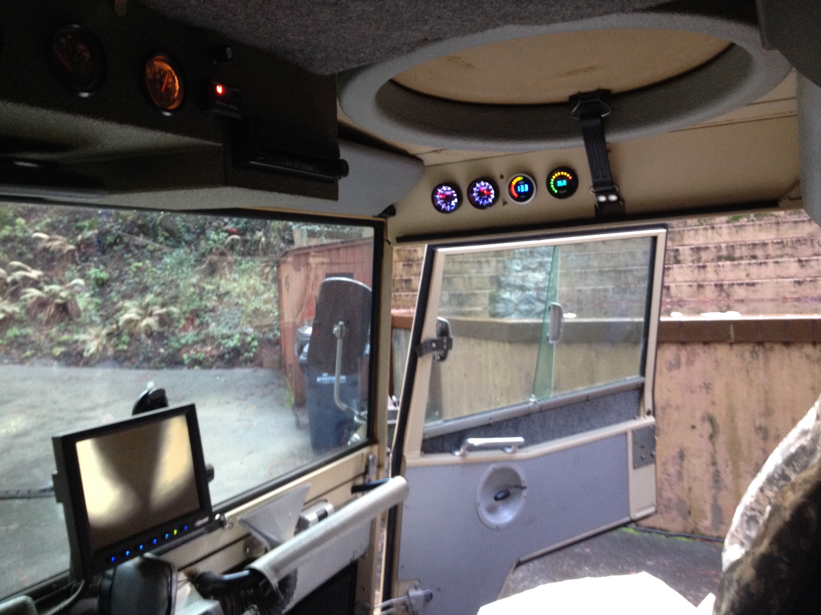

One other not so obvious place to mount switches and gauges for a hardtop "K" is the space above the door jams.
Passenger side for Gauges, Drivers side for switches. It's a very small cavity and takes some effort to fab a panel
that fits and is rattle free. There are low profile switches and gauges. I do have an overhead that mounts additional
gauges and a Alpine receiver/GPS unit and just ran out of space. Dropping your windshield is out for this approach.

Paul, how does your phone mount, suction, bolt on ?

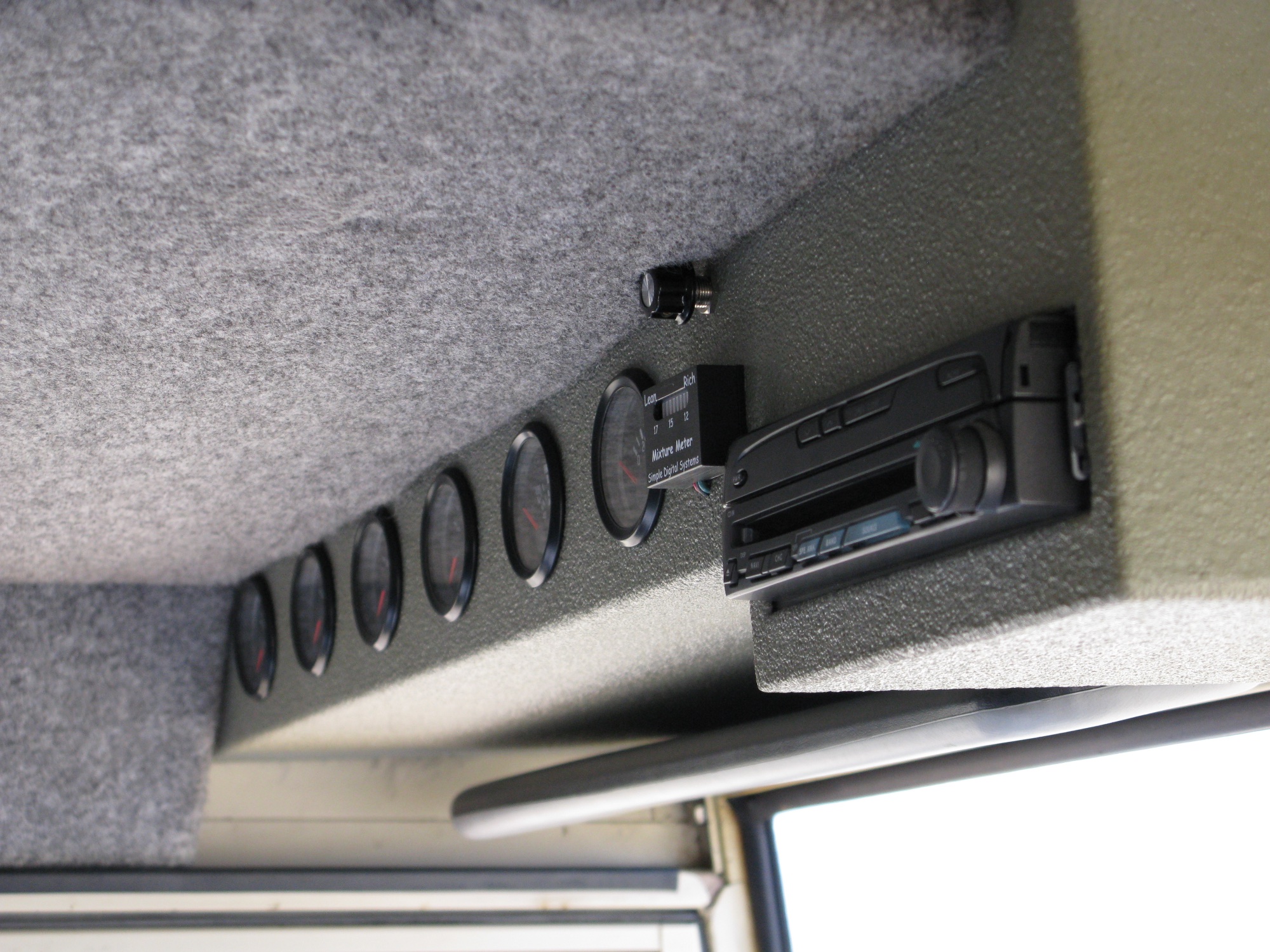

Ron, Do you have a better photo of your overhead console that is partially shown in one of your pics? How is your screen attached to the wiper motor? And yes, I plan on putting the radios in the rear, perhaps in a transportable case with the heads up front. Unfortunately I do not have a table but have posted a WTB in an attempt to find one. Andre may have a lead, fingers crossed!

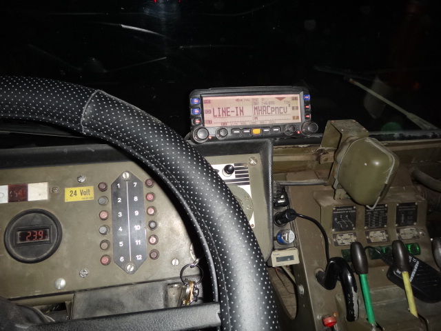

Jim, Do you have a photo of the mounted radio head you mention mounted over the wiper switch? And, tell me more about what appears to be an inclinometer in the front.

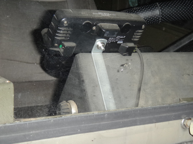

This is the head as seen from driving position. I can just reach the buttons/knobs while keeping my thumb hooked on the wheel; not only do I still have some connection with the wheel but this helps to stabilize my hand as I reach for buttons.
At one time I had the GPS mounted to the top of the wiper bracket; you can see the four holes that I drilled and tapped for the mount.
This radio head had a central mounting point, so I bent a bracket to fit and used VHB (very high bond) tape between the bracket and the back of the dash. Hasn't budged in years.
The inclinometer is similar to this one: https://www.amazon.com/Lev-O-Gage-Sun-L ... clinometerIt's main purpose was to train my wife not to scream until the ball gets into the red section; by that time I'm puckered so badly that I can't hear her! A quick Google did not turn up any that were color coded like this one I had gotten decades ago but they are probably out there still.

whitesik wrote: Paul, how does your phone mount, suction, bolt on ?
The mount is from https://thoughtout.biz and I used their self adhesive pad (AdPad 300) to glue the base onto the dash shroud. IIRC, the pad is made from 3M VHB and has held up very well.

A better view of my overhead is below, prototype used for the RedBull Pinz'ies -- long story.
It's pretty heavy steal construction, 4 Pyrometers for each cylinder, Oil temp and pressure,
Alpine unit, and a AFR bar meter for my EFI. Not a simple fab and I don't know who built this.
It's a HUGE PITA to replace one bulb :)
The front display is a simple mount with a ball joint swivel right on the Wiper motor mount.
Pretty solid. Takes three inputs, Back-up and a Side view camera, and a USB to VGA adapter
so I can use this as a second display from my MAC Mini for Trails/NAV.

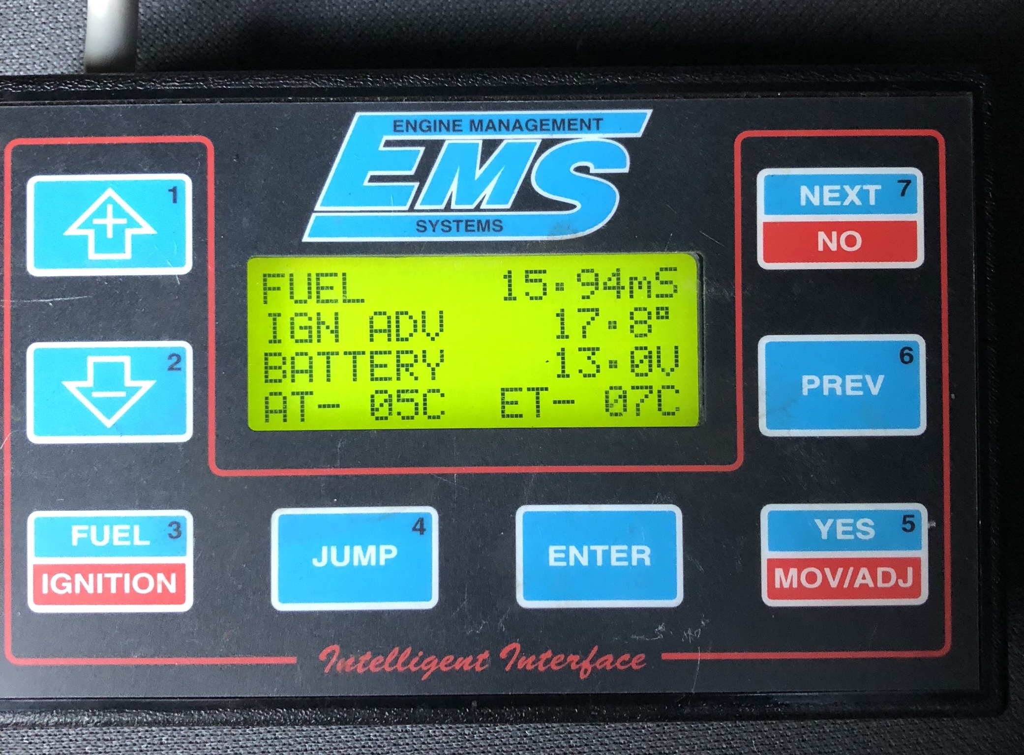

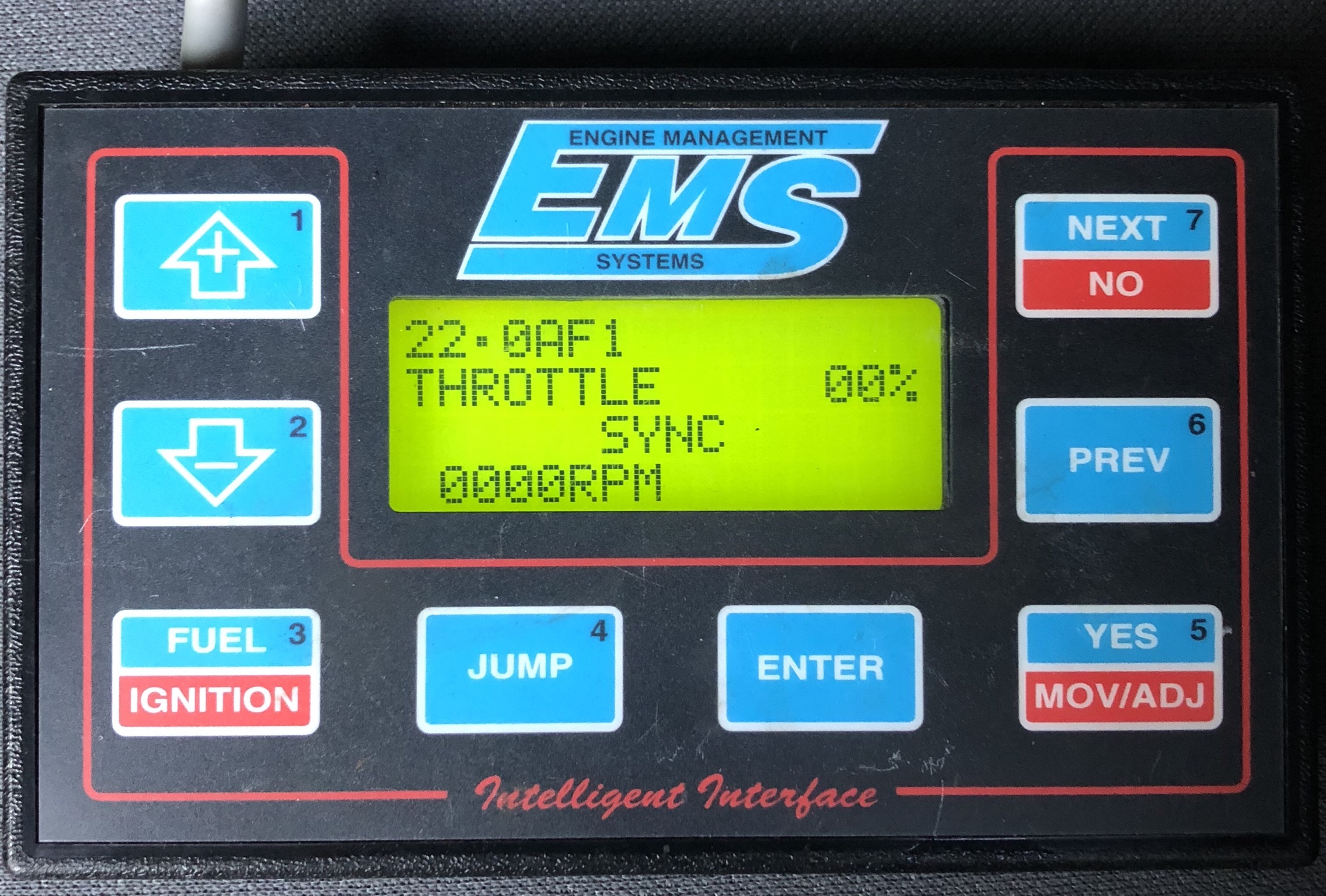

Not in a console but since gauges are in the thread I thought I would add my EMS
Interface. Has most of what is required on 2 screens plus I can adjust things on the fly if needed.
