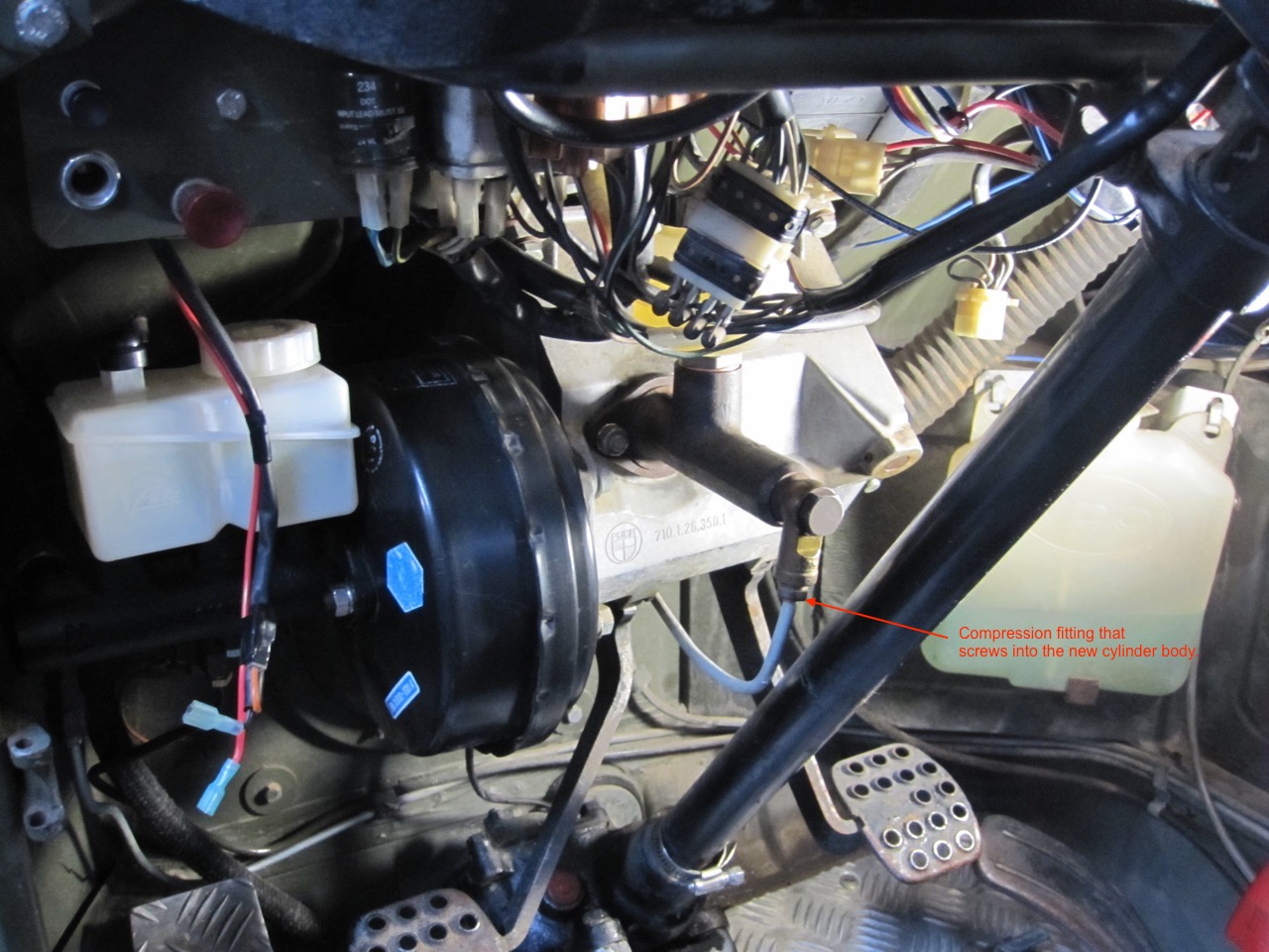

by pcolette
I had to do this 2-3 years ago. It looked like a potential headache at first but was actually fairly easy. The compression fitting on the line that connects to the banjo fitting screws directly into the new cylinder body with no problem. The hydraulic line needs just a small amount of bending by hand to line it up properly.

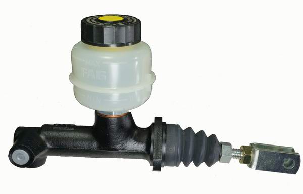

Was your new fitting "clocked" 90 degrees up to the 3PM position
versus what you show in your PIX at the 6PM position?
Just seems like a 90 degree rotation gets you close to the Brake peddle ?

Just for reference here's a PIX of the new Master showing the exit on the side
clocked to the 3PM position.
ron

Here's a few photos which hopefully will help.
Re: Clutch Master Cylinder
Posted: Wed Nov 29, 2017 5:34 pm
by rmel
Yes! Very helpful!
Thanks.
Ron

While the bend does move the clutch line closer to being over top of the brake pedal, remember that the pedal moves DOWN, away from the clutch master. And my foot is securely on the pedal, below the bend, and moves away from the clutch line as I press the brake. In other words I don't feel that the modification has any effect on the fit of feet on the pedals; it is just a non-issue.
Paul's photos (yup, he beat me to it) generally reflect my truck as well. I think my 90 degree bend was a smidge tighter.
