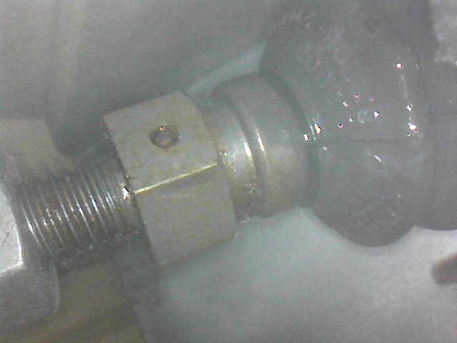

Re: Clutch issue
Posted: Sat Dec 02, 2017 4:45 pm
by rmel
Well I knew for sure the Clutch Master was leaking, but here's a PIX I just took from a Boroscope
right behind the brake assembly.
These Borescopes are pretty inexpensive and, has saveed me a lot of speculation in the past.
Note the wet boot and the boot is not actually seated properly.
Clutch Master.JPG (33.99 KiB) Viewed 8864 times
