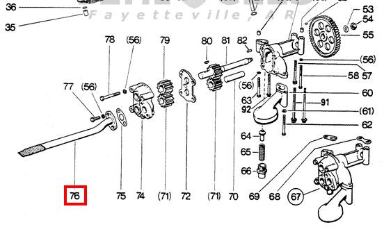

by Haf-e
Here is the parts drawing - item number 76
Oil Pump Pickup.jpg (31.16 KiB) Viewed 9648 times
Re: So I found this in the oil pan..
Posted: Tue Jan 09, 2018 10:40 pm
by Haf-e
So I suppose the damaged pickup screen might be due to prolonged vibration? Perhaps it happened previously as well and the mechanic didn't find the gasket(s) when it was fixed?

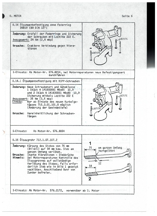

Posted: Wed Jan 10, 2018 2:24 pm
by The true Pinzgauer´s
the lossen Screw´s are a know proby factory side. see service Information (i have only in german)
in the spare part picture are the new version screw´s no 93 +92 they are Ripp-Screws( selflooking) also as Kit at http://www.puch.at/2717_Oelwanne-_-Oelpumpe.aspx?LNG=de Position 40 available. Check the EngineNumber and Engine Part number on the right side befpr remount, beetter messure the deep of the thread holé there are different engine case!
check the sealing surfaces for the cooper seal for the oir drain! it will be damage, by this pictures. grind the seal surface espacelly in the engine case.
the Oil tube can mostly not remove from the closed engine case because it is fixed in a canal.
if you can get it out, remove the hard-welded hole-panel, contuse the end of the tube and drill some new 2mm holes, that´s the factory side´s last version.
If you can´t pull it out, let it in...it is only for extrem down hill driving condition´s, it pump the oil first cylinder area into the oil pan, the second selection of the Main Pump sucked the oil there and press it into the case.
the oil pump pressure vale should be removed and the sealing surface have to be checked / regrinded. if you need much grinding, messure the opening pressure.
Posted: Wed Jan 10, 2018 11:41 pm
by baremetalworks
Thanks True Pinzgauer’s, this was exactly what I wanted to know about the oil suction tube, great information as one2many said. Im gonna have to check the case numbers tomorrow and see where I’m at on this.
here’s the google translate text for others interested:
0.14 01Pump attachment without spring washer 26819 (B8 DIN 127) Modification: Removal of spring washers and securing of screws with Loctite 222 E. Tightening value: 24 Nn (2.4 mkp) Cause More accurate connection against vibration 0CTITE S insert: From motor no. 575.8214, for engine repairs, carry out a new fastening method 0.14.1 pump attachment with RIPP screws Change: New type of screw and grade 1 piece N 141600061 M0x55 10.9 and 2 pieces N 141600051 M8x80 10.9 Securing by means of Loctite 222 E OCTITE Tightening value: 35 N original ur from use of the new crankshaft 712.3.01.101.0 RTot (change of thread depth) LOCTITF Cause: Unification of the screw lengths S-insert From engine no. 576.9054 o.15 Oil suction tube 712. 1.07.107.2 Change: Reduction of the sieve from 75 mm 75 all around the circumference (image / 1 to 54 mm or sieve to hard-soldered whole circumference.) Cause Severe vibrations Screen breaks Note Check for engine repairs of the suction tube for complete sieving of the sieve, if necessary, check the sieve as shown in Figure 1. Then free the tube of scale S-insert: From motor No. 576.2172 usable from the 1st motor
Posted: Thu Jan 11, 2018 2:45 am
by Hotzenplotz
baremetalworks wrote:Thanks True Pinzgauer’s, this was exactly what I wanted to know about the oil suction tube, great information as one2many said. Im gonna have to check the case numbers tomorrow and see where I’m at on this.
let me do this translation, google has room for improvement :-)
0.14 Oil pump attachment without spring washer
modification:remove the spring washers and secure the screws with loctite 222E., tighten to 24 Nm torque
reason: more precise connection against vibrations
implemented from engine no 575.8214, apply to all engines during repairs
0.14 Oil pump attachment with RIPP screws
modification: new screw type and quality class; 1 item N141600061 M8x65 10.9 , and 2 items N141600051 M8x80 10.9, secure the screws with loctite 222E., tighten to 35 Nm torque
usage : only possible with crankshaft housing 712.3.01.101.0, changed depth of thread
reason: standardization of screw length
implemented from engine 575.9054 onward
0.16 Oil sucktion pipe 712.1.07.107.2
modification: filter shortened from 75 to 54 mm; filter soldered at whole circumference
reason: strong vibrations causing cracks
hint:during every repair inspect the suction pipe for proper soldering ; resolder if needed
implemented from engine 576.2172, apply to all engines during repairs
Wolfgang, Danke für das Dokument !
