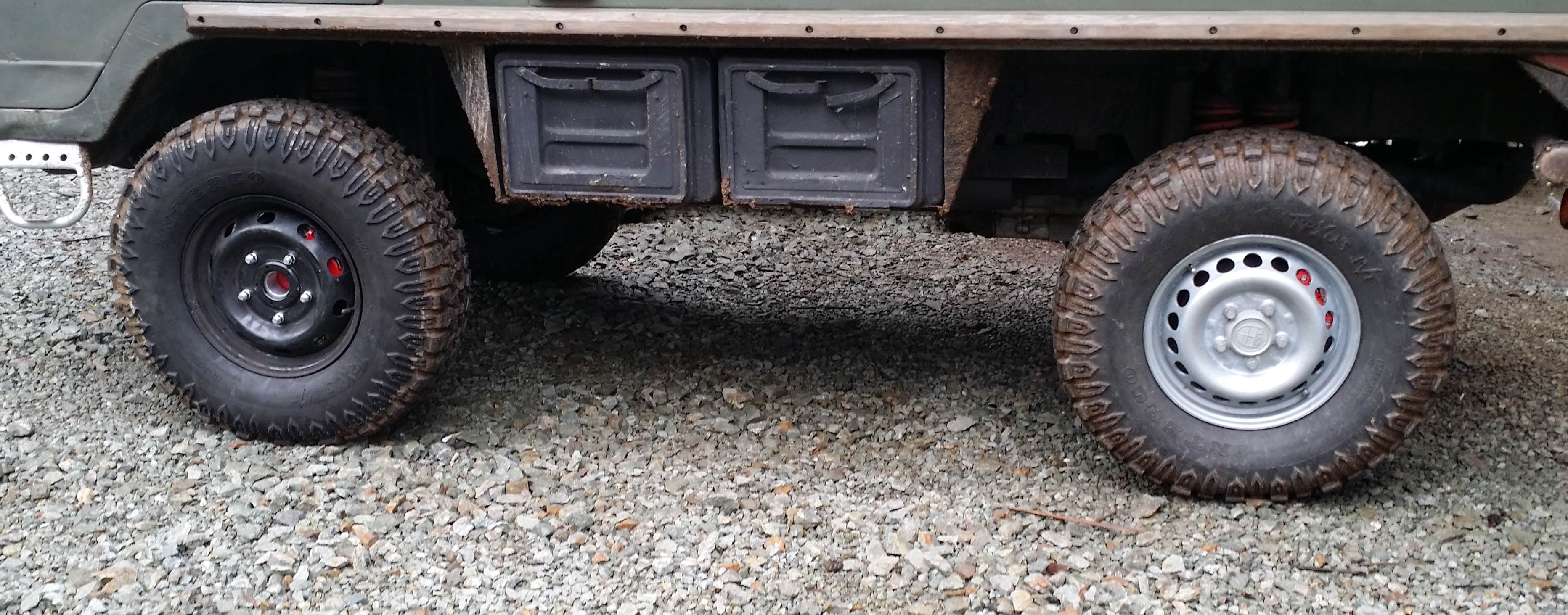

I was able to test fit and test drive the disc brake system with a set of Ford Transit wheels - they work very well. Due to their slightly lower backspacing and slightly greater 6.5 inch width (compared to the 6 inch width of the Sprinter wheels), the wheels are moved outward just under 2 inches (50mm) on each side (compared to 29mm or about 1-3/16" for the Sprinter wheels). This results in the wheel's extending 3/4" past the wood rub rails on the sides (with the Sprinter wheels the edge of the tire is even with the wood rub rails). The steering effort and handling both on road and off-road was found to be very acceptable with the Ford Transit wheels.

Yes - the look of the Transit wheels has grown on me - especially when they are painted green to match the truck. Here is a picture of one like that:
Pinz Transit Wheels Brady.jpg (307.49 KiB) Viewed 27785 times
Yes - the manual proportioning valve does require adjustment when loads vary - its not a perfect solution but it does allow dialing in the amount for different vehicles - for my Pinz which has been mostly lightly loaded I've kept it on the minimum value and the rear end barely locks up on gravel - and only when the front wheels are also locked up. Before I installed the proportioning valve there was way to much rear braking going on... of course when 4WD is engaged then the rear and front axles all rotate together so it's not as much of an issue off-road.

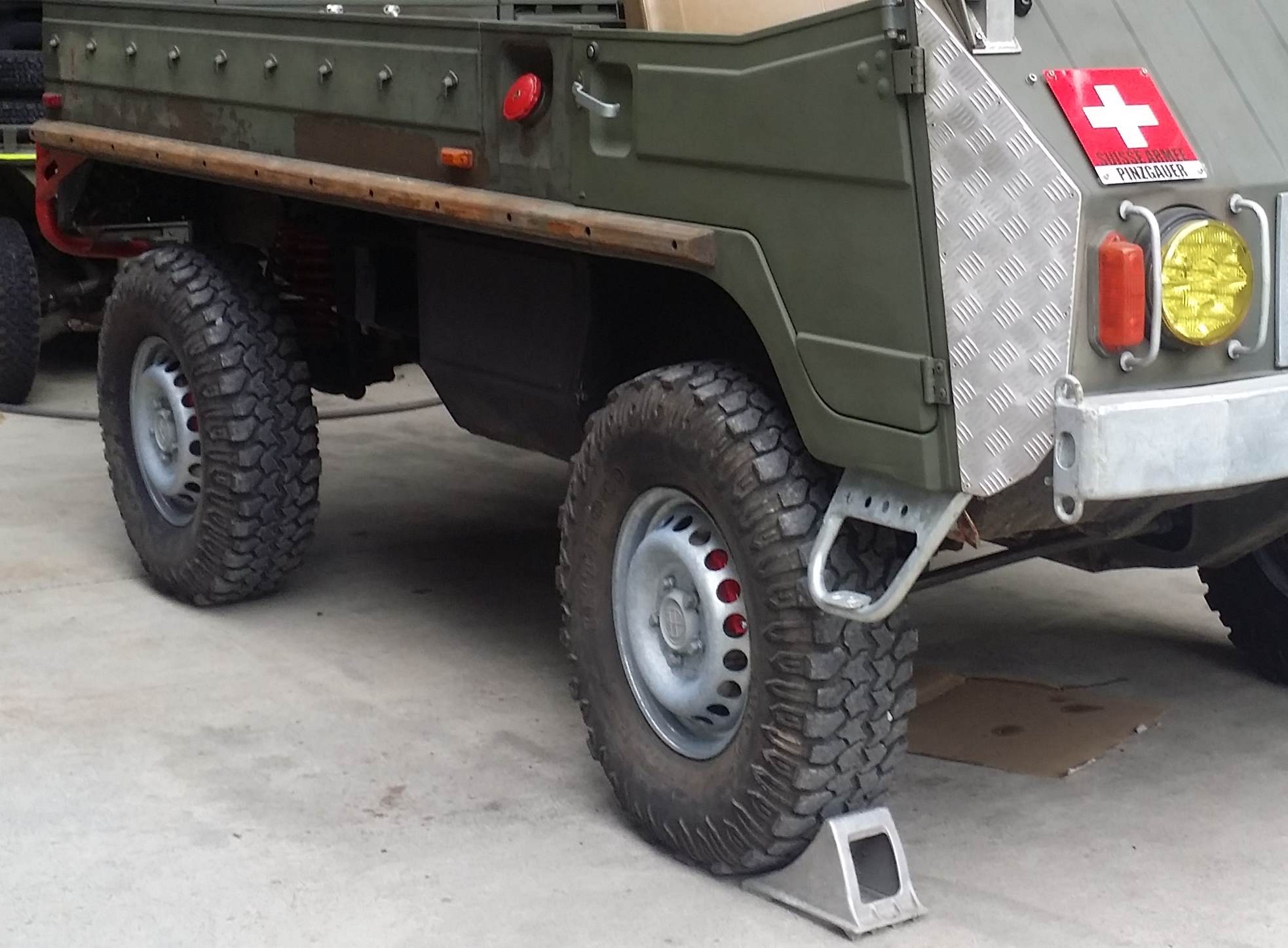

VinceAtReal4x4s wrote: I like the front <Transit> wheels more in the pic. The rears <Sprinter> almost look fragile with the amount of holes it has. I know they aren't but it just feels that way at a glance.
Here is a picture of the Sprinter wheels from an angle - they look better that way then when viewed straight on IMHO.
Pinz with Sprinter wheels.jpg (204.19 KiB) Viewed 27729 times
The gross rear axle weight (GAWR) rating on the Sprinter with these single wheels is over 4000 lbs - so they should handle the weight of a 710 or 712 without issue. The Transit wheels are heavier - 32 lbs - vs 30 lbs for the Sprinter wheels.

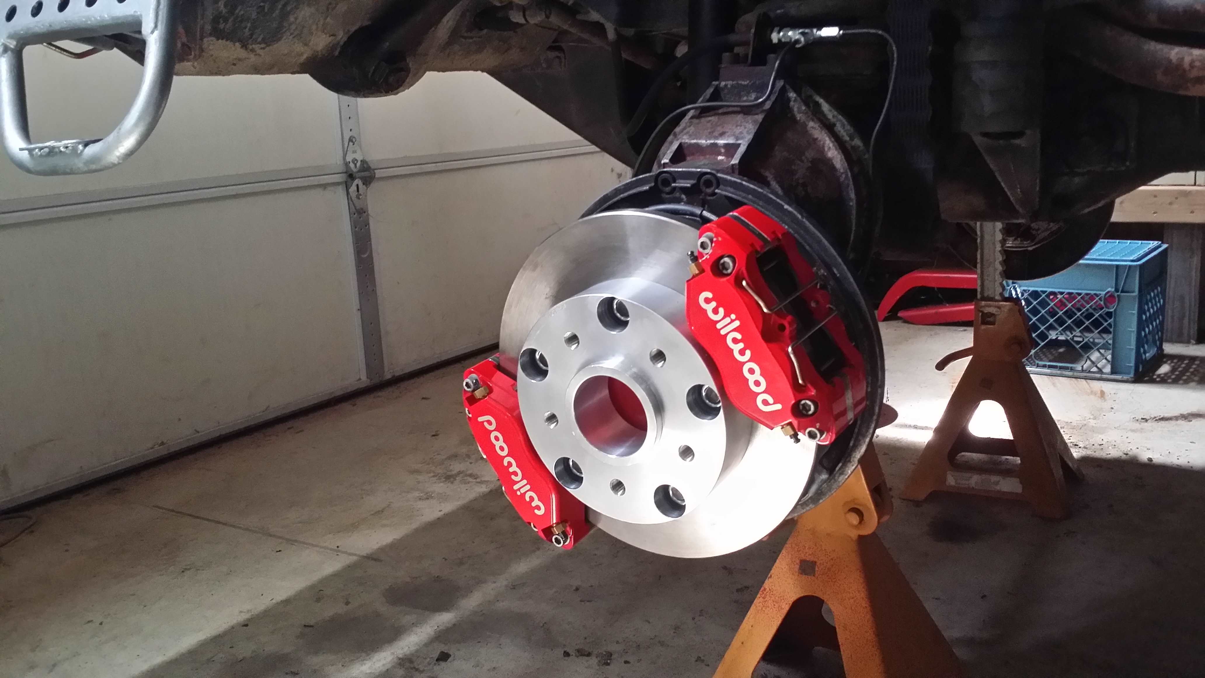

Here are my disc brake brackets after I had them yellow zinc coated and a shot of the disc and spacer with studs!
Can't wait to get started on the install!!!!

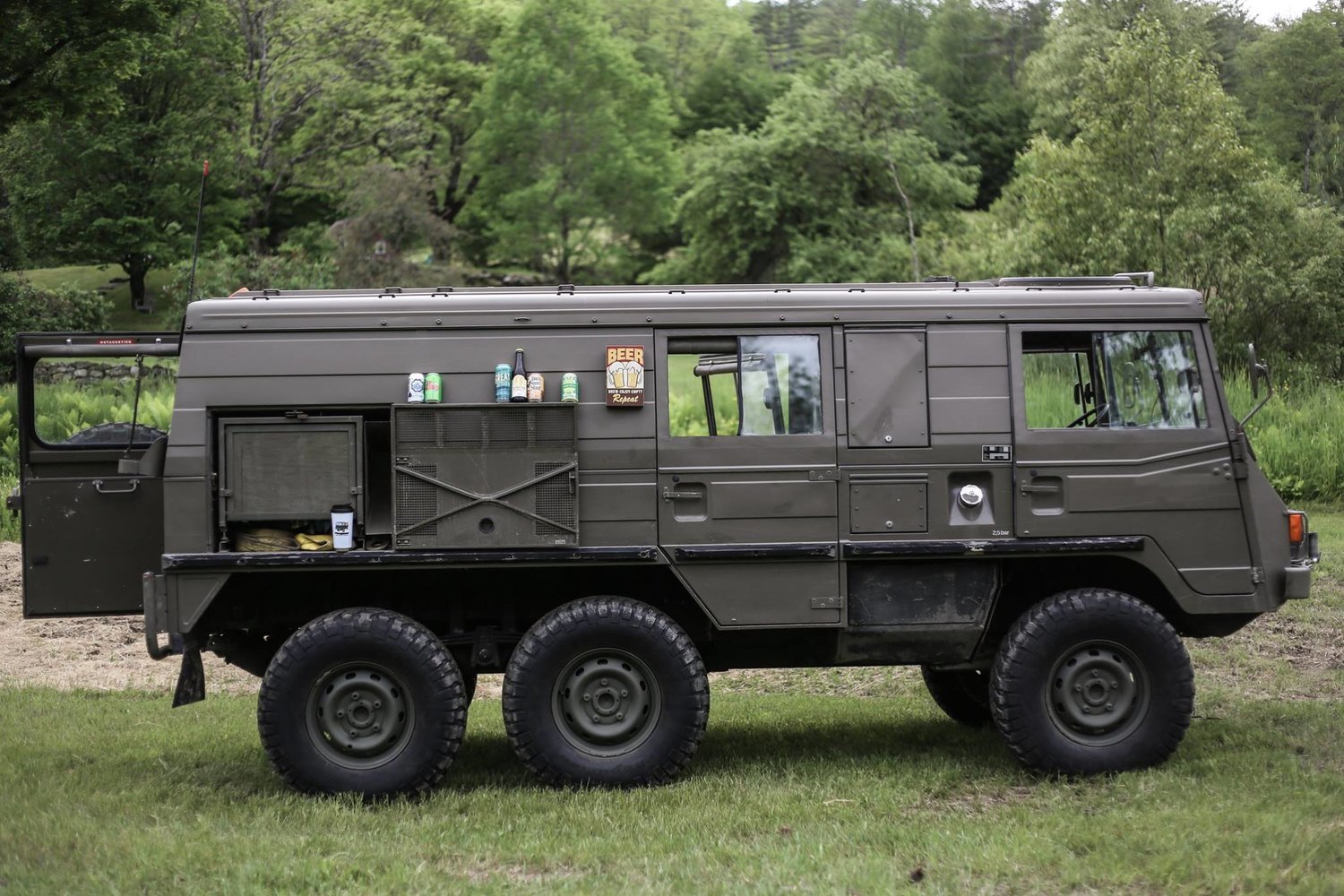

That's my pinz with the transit wheels on them and the beer cans lined up on it...
This was last summer with the drum brakes still on it.
The rims came in black.... I just found some rattle can paint which was a close flat green match....
As they get love marks... I just touch up spray them!

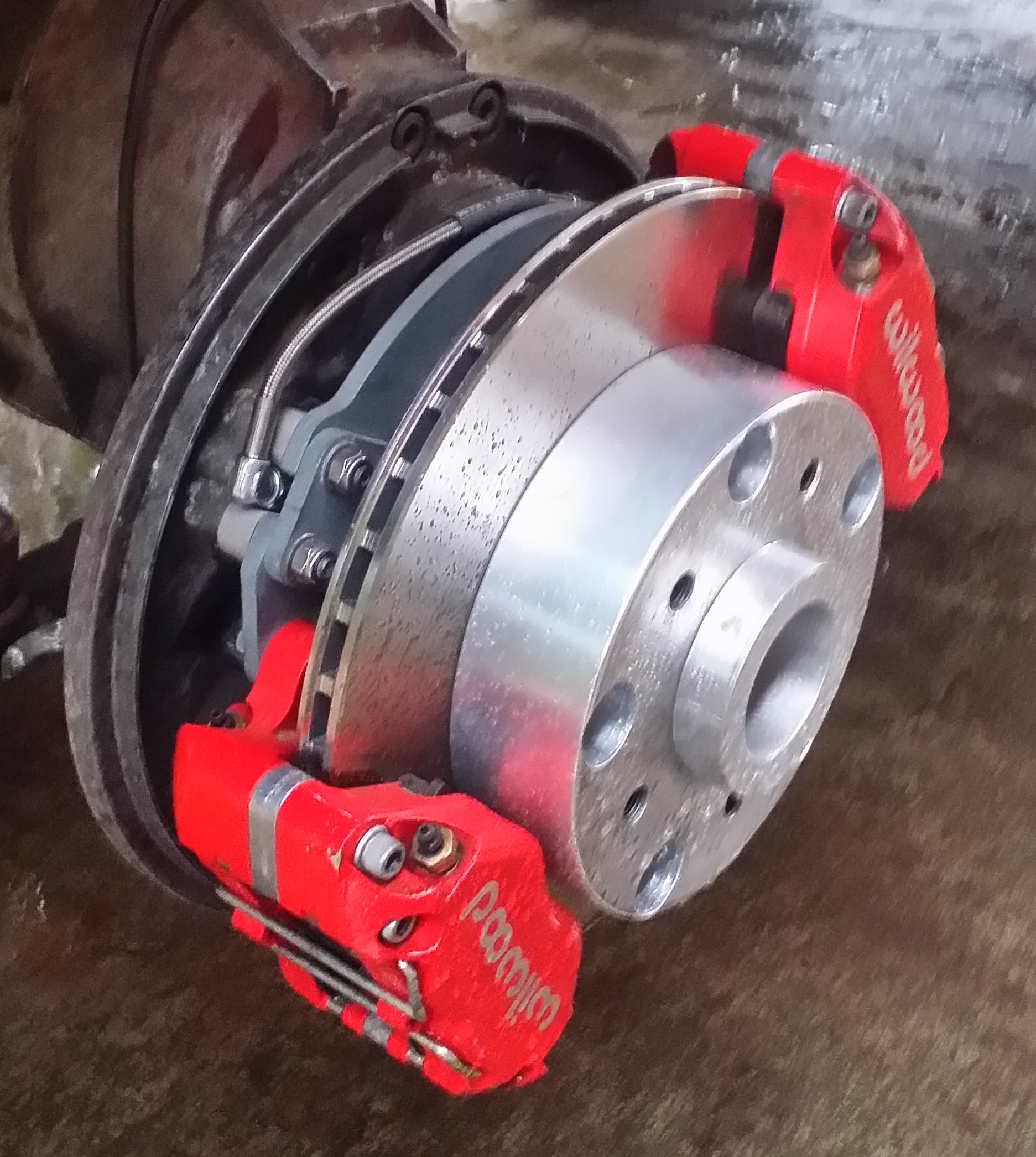

Got the first production batch of vented rotors for the disc brake conversion kits
Vented Disc Brake 22MAR2018.jpg (1.47 MiB) Viewed 27392 times
The thickness increases to 0.640" / 16.2 mm which is 25% thicker - but the weight of the vented disc decreases by about 15%. Original solid discs are 0.510 / 13mm thick.
The existing calipers and brackets work with either by removing the 0.125" thick pad spacer which is used only with the solid discs.
I am offering to exchange the front axle solid discs for the vented ones to all of the kit purchasers at no cost.
Any thoughts/preferences on vented versus solid rotors? I would like to not have to have to stock two different discs going forward...
The TD Pinzgauers used solid discs through their entire production - and the TDs are heavier & faster. Nearly all cars and trucks now use vented discs now though.
