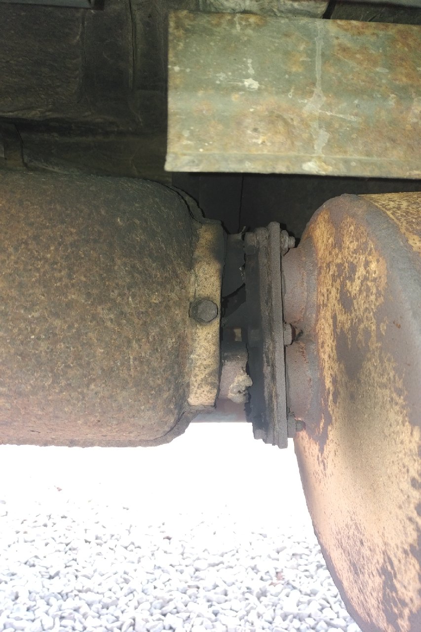

Hi all,
Was cruising through the search options, but not finding what I need. My heat exchanger connections to the muffler have both snapped. Any tips or tricks anyone has used to repair this particular area? I'm considering the cheap flex material used to repair exhaust leaks, but that is usually very temporary. Not crazy about buying a new exchanger either.....
Thanks in advance. I can get pics tonight if anyone is interested.
Dave

by stiffler4444
exchanger flange break.jpg (197.43 KiB) Viewed 6740 times
Re: broken heat xchanger outlets - pic added.....
Posted: Tue Apr 24, 2018 1:21 pm
by rmel
Not a lot of meat there to work with :(
Might be time for a replacement and while
your at it a new SS Muffler. Even if the metal
was not rusted and solid, that looks like a
fatigue crack not sure you can weld or braze to
that with confidence :?
Posted: Tue Apr 24, 2018 1:43 pm
by stiffler4444
rmel wrote: Tue Apr 24, 2018 1:21 pm Not a lot of meat there to work with :(
Ya, I'm going to pull it all apart and see what the condition is of the surrounding steel. There is definitely not enough to band it in any way now that I look at the photo up close. ://
Posted: Tue Apr 24, 2018 2:43 pm
by whitesik
I am going outside my expertise a bit but I have had one of those exchangers torn apart. Perhaps if you could find a pipe whose OD is close to the old ID, one could weld that to the relatively beefy flange then insert into the old pipe to clamp. Actually you could take the pipe all the way to the front flange. that would ensure no leaks elsewhere for exhaust fumes to enter the cabin ventilation.
Posted: Tue Apr 24, 2018 3:30 pm
by stiffler4444
whitesik wrote: Tue Apr 24, 2018 2:43 pm I am going outside my expertise a bit but I have had one of those exchangers torn apart. Perhaps if you could find a pipe whose OD is close to the old ID, one could weld that to the relatively beefy flange then insert into the old pipe to clamp. Actually you could take the pipe all the way to the front flange. that would ensure no leaks elsewhere for exhaust fumes to enter the cabin ventilation.
Nice, thanks for the thoughts and info.
Posted: Tue Apr 24, 2018 3:34 pm
by whitesik
Yes, I took it apart because of significant rust on one side. Although I could not find a good or new exchanger then, I was able to find the half shell that I needed. I cut it apart, cleaned and media blasted it and a friend help to weld the shell back on. The internal fins are cast aluminum around the pipes.
Posted: Tue Apr 24, 2018 3:39 pm
by rmel
Well that makes it a lot more feasible to repair as a lot more pipe is exposed to work with.
But that's some welding skills I don't have :wink: so I'd be apt to just get a decent replacement.
Posted: Wed Apr 25, 2018 1:17 pm
by pcolette
I have a set of the pipes from inside a heat exchanger with the flanges welded on and in good condition. The shell had rusted out and the aluminum fins were bad so were removed. I made a temorary bracket to help support the pipes from the original heat exchanger mount above.
I'd be willing to sell it if this would help you out.
Posted: Thu Apr 26, 2018 10:11 am
by stiffler4444
pcolette wrote: Wed Apr 25, 2018 1:17 pm I have a set of the pipes from inside a heat exchanger with the flanges welded on and in good condition. The shell had rusted out and the aluminum fins were bad so were removed. I made a temorary bracket to help support the pipes from the original heat exchanger mount above.
Thanks Paul. We will see what happens when I take it off this weekend. I may be in touch......
