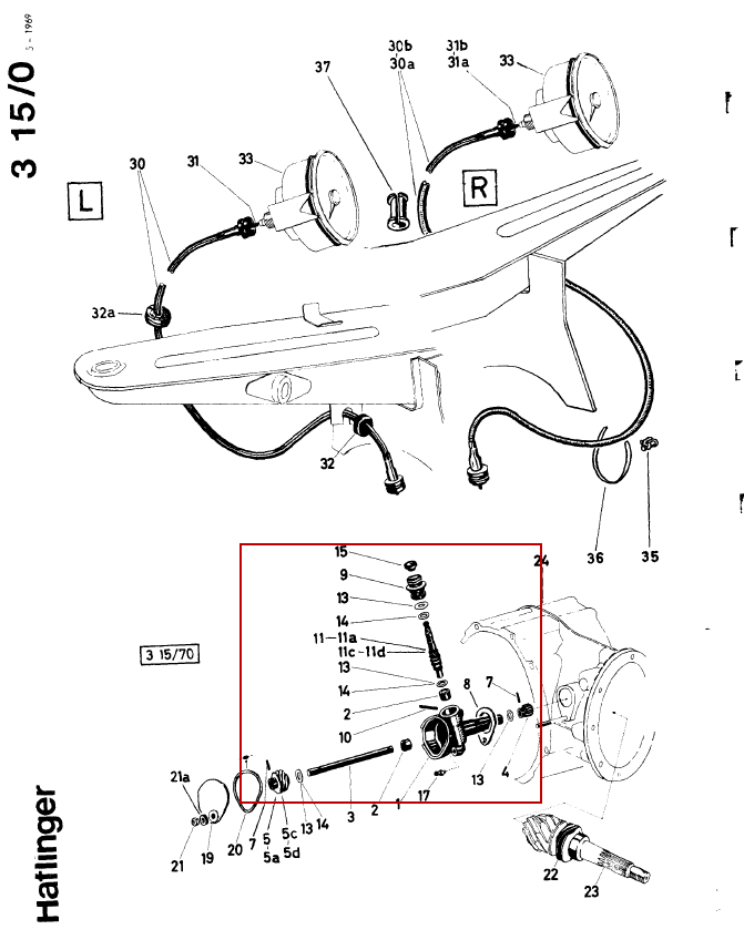

My guess would be worn/busted internal plastic gear.
You could try removing end attached to front diff and try rotating slowly with a drill and see if it still does it - if so, then obviously issue is in the speedo, if not then if could be the gears in the diff.
I used the Pinz speedo repair in the tech section to fix mine - removing the outer ring just takes 10-15 mins of very slow and steady work
