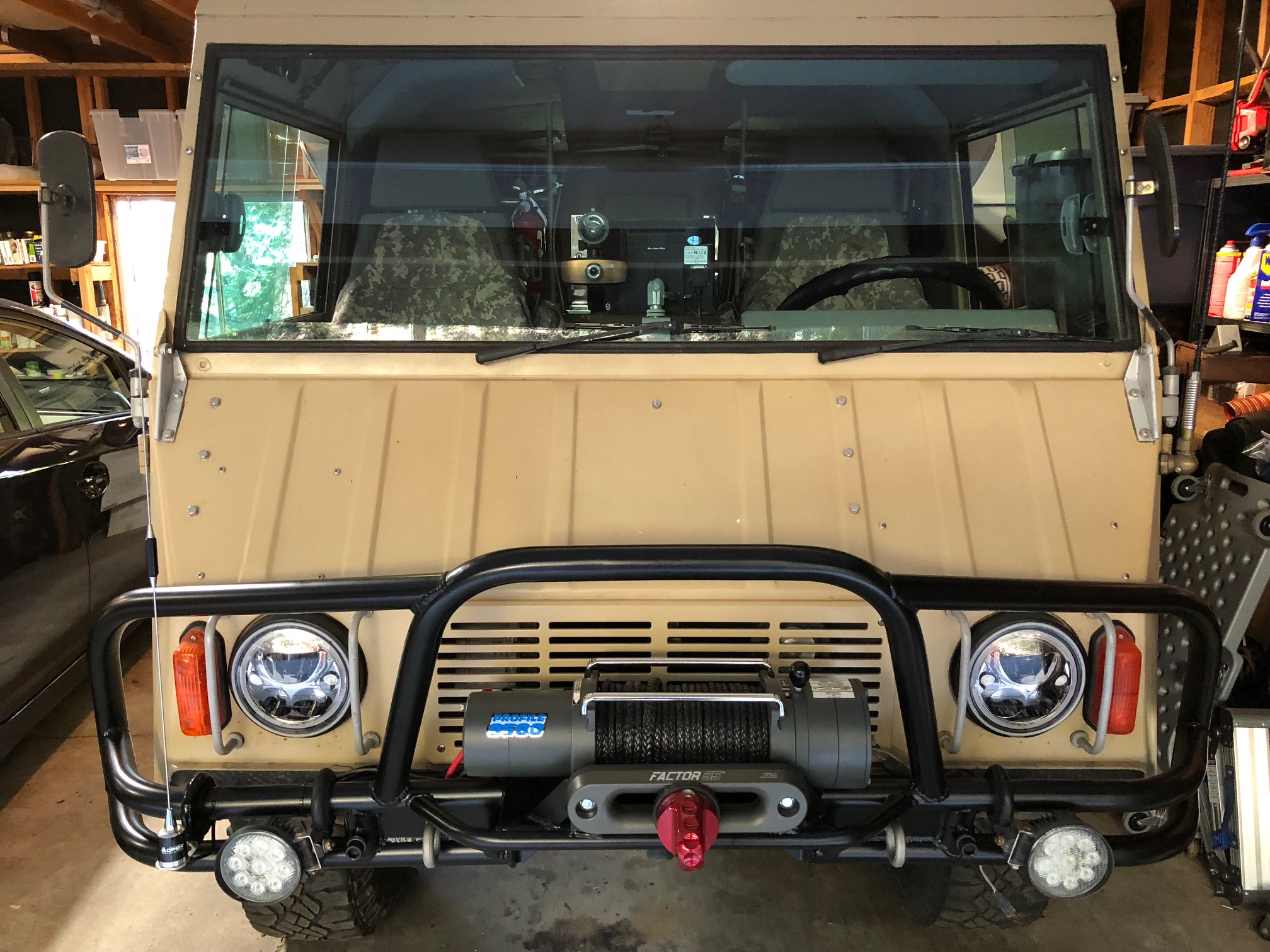

Winch installed, thought I would just capture some installation decisions I made.
First, a plug to Fatfab, worked remotely with Andre via Facebook messenger on the design.
Came out fantastic.

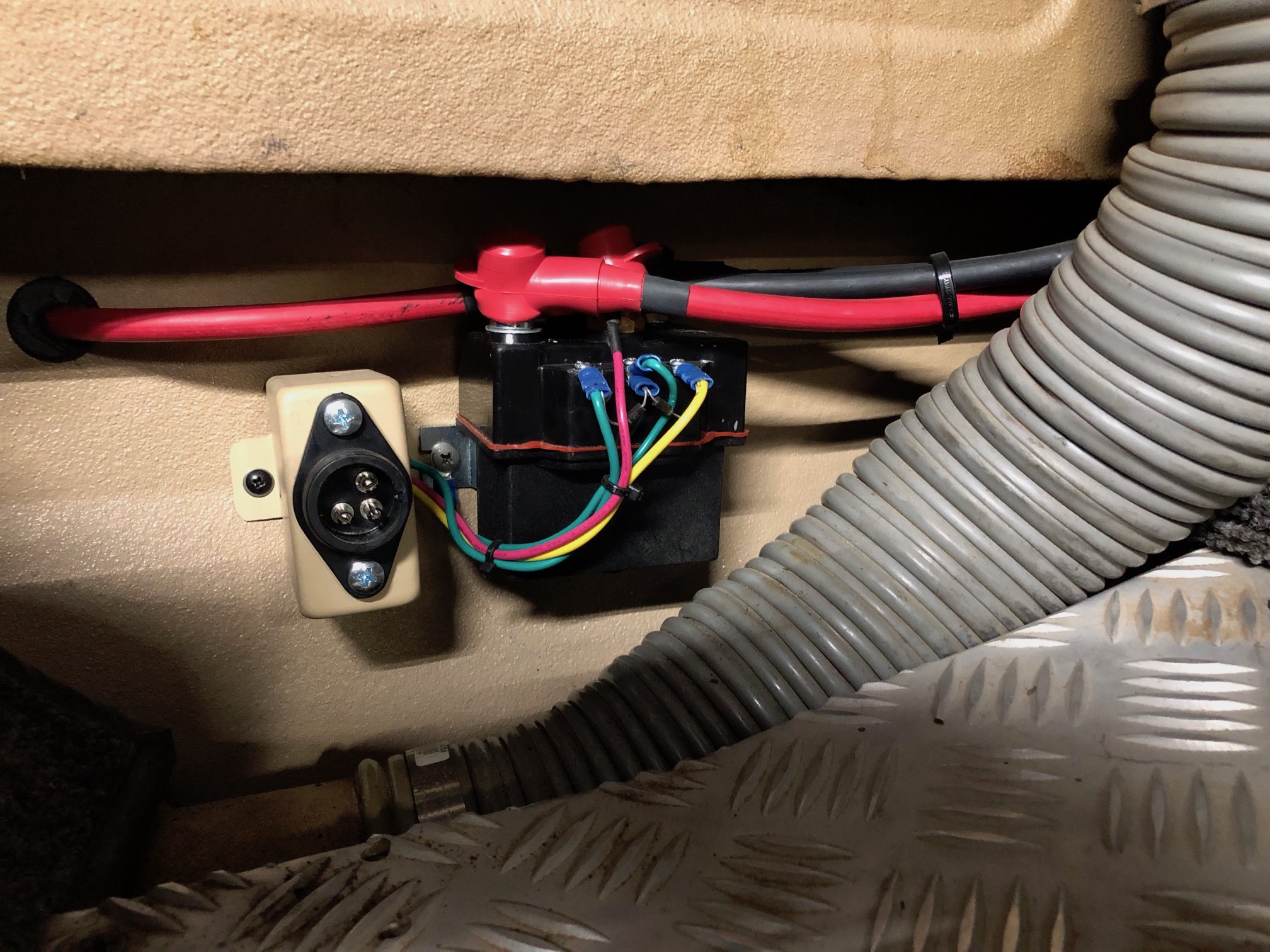

With respect to the installation, I decided to remote locate the Controller, and include a

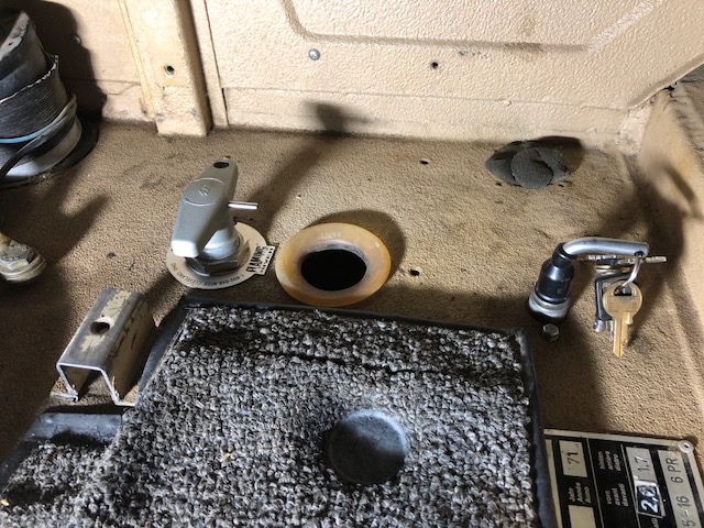

safety cut-off switch off of the +24V terminal of the battery. Thinking here is that if for some
reason there was a short or a stuck relay I could easily override that with the cut-off switch.
The Switch is water-proof, from FlammingRIver, located behind drivers seat.
Most Winch controller heads are physically large and if mounted on the winch are vulnerable
to the weather, getting whacked, not to mention they look ugly and don't help the airflow. I
decided to replace the controller entirely with a EV (Electrical Vehicle) Contactor (from EVwest).
This Contactor replaces four relays in a very compact space (becoming more popular as a Winch
controller). I remotely located the unit in the Passengers foot-well just under the ledge of the air
tunnel. I found an aluminum box to mount the connector for the hand-held remote control which
fits next to the contactor. If you go this route it's always a good idea to include "fly-back" diodes
to prevent large voltage spikes when a relay is turned off, also helps the turn-off time of the
relays. Diodes can be barley seen below, but they are there.

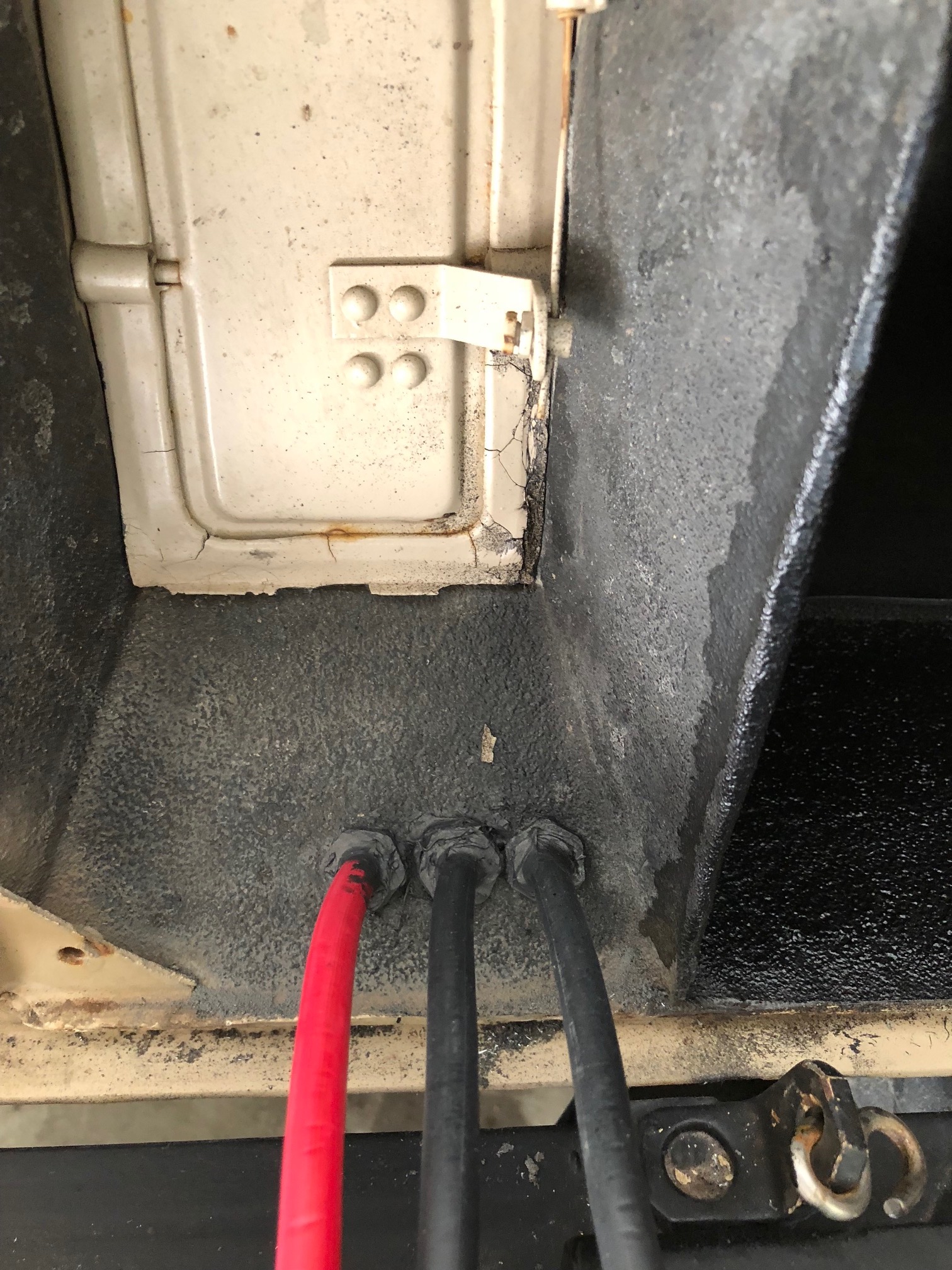

The power leads to the Winch exit from the Contactor to 3 holes drilled and grommet just under
the cabin air intake. I used 4 AWG wires throughout -- sufficient for 24V and a easier to work with.
Red lead connects to the Armature of the motor, 2 black leads to F1 and F2 of the field winding.

I also replaced the steel rope with synthetic; safer, lighter, stronger. The Hawse, and Link are from
Factor 55. A very robust Hawse 1.5" thick with an entry relief radius more than typical for less wear
and tear on the Synthetic rope. Rope is from MasterPull, 8MM rated at 21,700 lbs.
Re: Winch Wiring
Love it and thanks for posting the shots and details!
