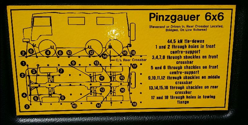

Lewis, the front tow pin is fine to pull by, but not to anchor to on a deck. On my old 716, I had (presized) chains w/ j hooks that allowed me to quickly hook up one end of the truck and only need to tension the other end.
Later 716 and my 718 had a bunch of tiedown points... enough to baffle any driver.
Remember, a majority of cars on the road in the US are mostly under 3500 lbs, a wider stance than of a Pinz , under 5' high and a lot less suspension travel, so the tire straps are a simple, quick solution for a tow truck driver for a relatively short drive. And for other vehicles they have a complement J , T and chain hooks for anchoring the frame down.

Re: Loading a Pinzgauer
That diagram is awesome and in English!,David Dunn wrote: Sat Aug 04, 2018 12:42 pm There is a BIG difference between hauling a Pinz on a rollback flatbed and on a trailer and using axle or tire straps. Both leave the suspension uncompressed and able to move up and down unrestricted with road condition. A rollback truck weighs a minimum of 11,000 lbs or more, and the momentum of the bouncing 4300 lbs Pinz will usually not be felt, but on a 2000lb +/- trailer, the trailer actually can become a pogo stick, reacting to momentum of the Pinz suspension.
Later 716 and my 718 had a bunch of tiedown points... enough to baffle any driver.![]()
Tire straps are the future for the towing industry, I saw them fazed in about 15-20 years ago when I was working in Europe and now pretty much the industry standard here in the US. NJ where I live/work has strict legislation on a minimum of 4 tie down points for vehicles Not including the winch and for pulling up onto the bed big J's through the body mounts is definitely the best solution, thanks
I think that the diagram is from a British made, ATL 718K might have something to do with it being in English.Lewis wrote: Sun Aug 05, 2018 10:35 pm
I could see a trailer being a much bigger issue for the Pinzgauer than a rollback and like you said even our smallest trucks don't really have an issue with big and bouncy!
