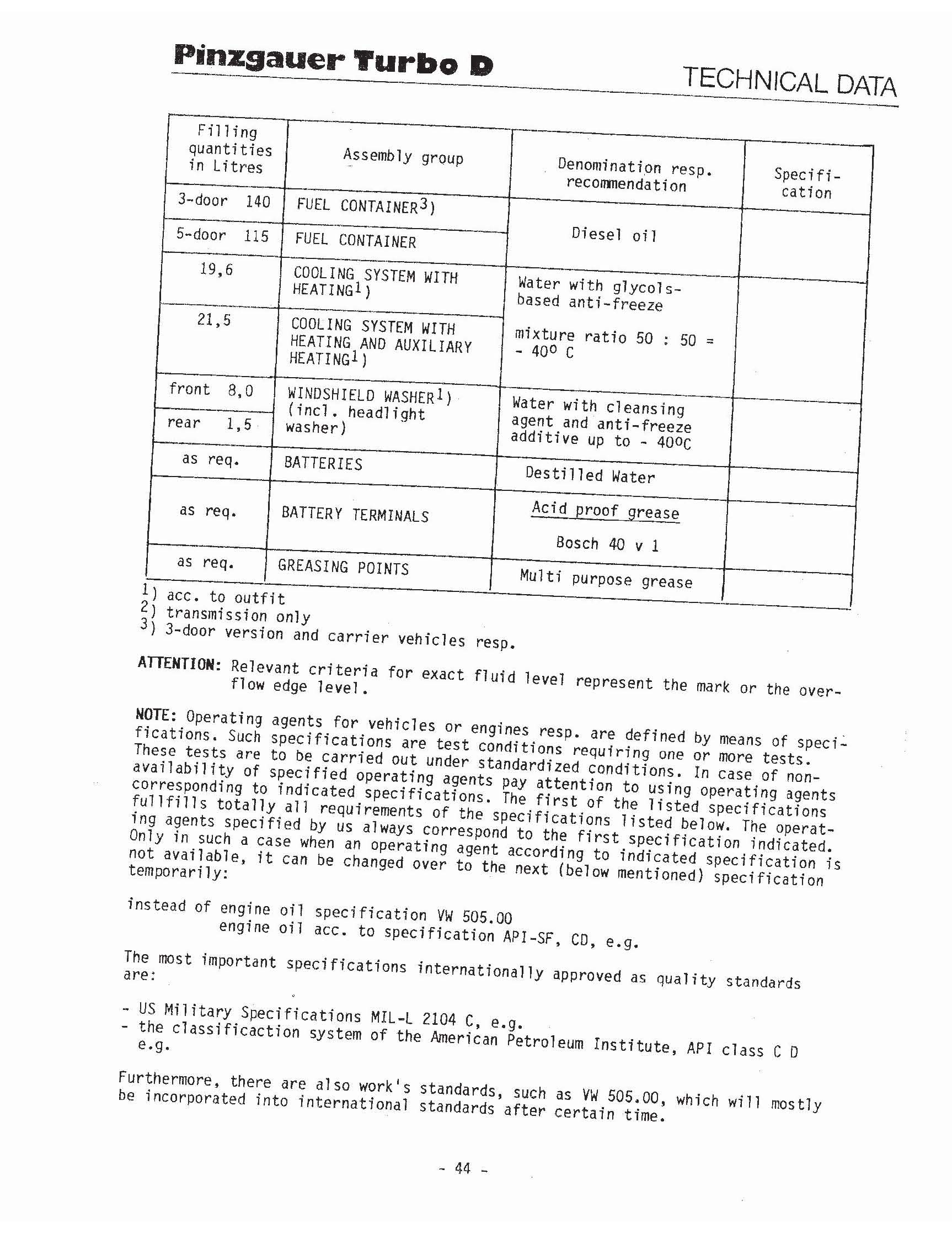

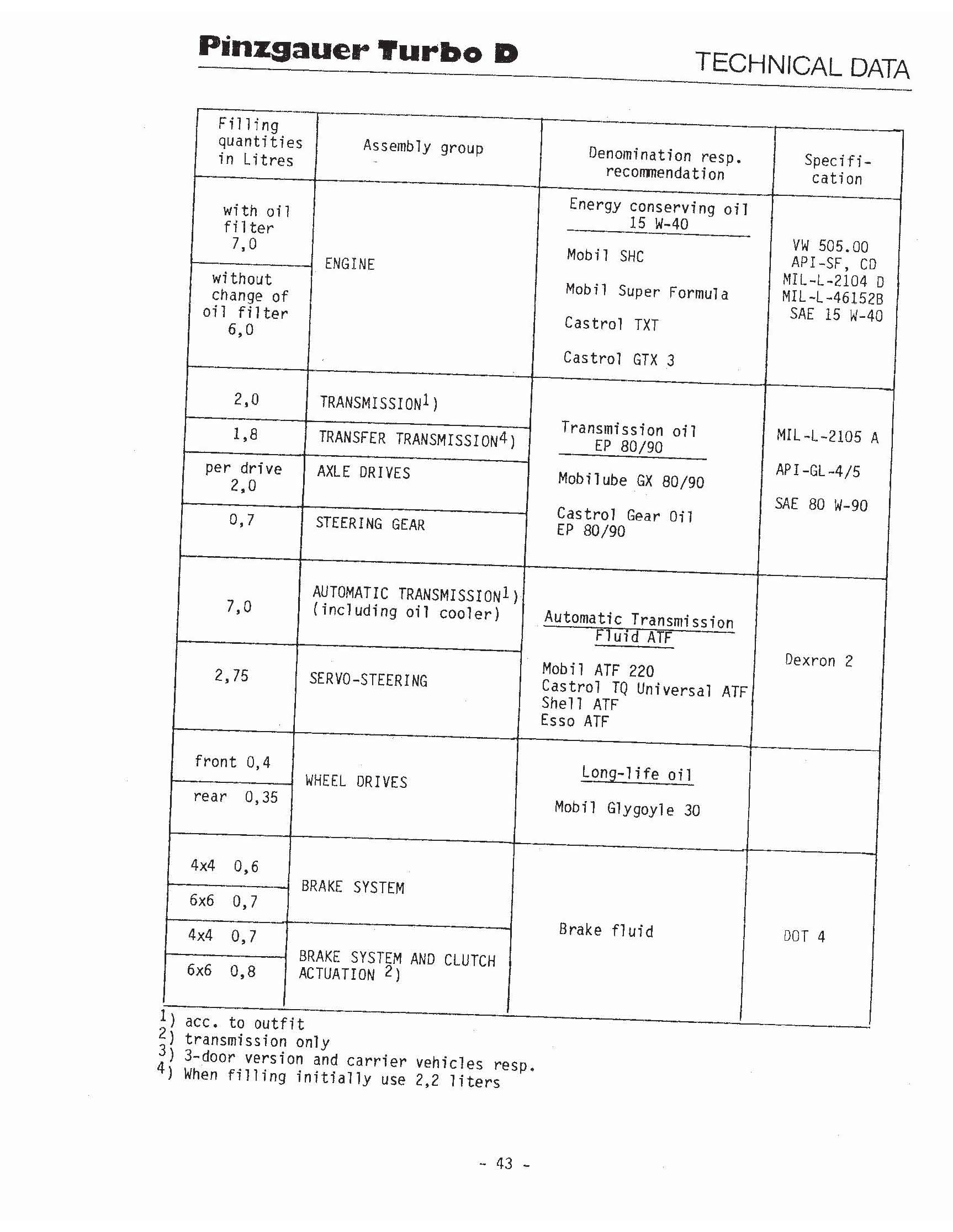

Hi all, I'm wondering if there is a list somewhere of the various fluid capacities and recommended types for the mechanicals on the TD 716/18? Motor oil, how many quarts, gear box, etc.?

Here are a couple pages from a 716 owners manual.
Somewhere in the TD forum is a discussion on substitute for the wheel drives
716Owner manual tech sec_Page_09.jpg (241.01 KiB) Viewed 11381 times
716Owner manual tech sec_Page_10.jpg (336.63 KiB) Viewed 11381 times
