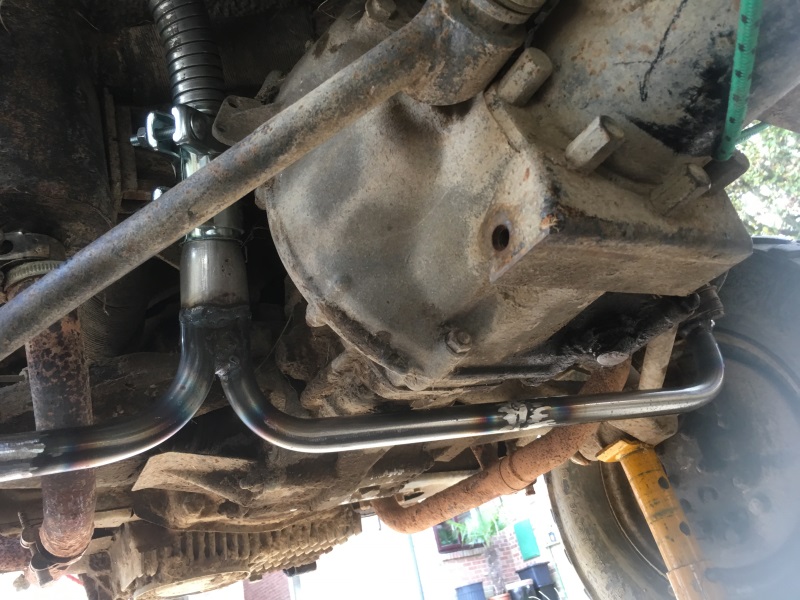

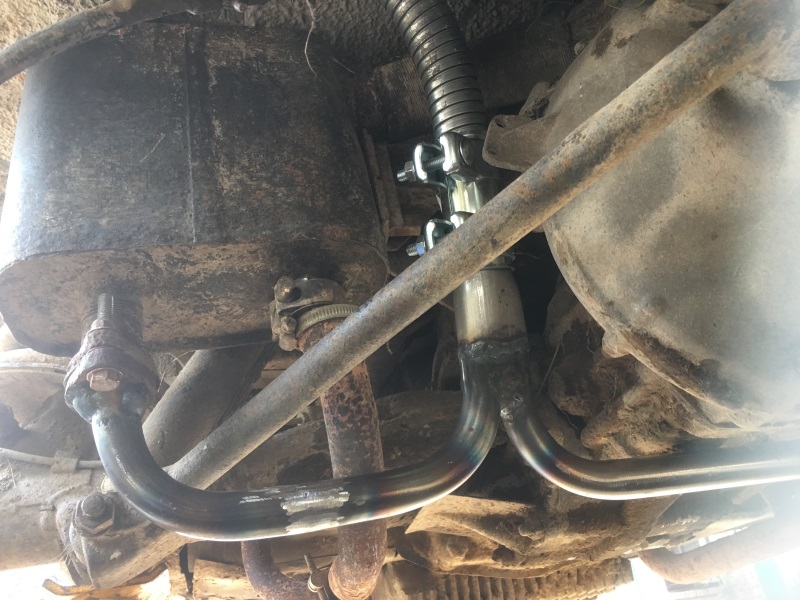

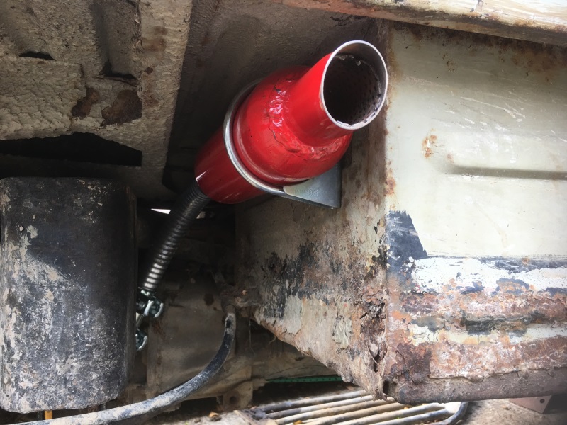

I built a "cherry bomb" silencer for Lurch - it's a bit loud as it is basically a straight through pipe, but if you are looking for something quite your biggest issue will be to find a silencer which has less than a 2 inch diameter pipes in and out. Haflingers have 1.25" pipes from the manifolds and the exit pipe on the standard silencer box is less than that.
Most usual reason for popping and backfiring is due to air leaks and have too rich a mixture. i.e. there is still some unburnt fuel in the exhaust gas as it leaves the cylinder, then it sucks in some more fresh air when you take your foot off the throttle. The gas mixture then becomes correct of it to ignite and it goes "bang"!
John
