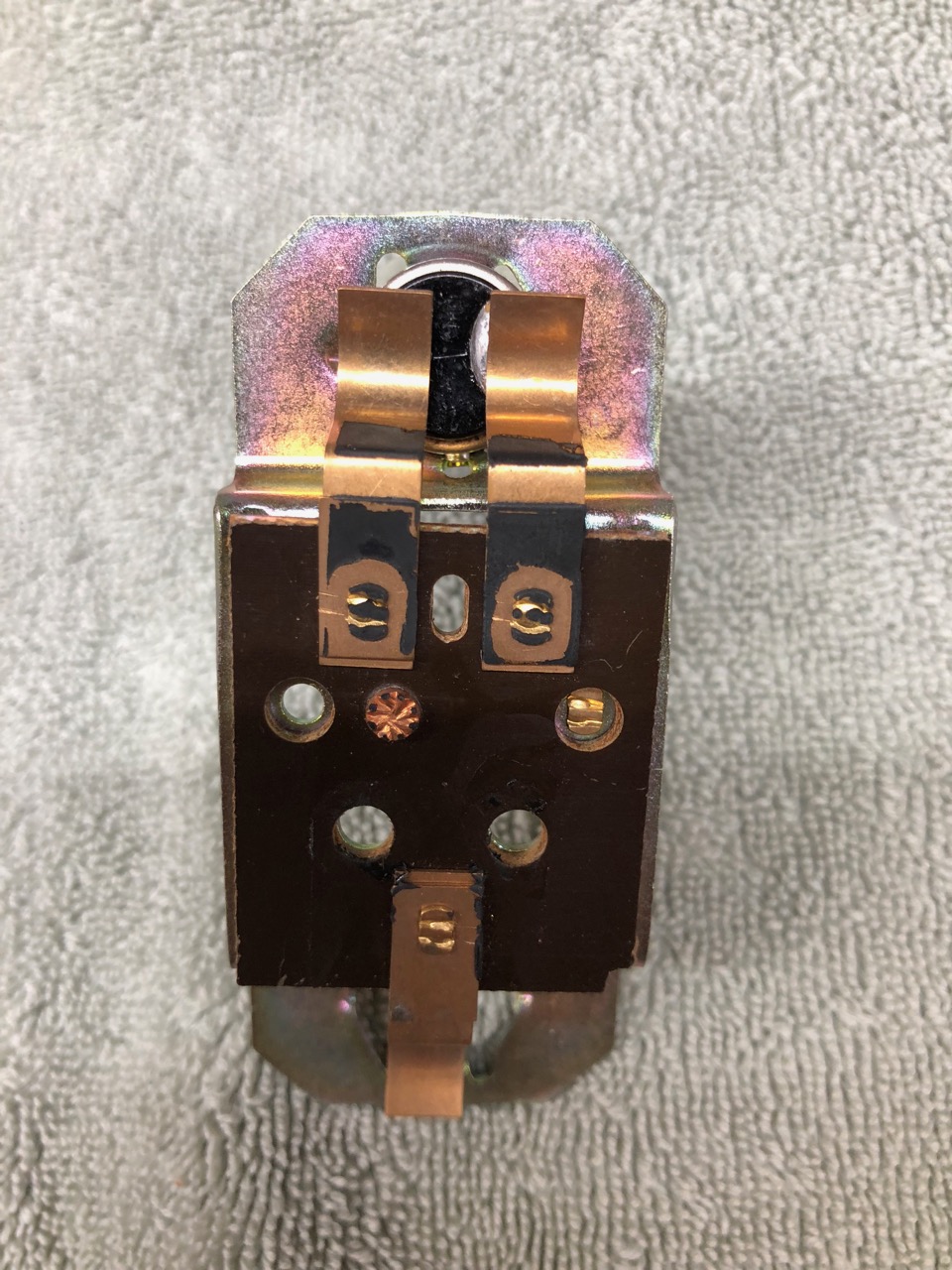

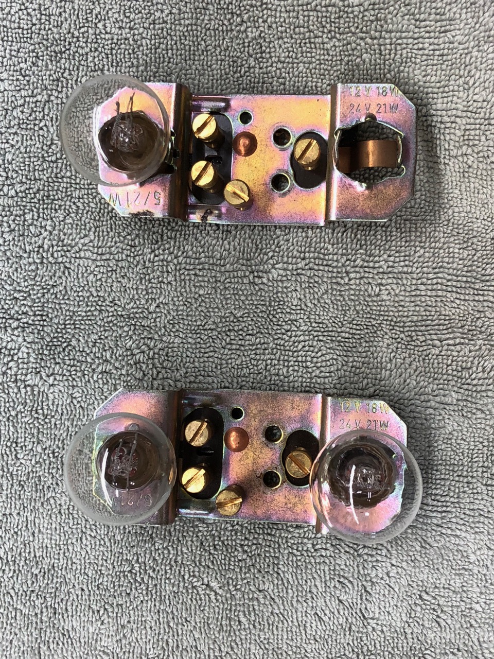

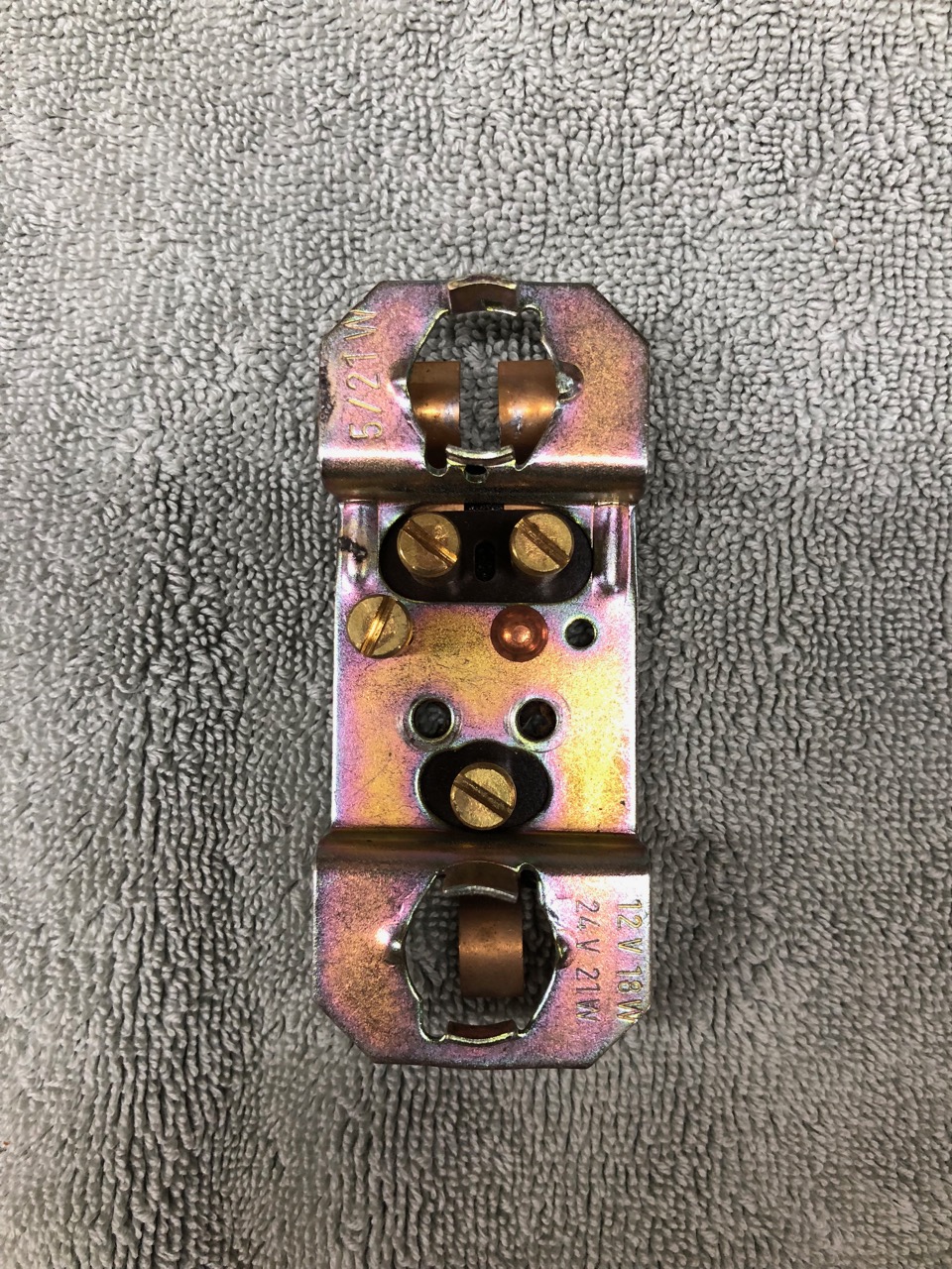

Here are a few photos of the conversion sockets that Steyr used to have for the Pinzgauers to convert from single filament to dual so that you would have a true 3 function tail light (tail, brake and turn) with the tail and brake using a 5W/21W dual filament bulb. You still needed to re-purpose the pink wire in the tail lamp to add the seperate braking circuit. The pink wire was originally for the blackout light and likely is not connected to anything in the tail light. I'm still looking for the full instructions on this.
SAV no longer is able to get the conversion sockets but I do have a set available from when I added alternate tail lights.
