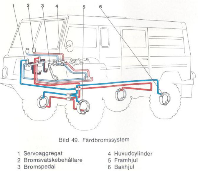

Brake servos should be effecting front to back, not side to side.
Possible the mech didn’t understand the bleeding procedure for the front and back interconnected lines. Each back wheel brake activates one of the wheel cylinders on the opposite front tire.

Based on the brake circuit diagram for a TGB11, if one servo was weak there would be differential braking performance on the rear wheels only, the fronts would stay balanced. This might cause the car to drag to one side under braking?
TGB11 Brake Circuit.JPG (53.96 KiB) Viewed 22194 times

Thanks to robber_and_custard & dokatd for valuable information/diagram.
Mechanic aware of these points and I had given him a full workshop manual (in English!).
