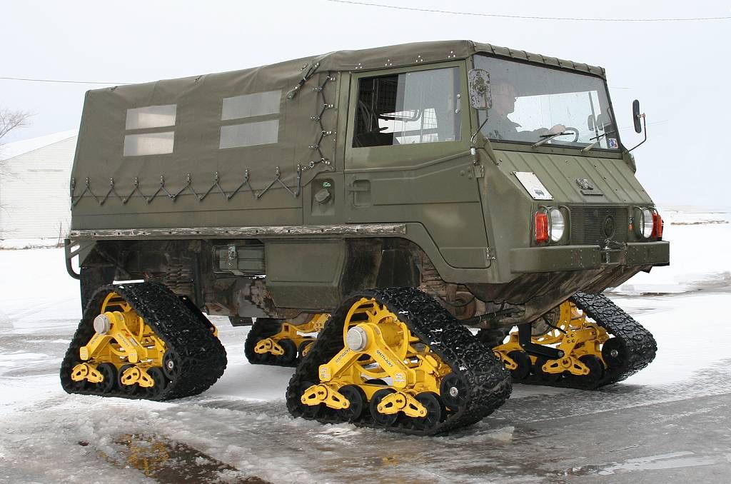

Has any of you gone as far as that with a Pinz:
https://expeditionportal.com/mattracks- ... term-test/

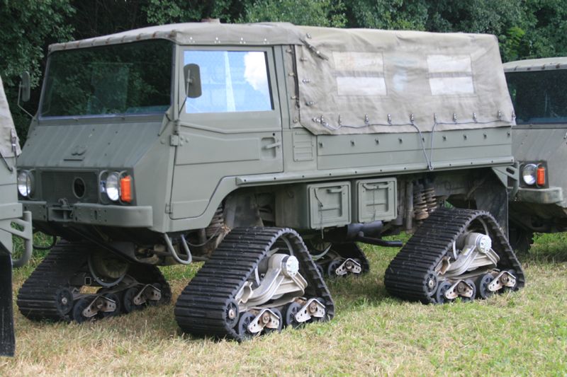

Not me, but apparently a few have...

Nice ! Where are those pictures taken from ?

Posted: Sat Dec 15, 2018 12:36 pm
by McCall Pinz
FWIW- A friend had Mattracks on his Pinz here and we messed around with them a few years ago. The turning radius is REALLY big with them and we got stuck more than a few times on trails we'd driven a few months earlier. Power steering would have helped. Also, watch the cross slopes. Going straight up or down is easy, but even mild side slopes are tricky.
