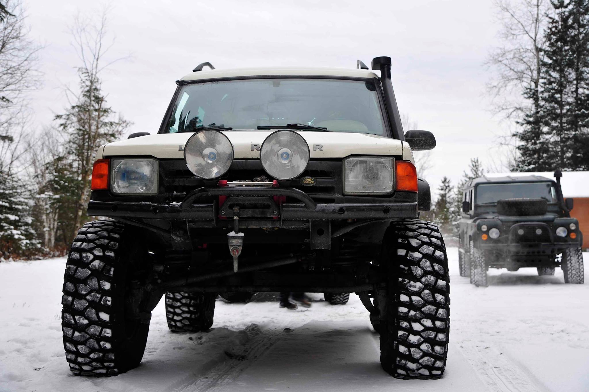

I have a Land Rover discovery on volvo portal axles .. I use it for extreme rock crawling and the way I set it up with the vacuum that I have set up it does not work all the time.. I have a vacuum gauge and it says it’s getting enough vacuum but for some reason it won’t always engage.. I have taken it appart and change the rubber seal and changed the cover verified the
Fork inside and everything seems to be in working order... since it’s not all original I guess it could be the valve and reservoir I’m using that does not keep the pressure constantly on the fork...I’ll see if I can post pics later on to show you..
Open to any system that will work..

- 919027B4-3880-4D41-AE3F-A6E90E01C07F.jpeg (420.61 KiB) Viewed 11004 times
Test on picture

since I can’t reach them I’m thinking of going with an electric vacuum pump and a reservoir like a fellow on this board said but I would like to know what kind of reservoir he was using.. here is what i have for a set up..
It’s connected to the engine vacuum and I have a small reservoir from a disco2 Land Rover and a selonoid valve that’s activated from a switch inside .. sometimes it does not engage all the time and I think the vacuum could be the problem..
