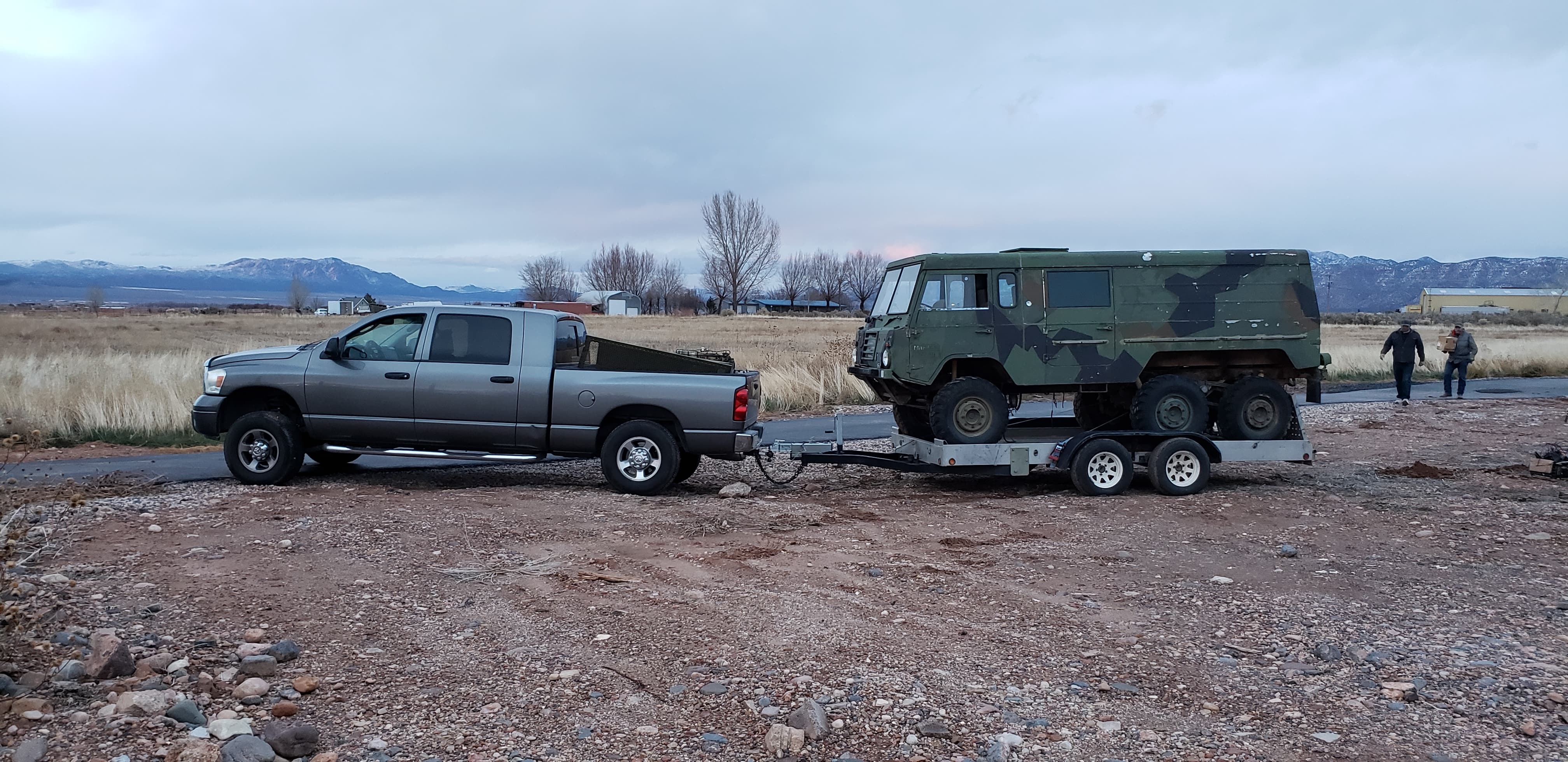

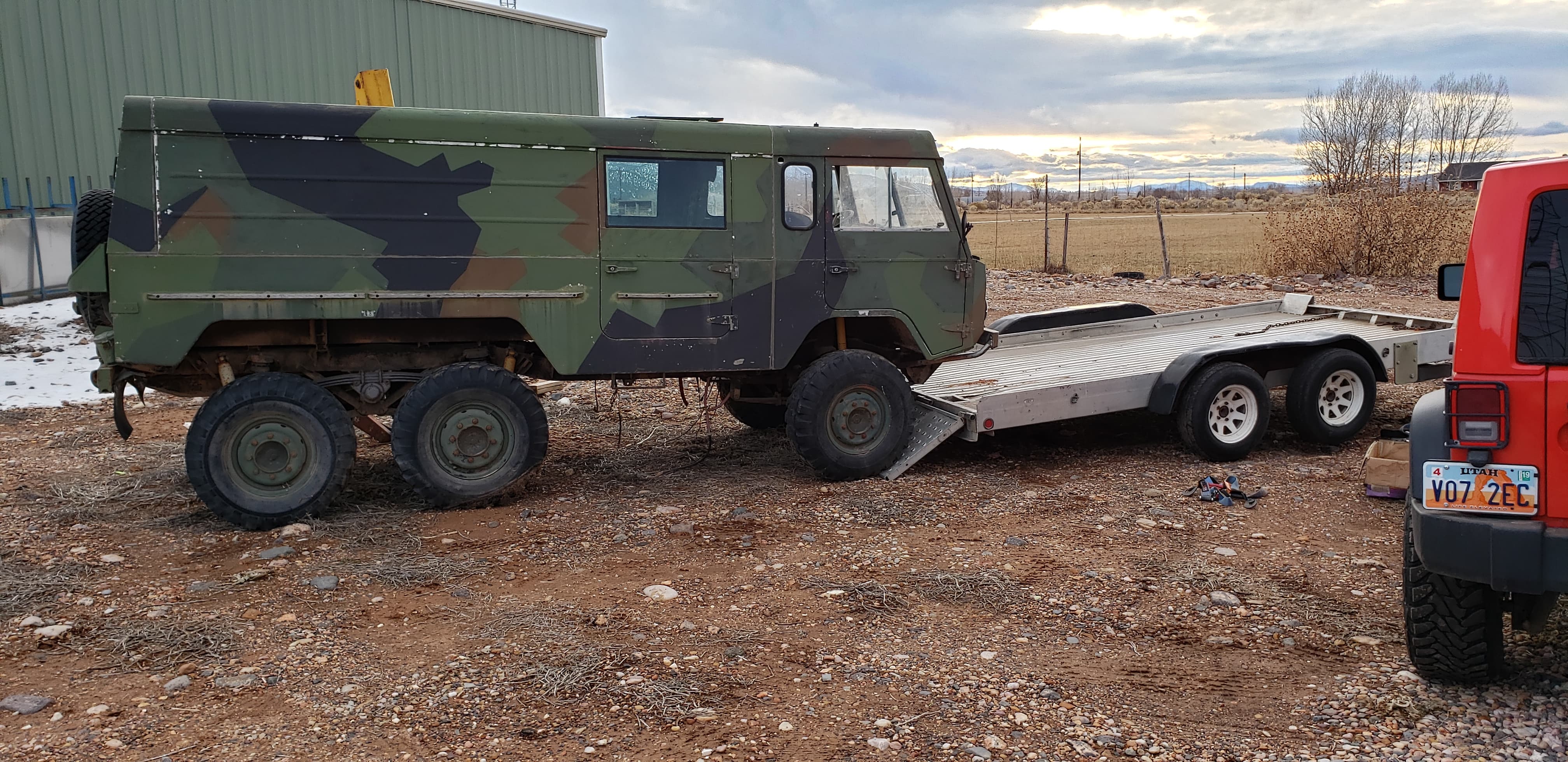

Hey Guys!
I've never been great at this but I figured I will probably need some help from you guys during this build!
I am starting my first ever build thread!!
Here it is my 1975 Volvo C304 aluminum body 6x6. I ultimately want to build an offroad go anywhere camping vehicle that I can maybe touch 15-19mpg and 65 cruise speed (hopefully more)
So far I have decided I want to do a few updating mods like power steering(either electric or hydraulic), Disc brakes, possibly do a 4link with the suspension and coil overs. I would also like to change the vacuum actuators on the lockers to air powered. Right now what I am trying to decide on is which power plant I will be using.
Some of the top candidates I am thinking right now is...
Isuzu 4bd1t
Mercedes OM648
Cummins 6bt (I dont think this will fit)
Cummins R2.8 (new Crate motor)
Let me know your guys thoughts!

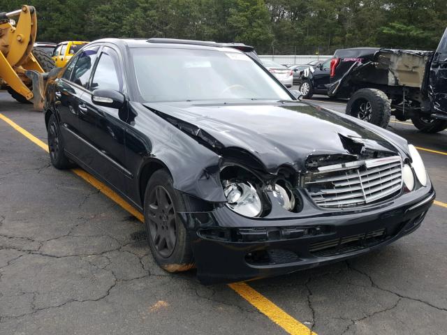

So I bought a wrecked 2005 Mercedes E 320 CDI
Its got the OM648 mercedes engine
To get that cruise speed I plan to swap the R&P to the T-Max 4x4 Malaysia they will give me a 5.32 axle ratio
The 722.6 transmission has an OD gear of .83
and 37 or 38" tires should give me a 65mph@2600 rpm
I plan to swap to the W5A580 version of the 722.6 with the 4x4 and I would like to adapt an LT230 xfer case.
The hard part is going to be a stand alone trans controller and stand alone ecu. (gotta love the electronics)
Those R&P are $500 per axle so not too bad.
Love that cummins 2.8! I should be much less in my swap than the 9k buy in price of that bad boy... Otherwise I would have probably chose that. Car will arrive in a couple of weeks ill take more pictures then!

Jim how did the om617A turn out? Do you think the om648 will fit just fine? It seems wide with that intake but I have been preparing myself to have to do a custom intake

A: I did not get measurements of the motor before I bought the wrecked E 320... I just assumed that they were the same or very close in size to the 606 that I know has already been swapped (so I hope it does fit.. or if not I will have to make it fit)
B: Once I get it to fit I am concerned about the electronics on this engine and the fact that it is a bit rare and not a huge aftermarket base and not a huge following or help on tweaking it to run. (Might have to go with a completely stand alone computer and that could get costly and put a major damper on the whole project)
If any of you know a Mercedes guru who would have a good insight on how to setup the electronics on this motor please let me know!
