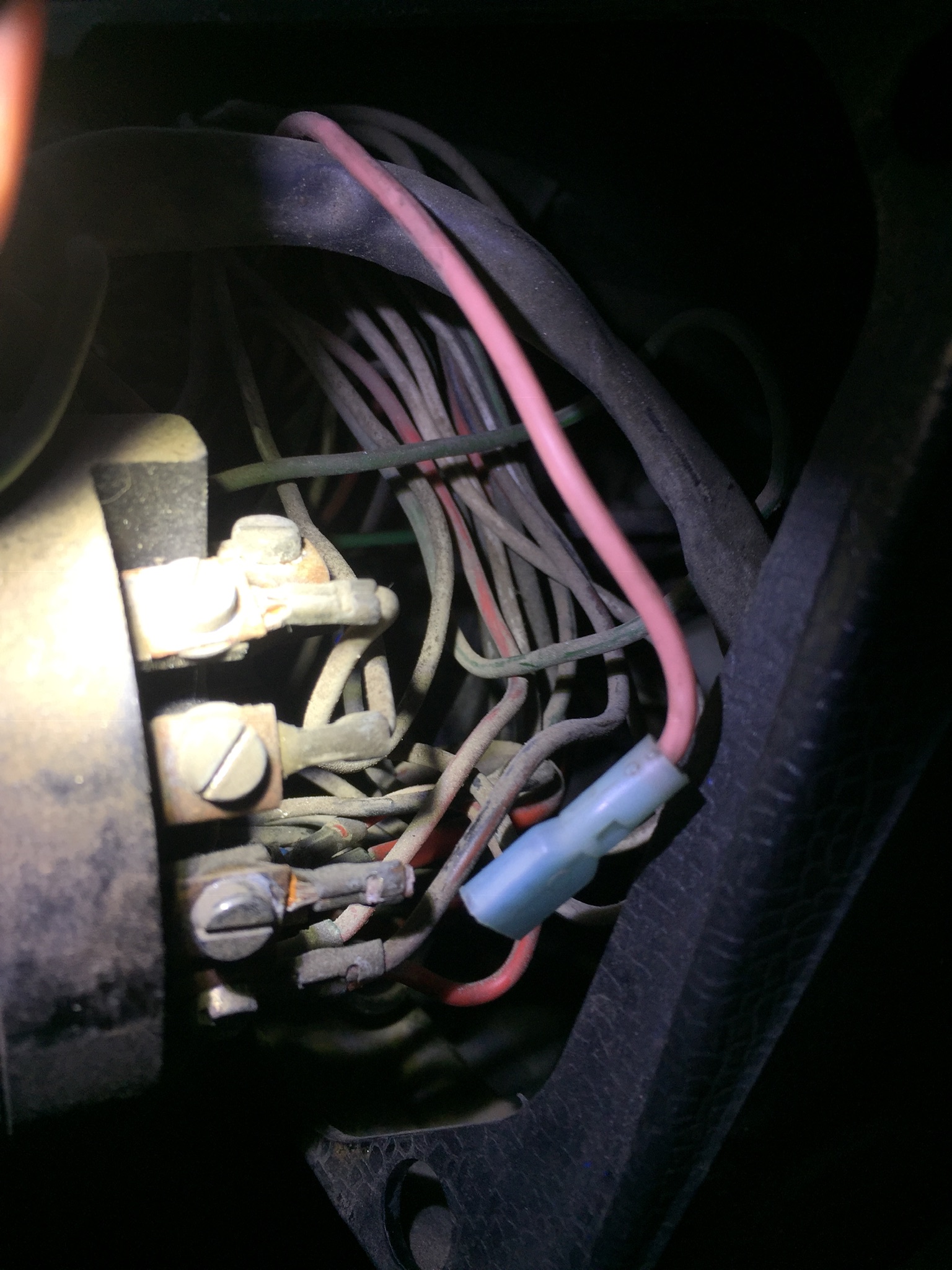

And just for giggles, here is a shot of the headlight switch on the dash. There is a pink wire in he pick that has a spade connector on it. I don’t think that connector is factory. It is coming from the #8 circuit breaker. You can see a connector on the switch just to the left of the spade. It’s the 3rd one down from the top as seen in the pic. The wire that went to this connector appears to be pink(ish) and has broken/been cut flush.
Any insight as to whether these two are related, or is the wire shown for something else entirely and not connected to the light switch.
At one point this #8 breaker was popped. I don’t know if it was that way when I purchased, or if it popped somewhere between then and when I started mucking about with stuff. I just remember noticing it, resetting it, and nothing has changed since.

The pink wire was orginally connected to terminal 58 (as I recall) on the light switch and was used for the blackout lights when those were installed. A common modification to the Pinz's was to disconnect the pink wire from terminal 58 and then splice an extension wire to reach over to the brake light switch on the back side (towards the front) of the master brake cylinder. There is more to it than just that and if you search this forum for brake light mod you should be able to find the thread. The purpose of the mod was to change the original Swiss Pinz brake lights from using the amber lens and a single circuit to using the conventional red for the brake lights with dual filament bulbs.

pcolette wrote: Tue Dec 04, 2018 6:26 pm The pink wire was orginally connected to terminal 58 (as I recall) on the light switch and was used for the blackout lights when those were installed. A common modification to the Pinz's was to disconnect the pink wire from terminal 58 and then splice an extension wire to reach over to the brake light switch on the back side (towards the front) of the master brake cylinder. There is more to it than just that and if you search this forum for brake light mod you should be able to find the thread. The purpose of the mod was to change the original Swiss Pinz brake lights from using the amber lens and a single circuit to using the conventional red for the brake lights with dual filament bulbs.
