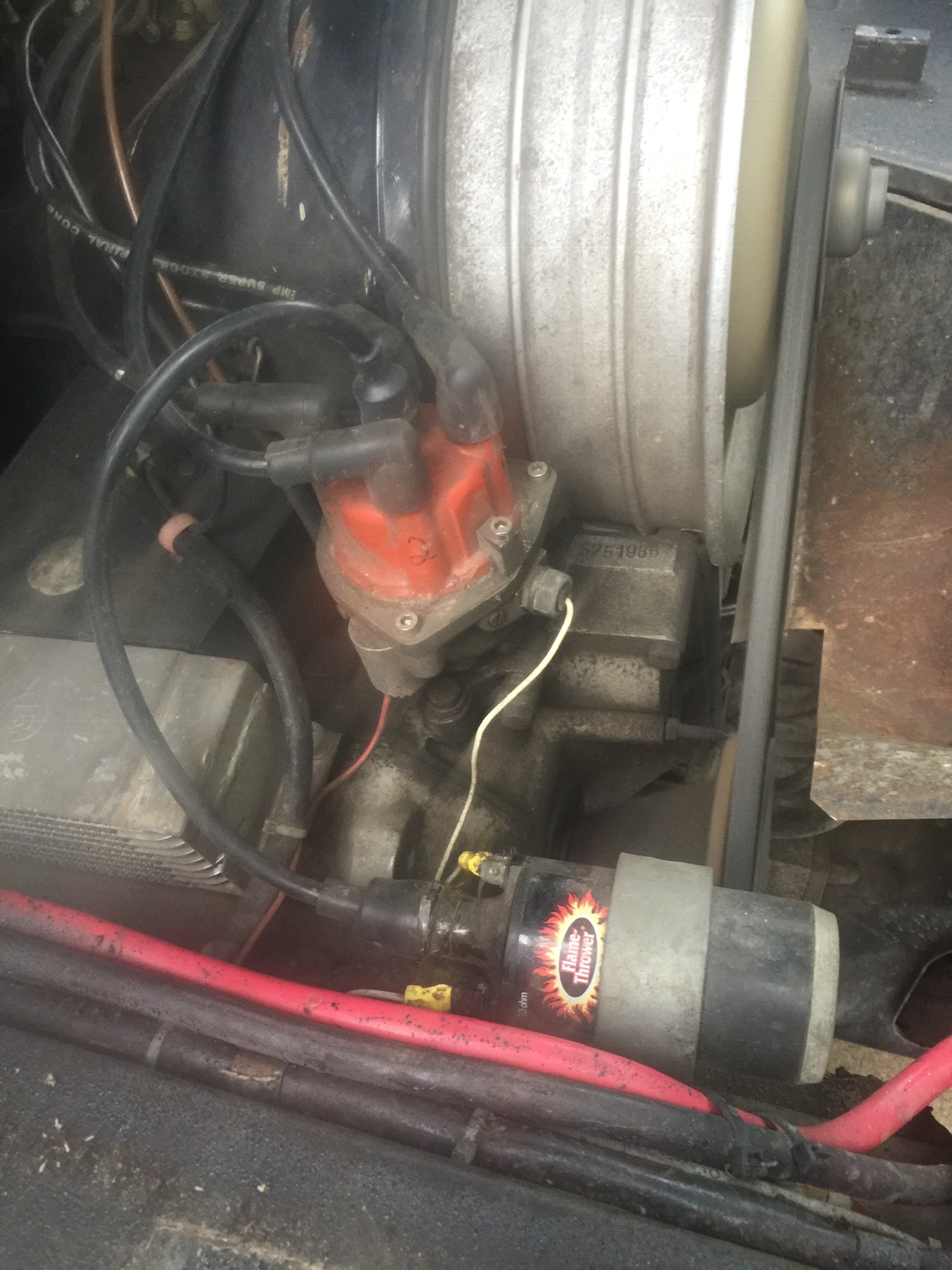

Success! Sort of?
I decided to dig into this a bit more today. Checked the fuel shutoff solenoids and all had 24-ish volts and all made nice clicky noises when reconnecting. Plug wires all seemed secure and in good condition, at both ends. Coil had about 23-ish volts when cranking and 18 volts running at idle. The dizzy cap is sealed with silicone and I didn’t mess with it at this point. My rpm module, based on its blinking light when key on and the voltage measurements I got is supposedly good. I jumpered it anyway and went for a ride. Ran like a scalded dog. Well as good as a weak-kneed 4-cylinder scalded dog can run.
Now, was that module bad in spite of it checking good, or did my fat-fingered fumbling around with the electricy bits solve a bad connection somewhere? I know I can just reconnect the module and go for a ride, but I’m done for the day so I’m just doing some arm-chair quarterbacking at the moment.
Oh yeah, pic for attention which seems to be the stupid habit on Facebook these days.....
Dizzy Pic

I took out the 4500 limiter a few years ago, I would wager that most on the forum have, and I have not missed it once. Never had that particular issue come back. My issue would come and go, I think as the module ages, it starts to fail but not all at once.
BTW - some people have had problems with the flamethrower coil, might be something to look into

I’m wondering if someone far. More knowledgeable than I might take a closer look at this last photo I posted. Obviously there’s the distributor and coil, and on the other side of the engine plug wires with normal rubber boots on the ends vs what EI sells with their kits. I’m assuming this one came from SAV. But....
It was my understanding that the civilian Pertronix kit used either the original points/condenser or the Pertronix “igniter”. Now....
If you look at the photo to the left you see what looks like a brown wire or tube. What this is is a vacuum line that runs from the drivers side of the engine and pretty sure it’s going to the distributor. I’ll have to pop the engine cover to verify exactly where it does terminate because I didn’t pay much attention to it until researching the ignition system tonight, which got me to wondering. Is there some form of the Pertronix kit that used vacuum advance? Is this even a Pertronix system?

The brown plastic tube is a vacuum line that runs from a fitting on the driver's side of the engine to a fitting on the underside of the distributor. It is not a vacuum advance. It’s purpose was to pull any buildup of moisture out of the distributor.
The civilian kits came from 3 or more sources and evolved over the years. Some came with the Pertronix igniter and some did not. When you pull the distributor cap, you'll have a better understanding of what you have.

pcolette wrote: Sat Jan 19, 2019 3:04 am The brown plastic tube is a vacuum line that runs from a fitting on the driver's side of the engine to a fitting on the underside of the distributor. It is not a vacuum advance. It’s purpose was to pull any buildup of moisture out of the distributor.
Thanks a bunch. I remember the tube attaching pretty low on the dizzy. Right now it’s running well, and I have a number of things I want to address, so prioritizing is difficult. I have a brand new Tuff River top sitting in my garage I need to get on, I think my shocks could stand being replaced but it seems neither SAV or EI is stocking those Doetsch replacements (though I’ve not asked them either), I have a heater I need to install, and a slew of little things to check into.
