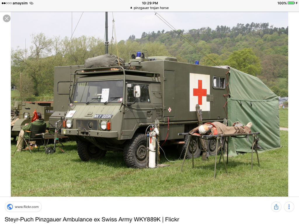

by one2many
I just stumbled across this pic of said cab mounted roof rack so I thought I'd add it.
