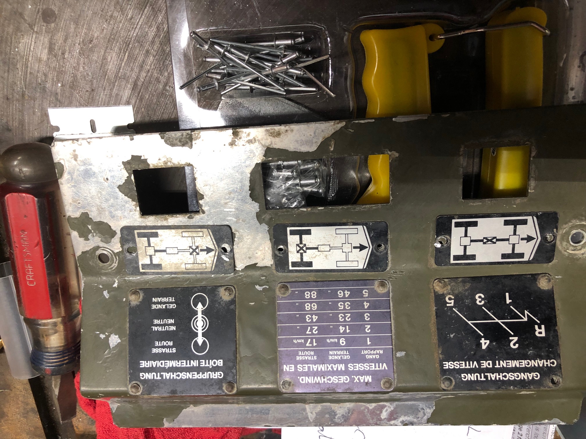

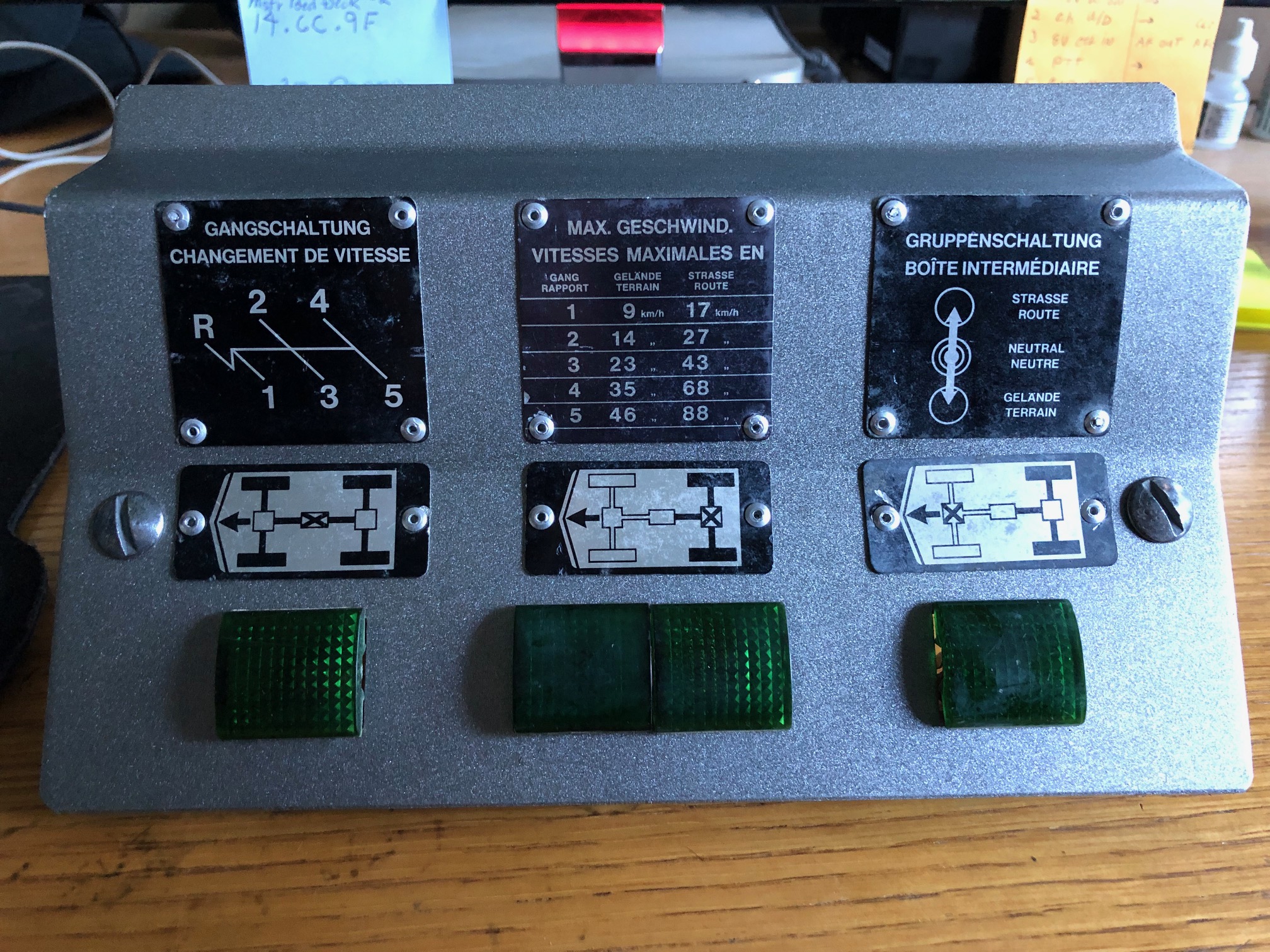

Restored my locker indicator panel for my 712 project.
One in the truck was in bad shape, as below. Thought
this would be a quick fix but as usual there are challenges.
The hardest part was removing the rivets on the data plates :x
These turned out to be steel rivets. What I ended up doing that
worked pretty well was to carefully grind then down flush using
a diamond wheel on a drill press. Then I used a carpenters spring
loaded brass punch to knock them out. Took some patience and
practice.
Stripped old paint off, and applied a Rust-oleum Metallic finish.
Used a HF 3/32" pop rivet which fits perfectly in the old hole but
tight.
More pleasing to the eye now 8)

Thought
Nice job Ron, but the rivets grind off from the back without any problem. :lol:
But now that you're retired, time doesn't matter. :roll: :lol:
Re: Locker indicator panel resturation
Posted: Sat Mar 16, 2019 7:04 pm
by rmel
Yes, I ground these off from the backside.
Although there was one I had to grind the
mushroom off from the front side, it was just
one stubborn rivet.
