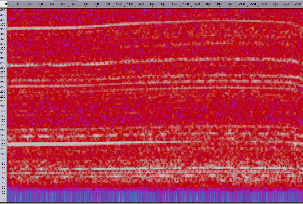

I'm experiencing this in my 710K. At highway speed (62MPH), there is a vibration that comes in and out about every 1.5-2 seconds. I can feel it in my feet more than I can hear it, but I did try to make a recording with a Pixel 2 phone and look at the spectrogram. That puts it at about 135-140Hz. I'd share the recording, but it's just too much in the background to pick out cleanly.
The vibration might have gone away when I powered the front axle, but gear noise increases enough then it was hard to tell for certain, and I don't care for extended driving on hard surfaces with front & rear engaged.
I'm suspecting this harmonic is the result of slight speed differences between front and rear driveshafts, but that's just a guess. Perhaps if one started to mix-and-match tires that would be a test.
Do others experience this, and do we think it's cosmetic or a concern?
My next step is to capture the data with an accelerometer so I can better collect low-frequency data.
