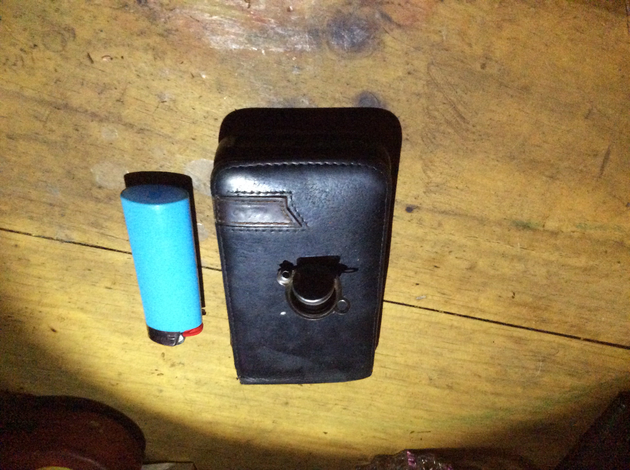

When I first installed LPG on my 712 I had a slight concern about cylinder head temps increasing but these concerns were quickly eased when I could see no difference between petrol and LPG. Not really being concerned about melting the heads on my 712k the metallurgical limits aren’t really something I’ve been factoring in.
I had considered fitting a small temp sensor to each cylinder head with the ability to switch a warning light or .... Bad Pic below but you should get the idea
I decided against this mainly because I couldn’t detect any difference between either fuels (running petrol and LPG, duel fuel). With my red dot temp gun thingy, and because of the reasons you (chickenpinz) stated above being ideal location and having to drill and tap my heads no matter how shallow. If I was flying my 712 I might consider knowing exactly what the engine was doing an important factor if I didn’t like the idea of falling out of the sky but for me keeping an eye on the oil temperatures during different conditions and seeing no drop in oil pressure is good enough for me. If my oil was getting excessively hot I would expect to see a drop in oil pressure, but this has never even looked like happening even on 40*C and above whether.

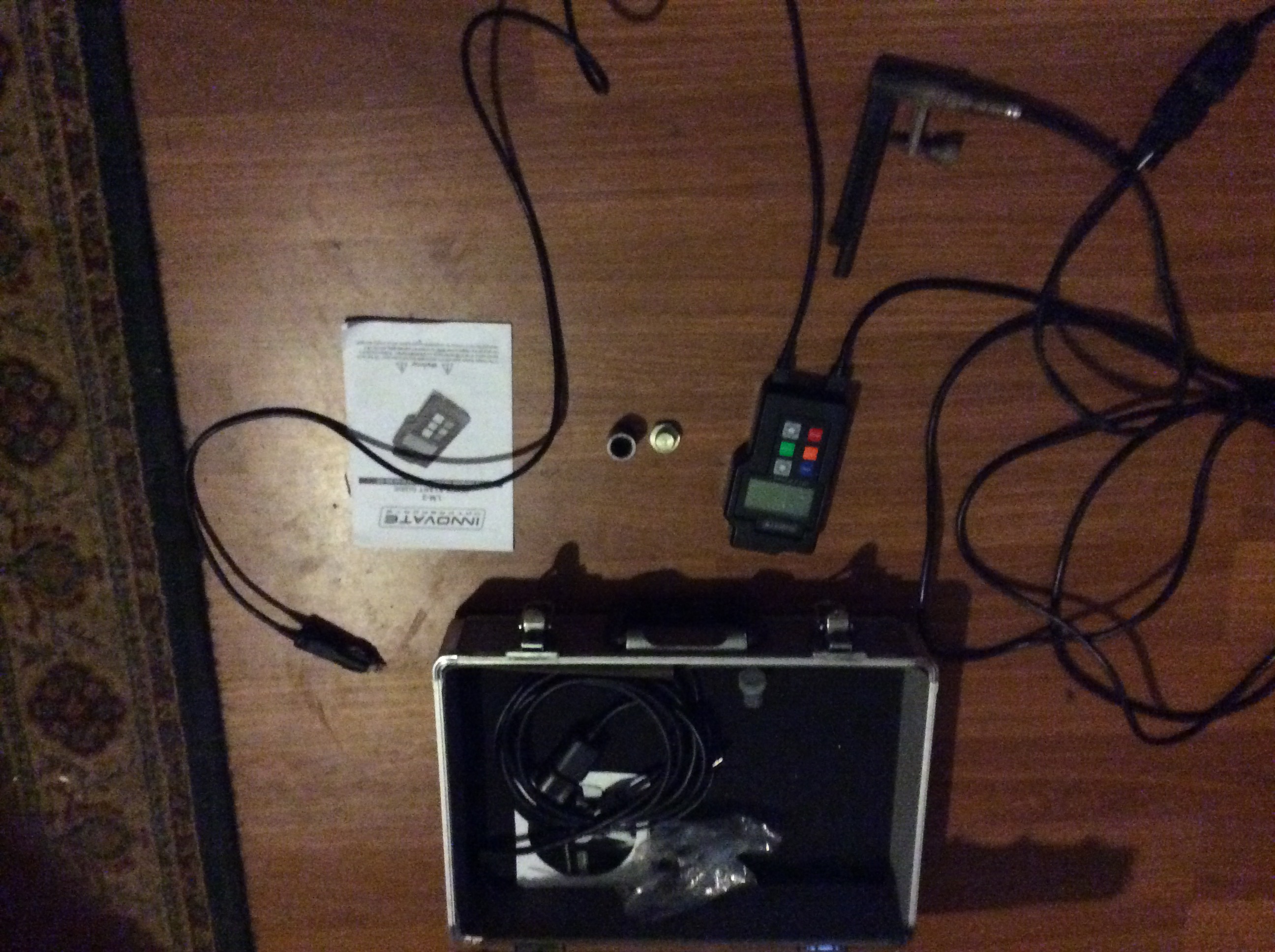

These Innovate exhaust gas readers are great for basic fuel mixture tuning, achieving the desired/correct air fuel ratio (stoichmetric). You can simply clamp the oxygen sensor into the tailpipe for basic mixture setting or re jetting your carbs for altitude etc. They are also great for LPG tuning when used in this manner as well. FYI the black box can be eliminated and a simple dashboard gauge can be used instead for the purpose of keeping an eye on the air/fuel ratio of your cylinders fitted with oxygen sensors. However the black box does have a data logging capability...dashboard clamps are available for this unit which is approximately 100mmx200mm.
You’ll see the stainless bung RMEL spoke of as well, these can be added to one pipe (hottest cyl) as production EFI cars do or use two after first the Y joins (4cyl) . For pinz just before the heat exchanger, or go all out as RMEL has in his 710 and put one on each header close to the cyl heads. I’d consider this overkill unless you were converting to fuel injection or probably still overkill unless you were doing an independent throttle body EFI as designed for the bikemaker 712.
