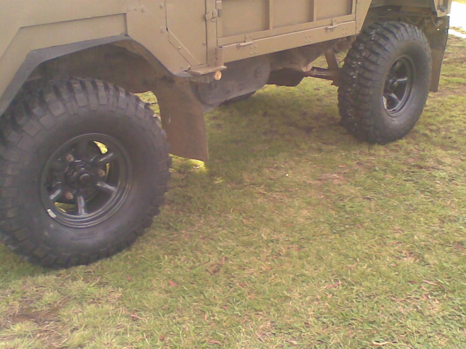

I would be wary about putting 315 wide tyres on less than 8" rims.
I have BFG KO2 MTs 315/75R16 on my LR Forward Control which has 8" wide rims - while they fit OK, they do balloon out a bit - on my vehicle I run 32psi on the highway as it seems the best compromise - offroad down to 10psi with no issues.
So OK with 8" wide rims but less than that may cause issues.
Here is a pic of mine - you can see just a little ballooning on 8" rims.
Garry

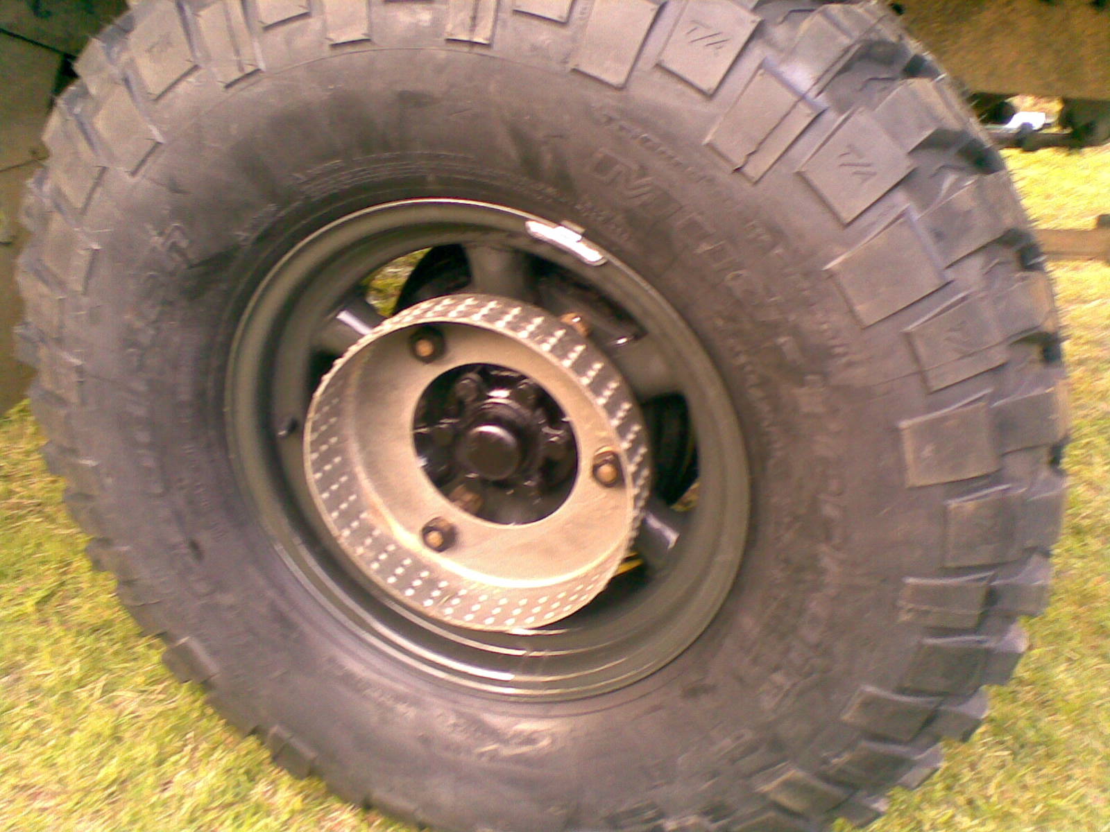

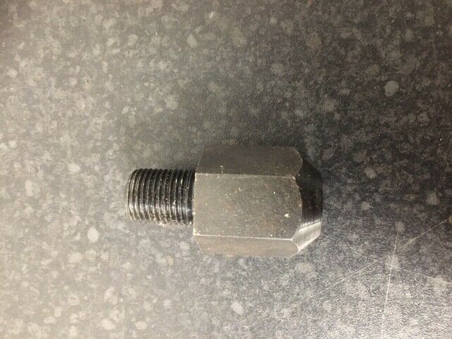

Are you running 3 wheel studs per wheel?
Re: New Tires 315/75r16
Posted: Wed May 27, 2020 8:15 am
by Garrycol
No my wheels run 6 wheels studs per wheel - I guess your comment comes from the fact that in my pic three lug nuts are visible due to their brown colour. On the 101 three of the lugnuts are of a standard style and you cannot see these as the are close to the same colour as the wheel. The wheel step (not shown) uses a different lug nut (three off) that allows the wheel step to be bolted on - these are the three you can see.
Here is a pic with everything in place
Garry
