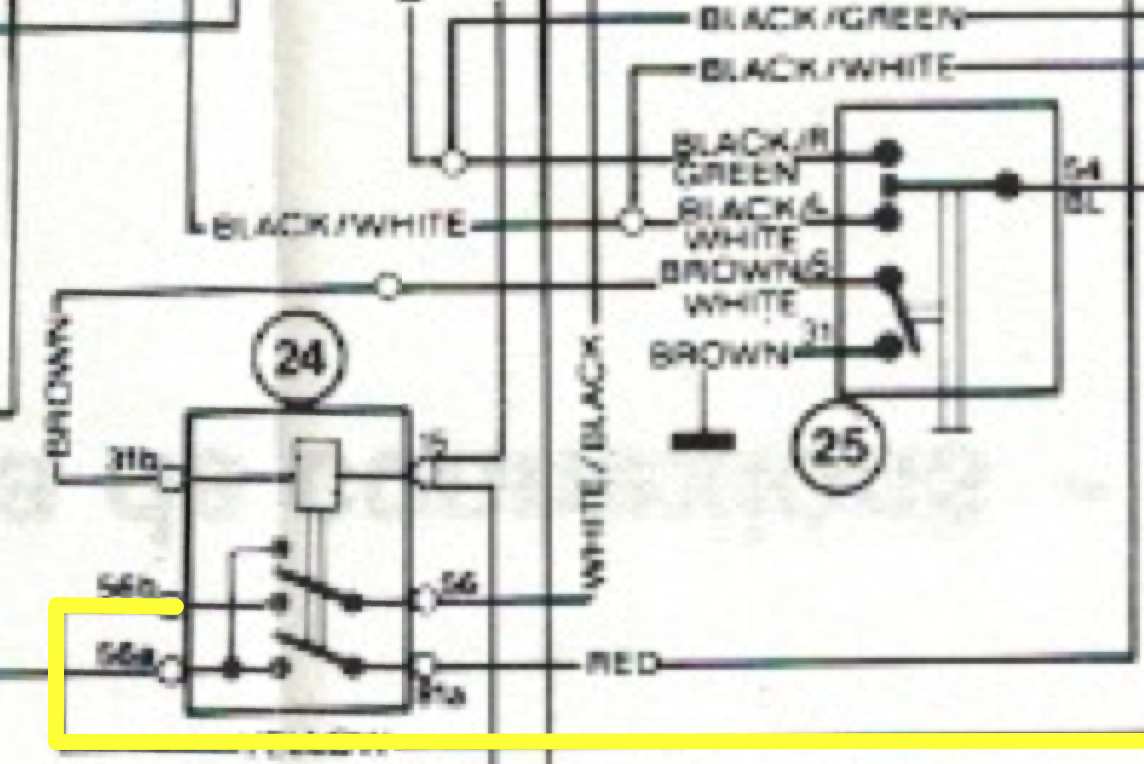

Thanks Ron. Neither headlight works in low or hi. No power at the fuses for the headlights so I was going back to the light switch relay (#24 below). Can someone tell me what that looks like or where exactly I find it?
Also, what is the "Multiple Switch for Turn Signal and Head Lamps" (#25 below). Is that the master switch?

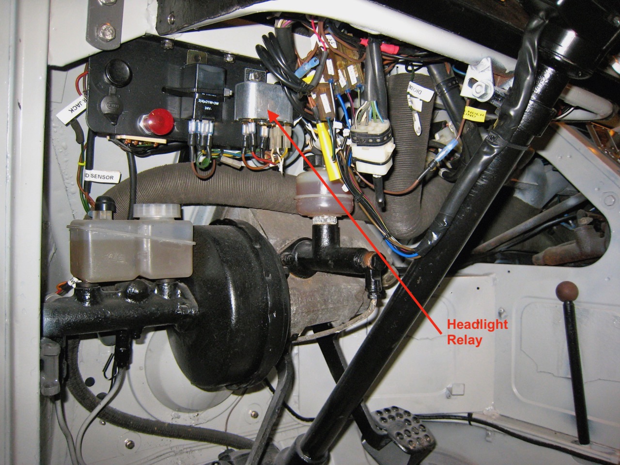

Posts: 1640
Re: Headlights not working on Austrian 712K
The headlight relay on a Swiss Pinz is shown below. I don't imagine the Austrian would be very different.

Thanks. The picture helps a lot. How would I go about testing the relay?

To answer your question. (#25) is the combo turn and high beam switch.
The high beam switch is momentary. A click will trigger the high beam
Relay (#24) ON and a second click will trigger it OFF. It’s a latching relay.
Get a meter on the input terminals #56 and #81a. Again note that #81a
(with the Battery disconnect ON) should always be HOT e.g. 24V present.
I'd be very surprised if that was not the case. Though the connection to
the relay could be loose or oxidized.
Terminal #56 should be Zero Volts, unless the Headlight Switch is ON -- turn
it on now and measure, should see 24V. If you do then you should also see 24V
on the output terminal of the relay #56a -- if you do then everything from
terminal 56a back is good and your problem is a bad connection up to the
breaker block. If no output on #56a then either the connection from #56 is
poor or the rely is bad. At this point try one more thing. Click the high beam
switch, you should hear the relay actuate. If you don't then that's a different
circuit you would need to debug. Could be the relay, high beam switch or a
bad connections. These are some things to try.

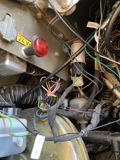

So on my truck it looks like this is a bit more difficult to access. Not sure what this cylinder in but not the relay you pointed out.
There are two components behind the panel. I think this one is the relay. Would you agree?

Posts: 1546
That cylinder device looks like the "blinker".
The apparent relay behind the panel appears to have only 4 terminals?
For the Swiss version of the relay there are 6 terminals. The Austrian version
could be fewer depending on how the harness was changed. Wire colors don't
jive with the Swiss version.
Hard to read out of focus PIX. Can you see the terminal numbers on relay?
The terminal numbering should be the same as again it's a Bosch standard the
rest of industry adopted. Try the high beam switch, do you hear it actuate?
You could sneak a meter probe on the Orange fast-on tab, I'd bet that's 24V,
is it terminal #56?. Switch on the Lights and see if that jumps to 24V.
