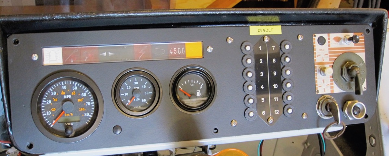

Anyone have a source for adapter plates to allow installation of US standard 2-1/16in gauges into the 60mm holes for the two smaller of the dashboard gauges? Looking to replace the hourmeter with a tachometer. Seem to be plenty of options in 2-1/16in that are 0-5,000 RPM.
And yes, I can make them if I need to, but it'd be easier to buy something already made.

The VDO 6000rpm Tach Kit that Swiss Army Vehicles offers includes the hole adapter and the 24 volt to 12 volt resistor for a quick and easy installation.

I read a lot of gripes about that VDO tach in the Pinz forums, but it is on my short list.
I'm still looking for one that includes an hour meter, but no luck so far in that smaller (2-1/16 or 2-/38) size.
Long term: I'm building an engine monitor and may use one of those gauge sites for a round graphical display. The challenge is to make it fit the character of the vehicle as I'm trying to stay as stock looking as possible.

Yes, there were some scattered issues with the VDO tachs. I've installed 4 of them and had problems with one. On that one I switched to shielded wire for the signal wire to the coil and that solved the problem of the jumping/inconsistent readings.
I imagine you've seen the SpeedHut gauges (https://www.speedhut.com). Perhaps they can fab something to your liking.

Thanks for that link on SpeedHut -- definitely some good options there! I'm going to reach out to them to see about 24V operation and the chances of a 5,000 RPM dial face.
