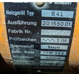

Looking for help debugging my behind-the-driver-set heater issues.
Pulling out the dash switch to the first detent, the fan starts running. That seems correct.
Pulling out the switch to the second detect, the fan stops slows to a stop and I hear 4-5 click/tick sounds from what seems like under the floor near the doghouse. The position of the control knob on the heater makes no difference. Test was run with the engine/ignition off.
Ideas of next steps in the debug process? Is there a good troubleshooting guide (AKA better than what's in the operator's manual)?

There is no apparent reset switch on this model that I can find.
When the switch is pulled out to the second position, all things slow to a halt (silence) and the dash light goes out.
Ideas?

mine works like this:
Pull switch to 1st position- light on dash comes on and fan runs.
Pull switch to 2nd position - light on dash goes OUT, fuel pump starts pumping to pressure level (the pulsating clicks you hear) and the igniter is powered.
When the heater fires up, the light on the dash turns BACK on ( mine takes about 10 seconds once pulled into 2nd position when its cold).
if at anytime after that you push the switch to close, the heater shuts off but the light on dash and the fan stay on until the unit cools off.
The light and fan will continue to run after the heater fires up and you close the switch to shut it off....even if you turn off the battery disconnect (it is wired that way to allow it to cool down regardless).
I had issues with mine firing up until I replaced the fuel pump and some of the lines. The old pump would sporadically click(pump) but the heater wouldn't start.

I had problems until the gas line was replaced. You could hear the small pump tick away in the rf wheel well. Behind the shield in the wheel well the old line had become porous and allowed air in, making the suction pump suck air instead of fuel. Not porous enough to show any fuel leak. Most common problem with these heaters.
Once the line was replaced the heater works great. Apparently this is a common problem.

In my case, when I pull the dash control out to the second detect, the fans shut down and I just hear a few bits of ticking sound before silence, which I presume that is its fuel pump. Would I expect the heater's fans to shut down with a fuel pump and/or line issue?
