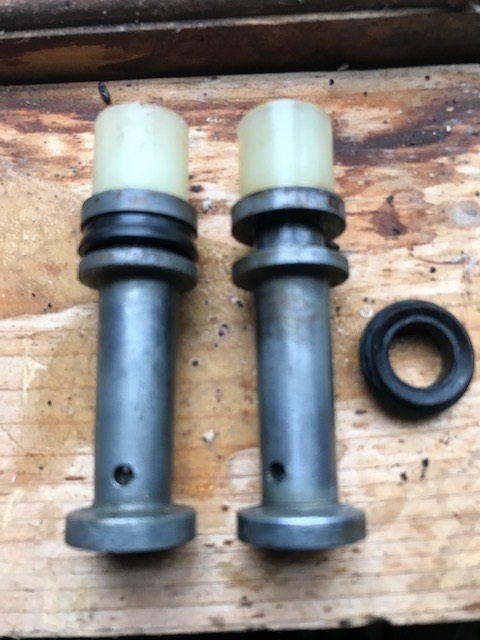

Rebuilding my hydraulic masters. I got the rebuild kits, But I'm not sure about one of the seals (grooved cup),
Do I need a special tool or does the white cup remove somehow? unscrew / just pull out- I don't want to try and force something that is not intended to move. I tried stretching the seal over the end, but even warmed up, I can't see it making it.

Well the cup does pull off with a little prying with a razor knife- I was able to muscle the seal over the end. Really tight though - my arthritic thumbs will be reminding about the job for a week.

I ended up using a screwdriver to push the cylinder out using a mallet. I had to remove the banjo bolts in order to do this. It will ruin the metal end piece but if you are planning to rebuild it as I did you will replace it anyway. I don't think it ruined anything and less messy than grease option.
I used vise grips to remove the white caps. Get a good grip, twist and pull. Left a little indent on it but dont think it will affect function.
