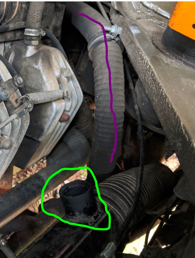

My 710K doesn't have this hose, and the port on the heater box (bottom of image) appears to be blocked off. Did some vehicles not get this hose or is mine missing something it should have?

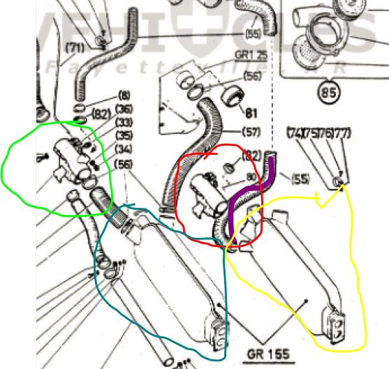

My guess is that this vehicle has a new heat exchange, and now gets the warmed air directly from that rather than a side-tap of what goes to the passengers. Does that sound correct, that vehicles came with different versions of the heat exchanger (GR 155), as suggested by the exploded view drawing?

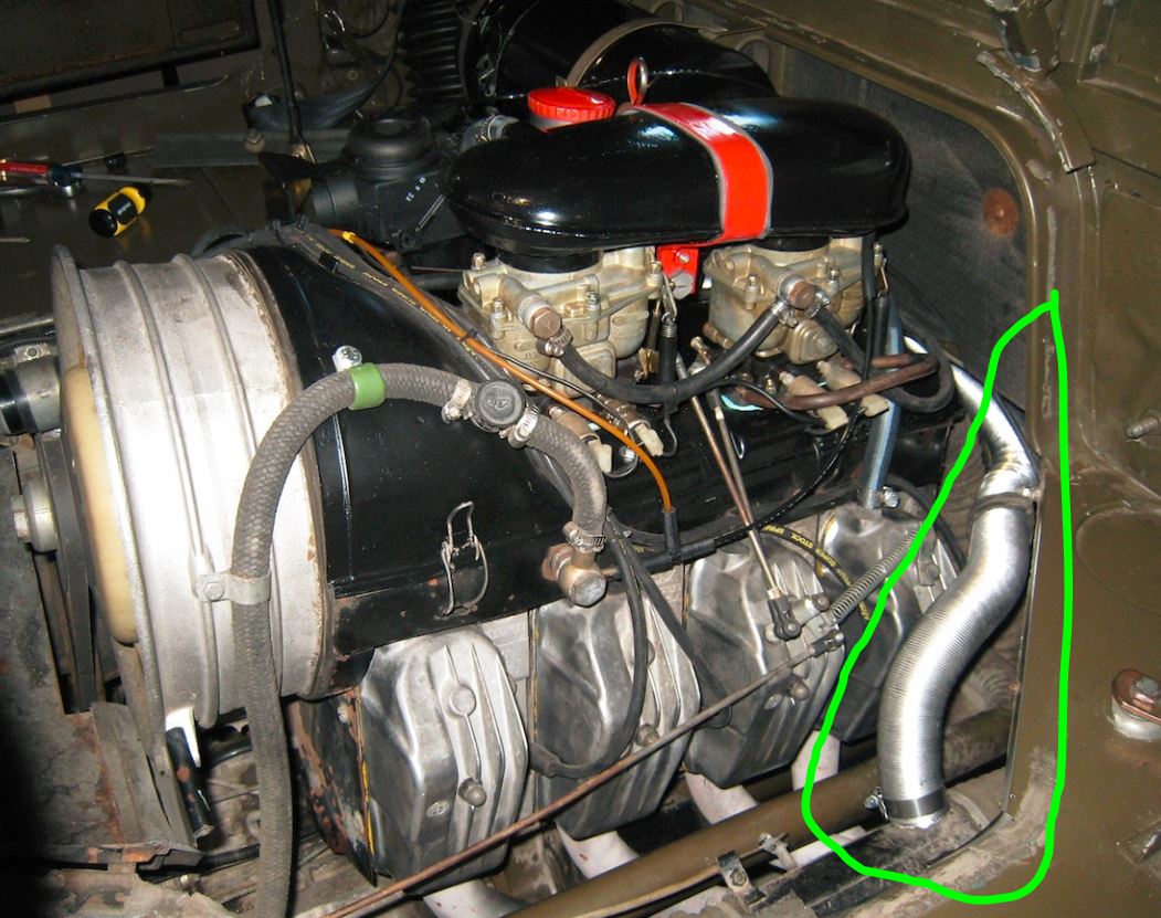

The first photo of the engine is a photo I posted on another thread of the engine in one of my other Pinz's. It did indeed have the thermostatically controlled warm air intake for the carbs. I installed that Styer factory revision and the new hose. Here in Wisconsin the improvement was noticeable during the winter. The carbs also had the appropriate choke plate (#2) and jetting for the northern climates. The tropical choke plate (#6) worked best for the southern US.

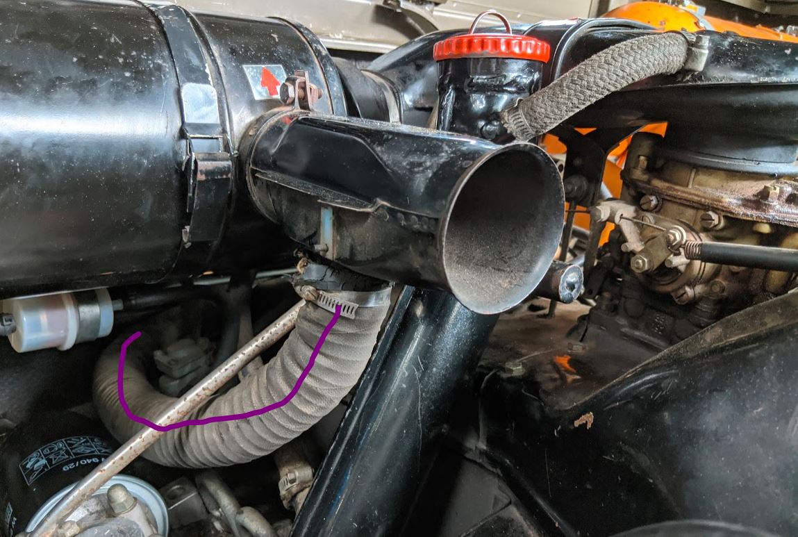

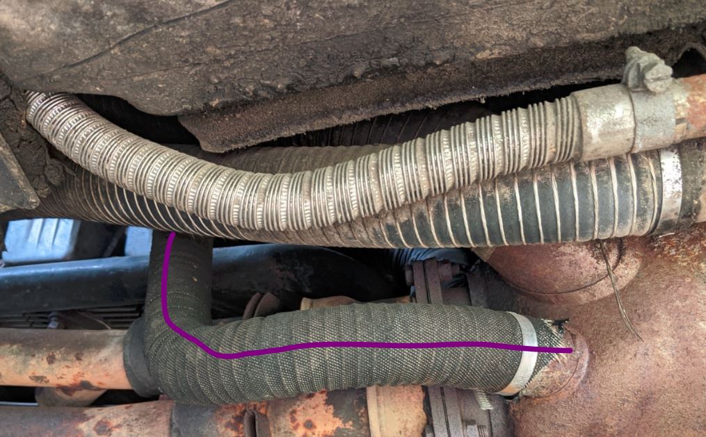

As noted, on mine the lower intake opening on the air intake housing goes to the heat exchanger port as pictured.
My question is, again, why there is what appears to be an unused port (circled in green) on the heater valve box that is now blocked closed?
The air intake is connected to the heat exchanger (as pictured) through the hose marked with purple. It seems like a vehicle would be either:
- ported heater valve box (what I have, green circle) + heat exchanger without engine intake air port (teal, not what I have)
*OR*
- unported heater valve box (not what I have, red circle) and the heat exchanger with the air intake port (yellow, what I have)
but not mix of both.
That's what I'm trying to figure out as the combination seems unexpected since there are heater valve boxes without the engine intake air ports.

Hard to say why they (Styer) would have assembled yours the way that they did. I think you are correct that it should be one or the other. I've had five 710M's and all had the valve box and the 2 -hole HE. Not that that indicates anything. Perhaps during assembly of your particular unit they were out of 2 hole heat exchangers so subbed the 3 hole? Or out of the correct valve box?
