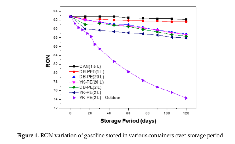

The chart below shows a study done in S.Korea using a well sealed Steel container
as the baseline versus a number of plastic containers. They use the RON system in
SK so 93 Octane is equivalent to our 91. I have read articles where lower Octane
gas degrades faster e.g. regular, but I could not find any data to show how much faster.
ChickenPinz
Posts: 435
Re: Gasoline stabilizer??
Post by ChickenPinz »
...and that's why I always fill my jerry cans with premium (91) octane fuel.
