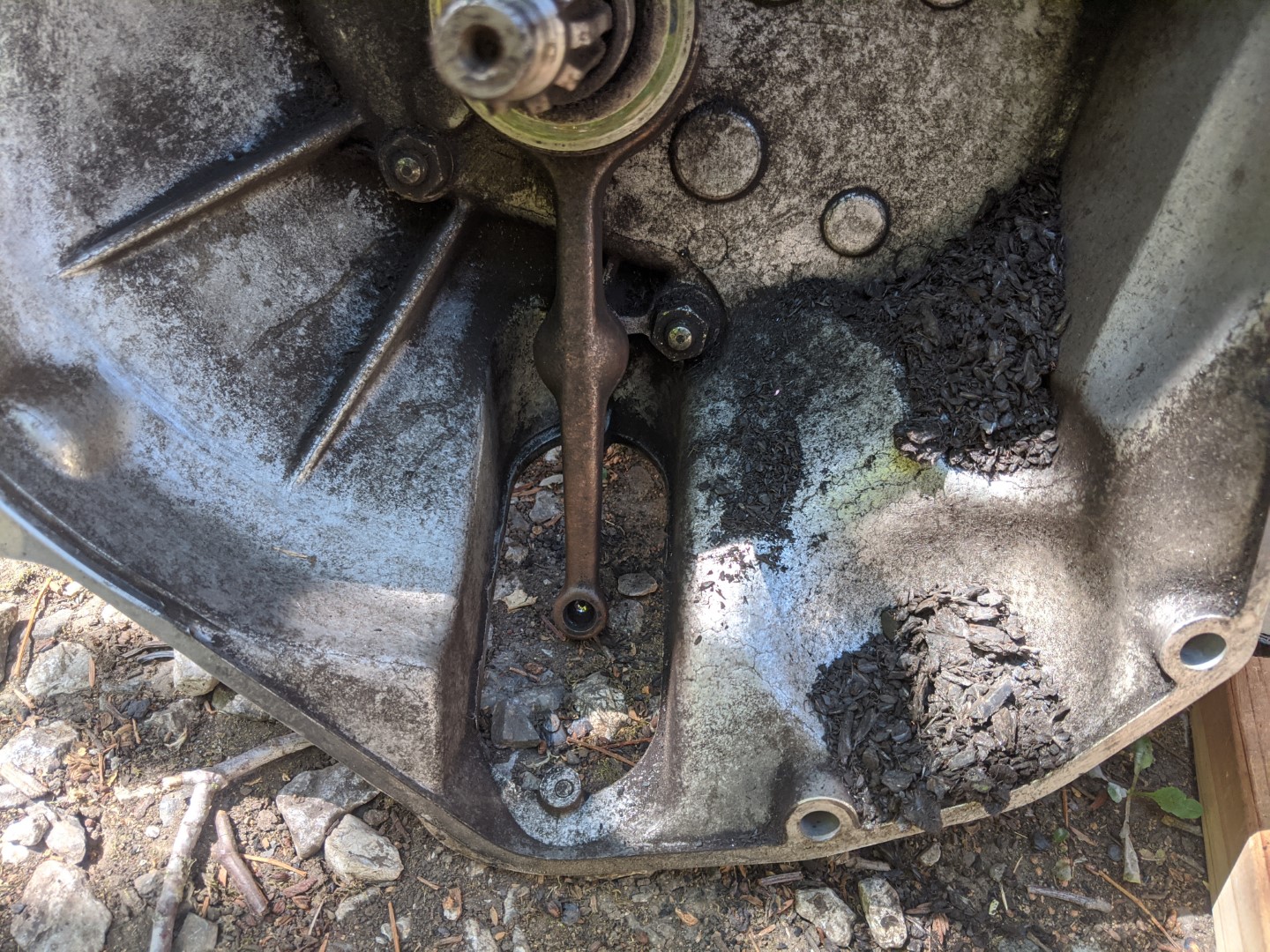

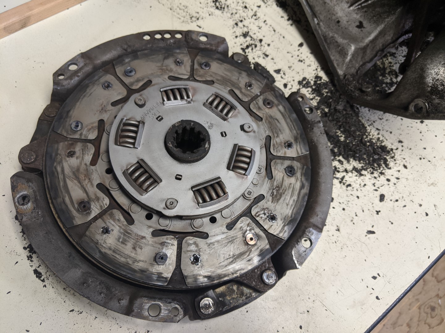

After pulling the transmission, the failure was obvious and as expected: clutch disc disintegration.
The whole pressure-plate side of the clutch disc was without friction material. Minimal injury to the pressure plate, but I am replacing all the standard parts (disc, cover, bolts, throw-out bearing) regardless.
Oh, and the drain/inspection hole on the bottom of the bell-housing? It's 5.0mm diameter.
For anyone wanting to diagnose this failure in the field, symptoms are:
- No, or minimal, power through the clutch
- Clutch worked fine not more than six cycles previous
- Good pedal pressure
Removing the inspection cover on the top right of the bell-housing for the ball-and-socket slave cylinder connection, and running the engine briefly resulted in a scattering of clutch disc detritus on the ground -- that'd be an easy confirmation in the field of this type of failure.

Since there is not much warning, is there a way to check how much wear on the clutch friction disk before this happens on the trail or road? Would a borescope through the inspection hole or slave cylinder hole show this before it fails?
Re: Clutch failure on trail. Need help.
Posted: Fri Jul 03, 2020 1:34 am
by ChickenPinz
I don't think the drain hole on the underside is going to help much. It's only 5mm and likely very little clearance on the inside. Your best inspection point is to remove the two nuts over the slave cylinder ball-and-socket joint.
All that being said, it wasn't particularly obvious that the failure had occurred on my truck even after half the disc had disintegrated. You might be able to stick a borescope in there, but it's not clear that there would have been any visual warning signs.
The transmission was just out within the last 100 miles or so, and both Jim and Andre saw it and neither saw anything that looked wrong at that time. My take from that is: There are no visual early warning signs. And there was no hard use of the clutch anytime from when Jim/Andre saw it until it failed. Oh, and the truck has about 50,000km/1500hr on it.
All that being said, if you're really worried about a failure on the trail, you could bring a spare disc since a clutch swap is 100% doable in the middle of nowhere with just the on-board toolkit. Me? I'll just make sure I'm with pals who could leave me some water and whiskey while they drive back to civilization to return with a new clutch.
