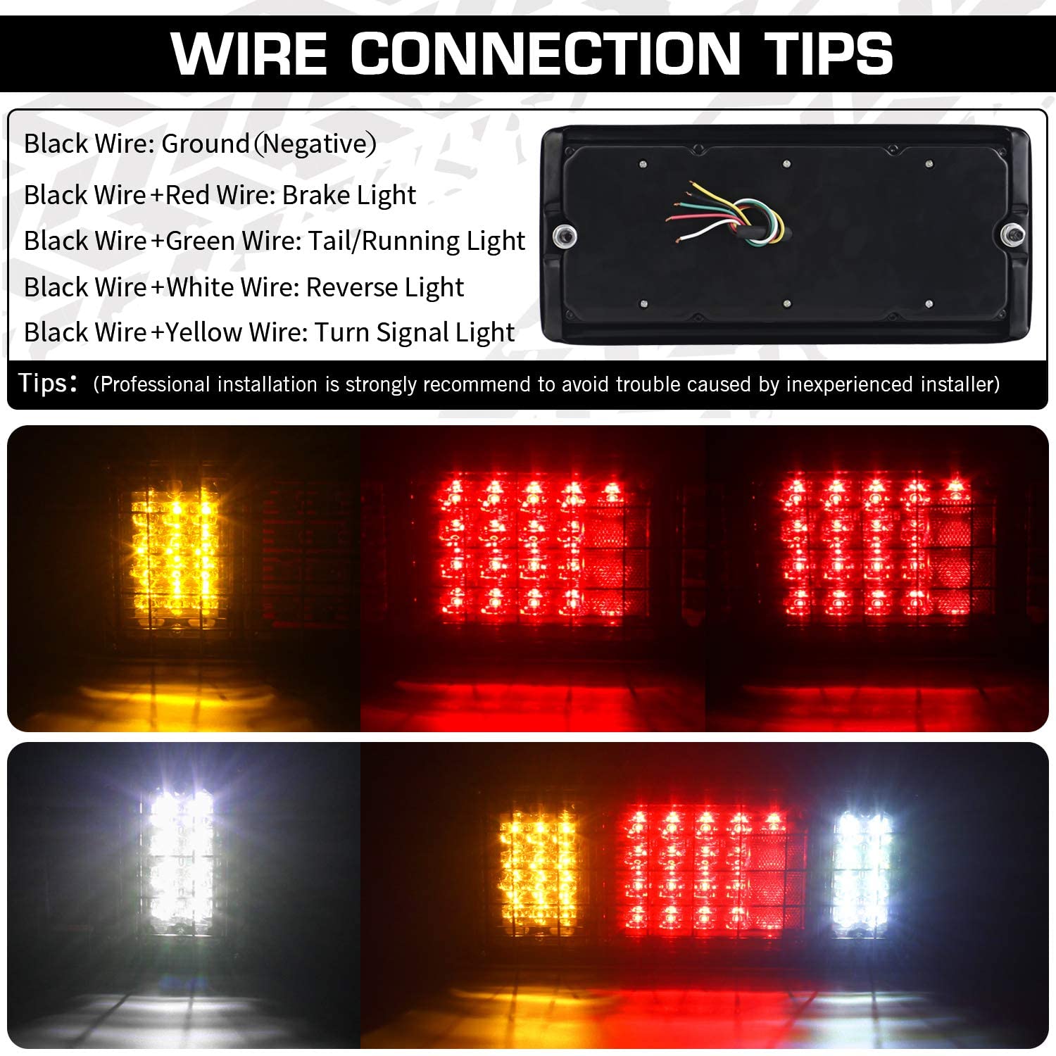

And lastly I need to work on my lights. I am thinking of buying a rear lens kit that is 24V LED and it has Amber, Red and White for backup. It has a five wire connection and I was wondering if this will work with the Pinz?

Besides Austrian Pinzes having fuses vs circuit breakers in the Swiss, the tail lamp setup is totally different in that the Swiss used tail lamps and combined turn/brake indicators ( also for the trailer socket). The Austrian use independent bulbs for each function (tail, turn, stop) and the trailer socket the same requiring 5 wires.
