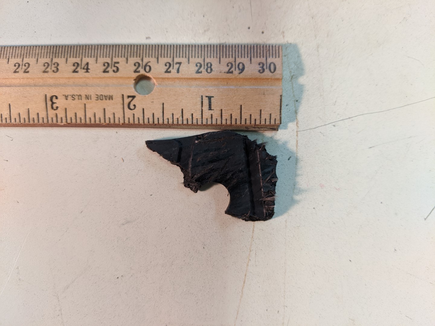

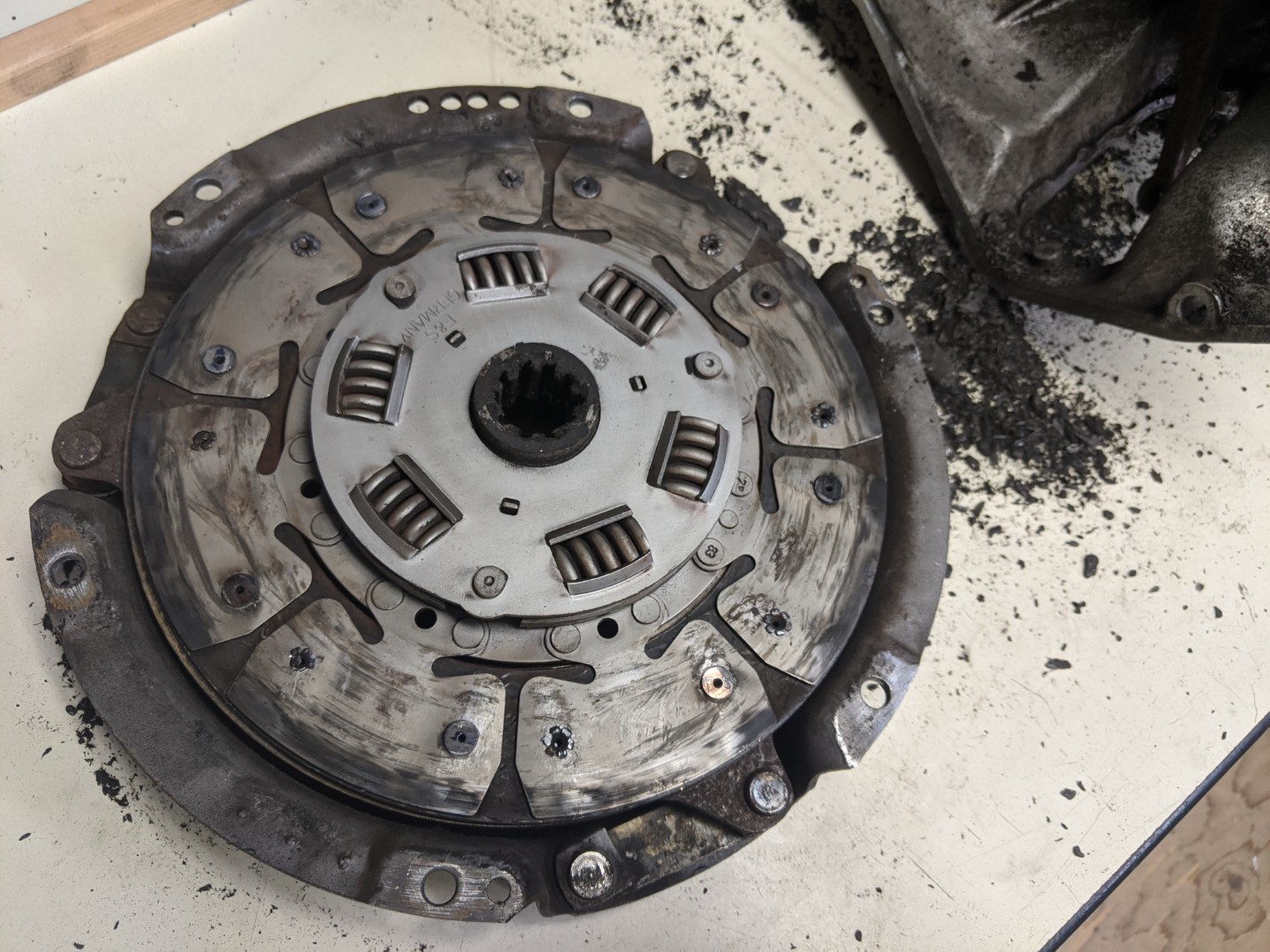

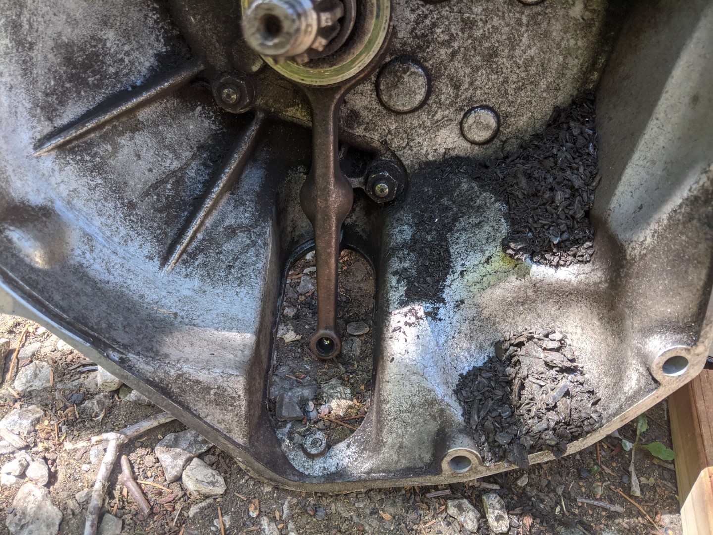

This is a survey to find out about member clutch failures, and their likely causes. It's inspired by my recent clutch failure, which mimics another's failure less than a week later which had the same combination of events: original 40yo clutch + overspeed. My goal is to understand if the overspeed failure only occurs on old (or original) clutch discs, or has been known to happen on new clutches as well.
The two clutch failure cases I know of so far are 40yo clutch + overspeed.
Please weigh in on any clutch failures you've experienced. Include the age of the disc as well as the operating conditions that might have led to its demise.
