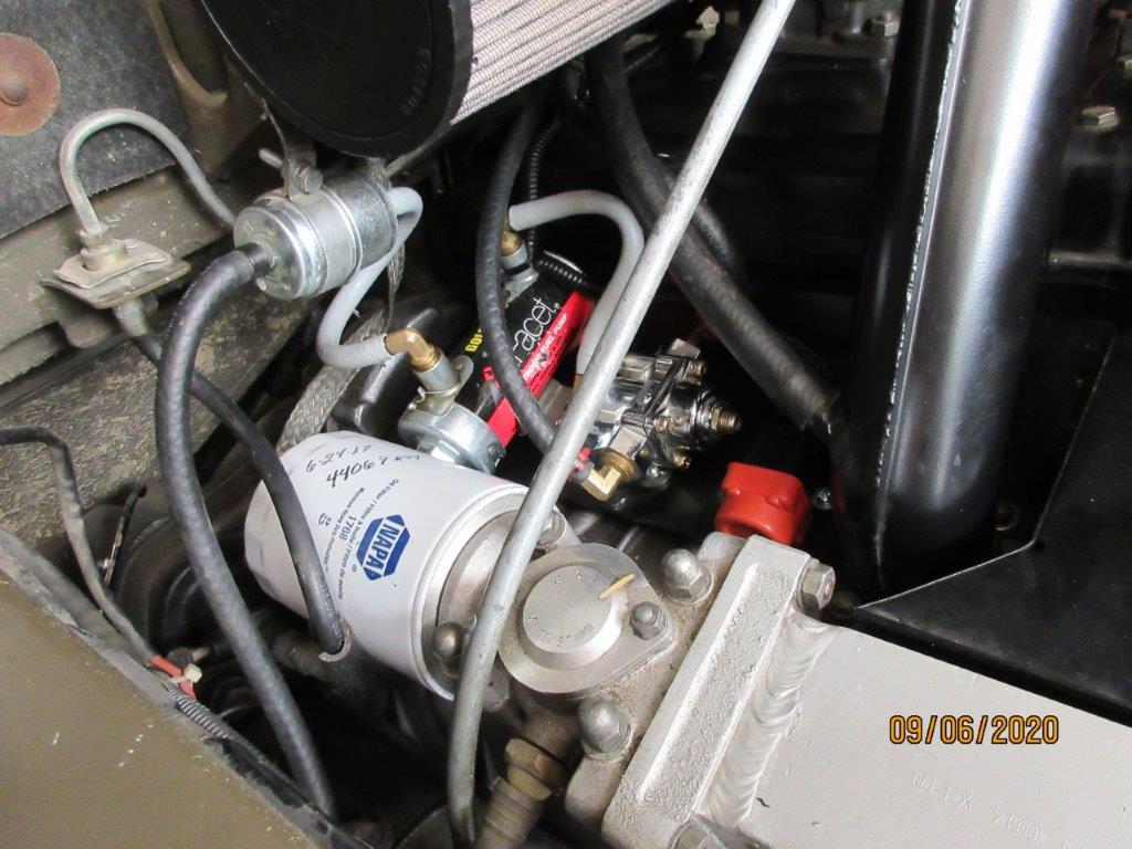

The Pinzgauer Fuel Delivery System is now available to buy. This kit comes completely assembled and ready to bolt in where your current mechanical fuel pump is located. This isn't just a fuel pump, as it also includes an adjustable pressure regulator and inertia switch. With the free pressure gauge you can dial in the recommended fuel pressure in only minutes. All hardware, hoses, and fittings are included. Installation takes an hour.
With this system you don't have to crank the engine to build up fuel pressure. Just turn on the key and listen for the pump to slow down, then crank for quicker and easier starts. Most Pinzgauer owners have no idea what kind of pressure their outdated mechanical pump is producing, this delivery system gives perfect results every time. It runs on 24 volts, which picks up the feed at a fuel stop solenoid. Each carburetor has its own fuel line.
I have had this system on my Pinzgauer for 7 years without a bit of trouble. Order yours today for $435 delivered within the USA. Sorry, no International sales at this time due to shipping problems. PM me for purchase details and questions.
Note- the fuel pump and pressure regulator are transposed in the engine photo. Our engineering department moved the pump to the middle position for better clearance and easier installation. The inertia switch opens the power feed on impact, not when submerged.

I am giving this FDS kit a try (guinea pig mode here) and had a couple of questions that the directions don't cover. Sent a PM to Rick but he's apparently not near email.
1. Looking at the mounting area, it there the pump's tappet guide. I am presuming you leave this in place and mount the plate on top of it with the gasket underneath?
2. Next to the oil filter is a machined piece of the block that sticks up proud of the tappet guide. I am not far enough into the install yet, but it looks like it might to potentially interfere with the mounting plate sitting flat on the tappet guide in #1? If this "protrusion is not a on every Pinz then I need to modify the PinzFDS plate to fit around it and get the plate flat (and to seal the old tappet guide mount). This machined part on my Pinz seems to sit higher, or looks that way, in the photos on others I have found.
3. My existing fuel pump is mounted on studs (presumably everyone's is), the kit supplies bolts to replace the studs. Any issues with just mounting the new plate on the existing studs? I'd prefer not to have to monkey with pulling studs that could well be loctited in, but will see if they back out easily using the jamb nut technique. They didn't budge.
4. The kit includes a new generic fuel filter and instructions on using it. The photos above show connection to the old fuel filter and mine has a filter just as the pics show in this thread. Why the need for a new fuel filter? I didn't and used the Pinz filter as in the photo above.
5. Getting traction on removing the motor lift bracket nuts (removing the lift bracket is a requirement for the install) is a challenge. You'll a very thin walled box or 1/4 drive socket for them (1/2" or 13mm) particularly the one by the oil filler neck. Although the kit suggests an hour install, pulling this bracket easily consumed that (and hunting for tools that could get in the spot). Yep, I am really slow.
Thanks for any info.

Talked to Rick over the weekend and finished the install. Ground the mounting slightly to fit the unit on the existing mechanical pump studs and adjusted the regulator to about 2.5psi. The hardest part of the install was getting the motor lift bracket off, but even that was not difficult if you had thin sockets or a 1/4" set to crack them loose.
Now it seems a shame to let the Pinz sit for a few weeks to let the fuel dry out to give it a start-from-stored test.
One point for update, mine kit came with a 100psi gauge for measuring fuel pump pressure, which is unusable for measuring < 3psi. This gauge was not even off the peg with that pressure. You need a 5psi gauge or possibly a 15psi gauge to set the regulator to somewhere between 2 and 3psi. You can get the right gauge around $10-$15 on amazon and elsewhere. This regulator can be adjusted between 1psi and 4psi max, so dialing the adjuster counter-clockwise about half the way puts you in the ballpark.
This is the gauge you want https://www.amazon.com/gp/product/B07ZGH24JQ and there is a 5psi version of it, but might be out of stock as I got the last one.
